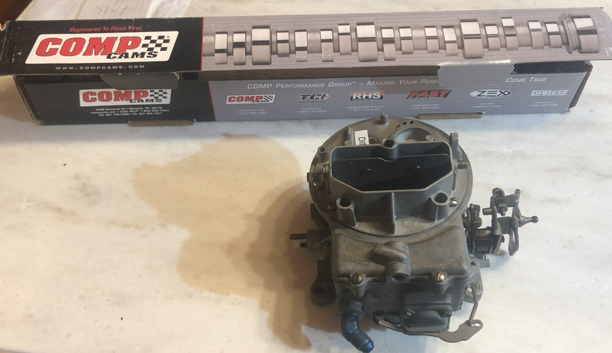

Got a Christmas present just before Christmas!! Stocker carb and cam just showed up from the US!
I guess I should wrap it...LOL!
