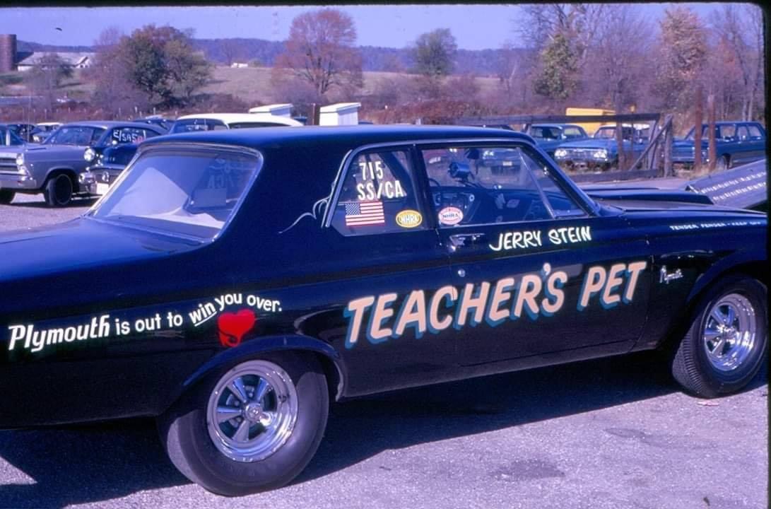

https://www.jalopyjournal.com/forum/...3-jpg.6190171/
Cool build Tom with a lot of history!
Ironically, I found this image on the H.A.M.B. a couple of days ago!
Billy Nees 1188 STK, SS
Old 09-27-2024, 03:59 PM   #3
Tom Goldman
Tom Goldman's Avatar
Join Date: Jan 2003
Location: Allentown,PA
Posts: 2,478
Likes: 894
Liked 886 Times in 238 Posts
Default Re: Max Wedge Resurrection
WOW ,thats a great picture !
The remnants of those big tow bar plates are still on the car !
