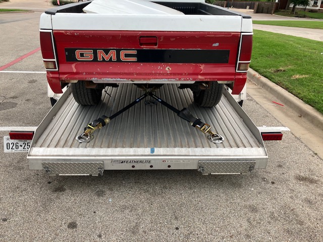

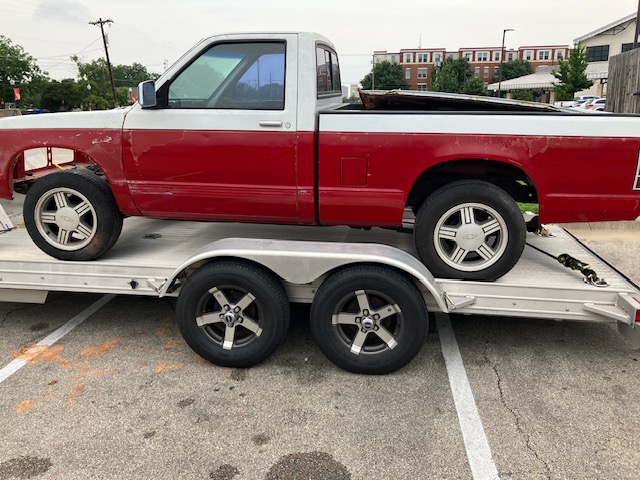

It begins
ID:	71378   Click image for larger version
ID:	71379   Click image for larger version

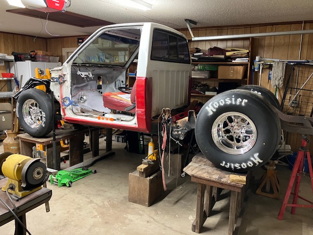

It begins
What wheels are you using?

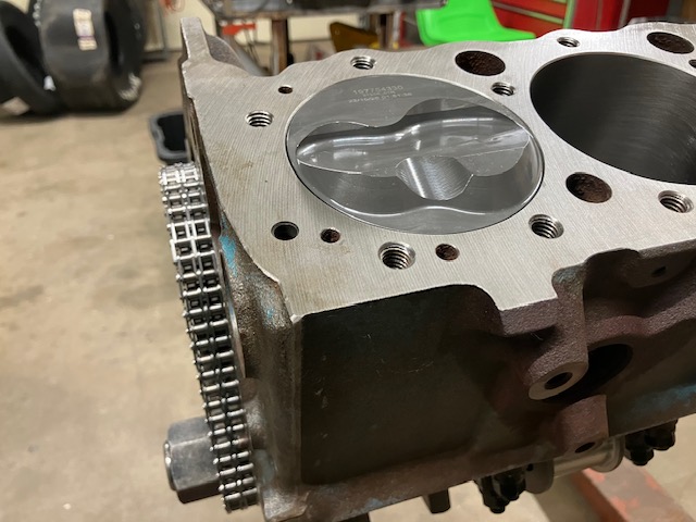

the core
ID:	71387   Click image for larger version

Mark,
The wheels are Billet Specialties Winlite. I like them, they are very well done, look great. I like shiny parts

Mark, 15 x 4 front and 15 x 14 rear. And off all things, the center cap is machined on the wheel, all one piece, non-removable.

Mark, you will notice the rear housing has overlength tubes. This allows you to cut and fit the wheel/tire package exactly where you want it in the chassis. The rear wheels are 4.5 back spacing.

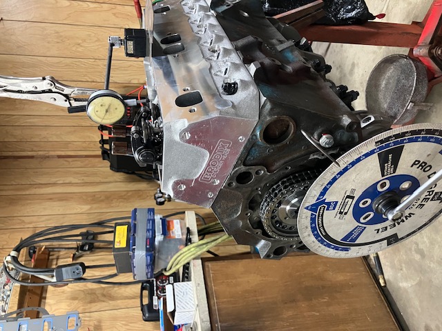

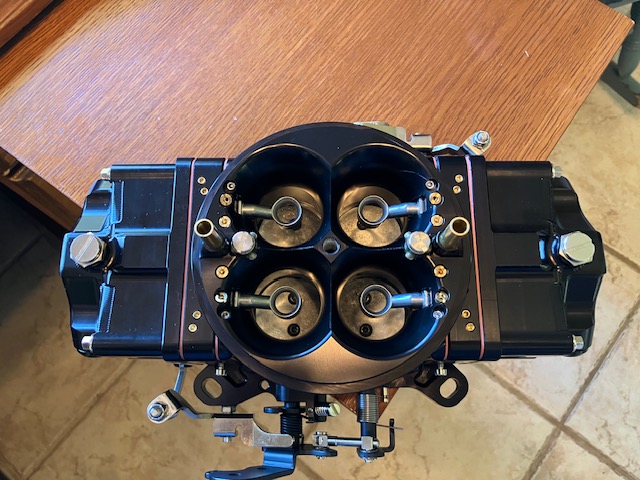

I will move around from one area to another. About 85% of the parts needed to complete the projects are on hand.
*Setting cam timing
*Checking valve to piston clearance
*Over the years, I have tested many carbs. One company that consistently provides good service and results is APD. The Square 10 will carry a complete APD methanol system.
*High compression is my friend.
*This is the first time posting about my experimental 2/16 offset stud.
