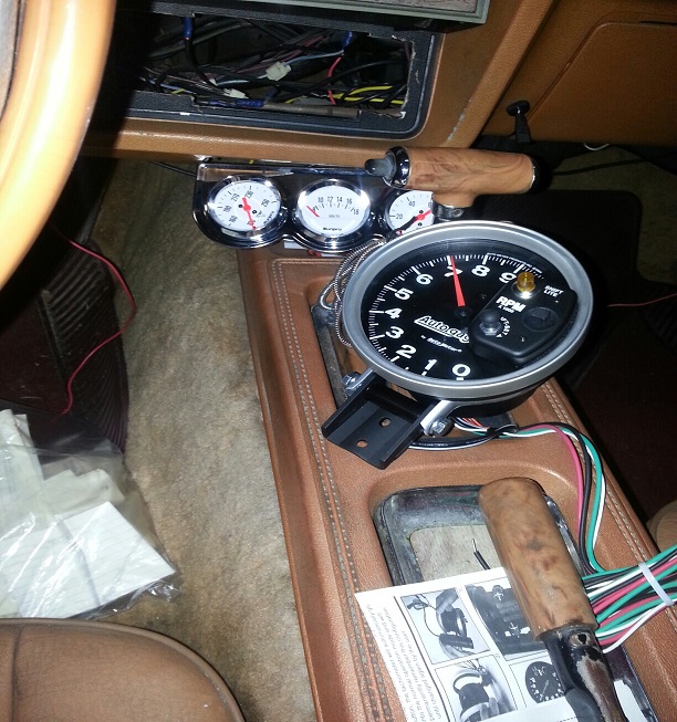

We also got out our tach and gages. Not really good stuff but adequate for the moment. Found the gauge set at a swap meet in Indianapolis in March. Tod found the tach at a speed shop down south on their clearance shelf. Just need to figure out the spot for placement and fab up some brackets.
