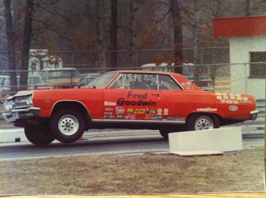

nice score on the rear end Charlie! what color is the car? on the first pictures it looked burgundy now it looks orange after it was rubbed out, that's awesome looking, I had Herb kutz's 65 SS/MA orange malibu for years, so the 65 malibus are a big favorite of mine,

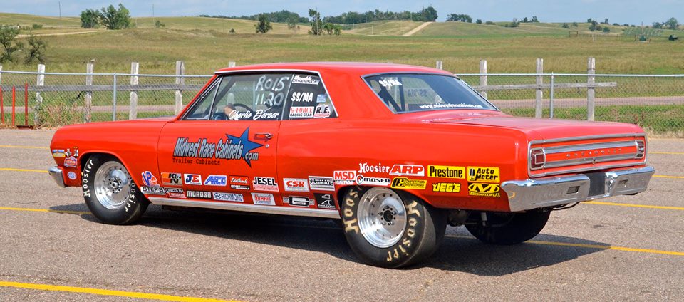

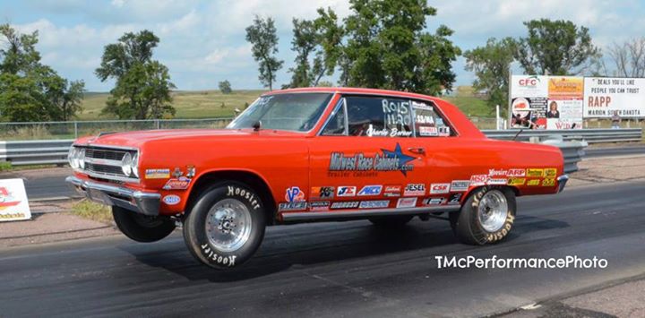

Name:	65 thunder valley.jpg
ID:	23152   Click image for larger version
