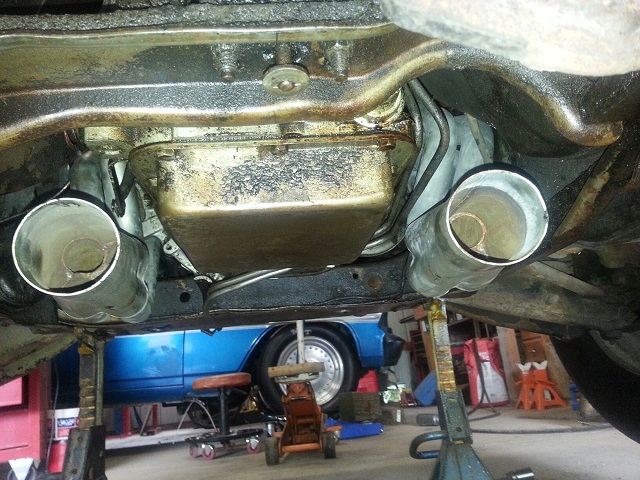

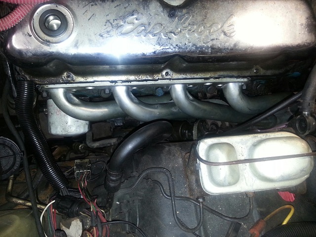

Well spent today (Saturday) working on the Mustang II. After unbolting the R&P, that released the steering shaft. Once that was accomplished, the driver side header, pretty much slid into place. Only have them mocked up for now. Wanted to see if I had any clearance issues. Only current problem I see are the lines to the transmission cooler. John Pressing, if you read this, the headers fit great.
I've also measured out where the driveshaft loop needs to go. As well, I mocked up one of the universal traction bars. Looking at these, they just might work with minimal modifications. Originally, I had planned to cut the brackets off and weld them to another set of spring pads. I may be able to weld a couple of bars onto the bottom of these to make them adhere to the present spring pads. In addition use Billy Nees suggestion to clamp the springs. Just might have a workable combination here.
I have a laundry list of things to do to this car. I'd like to think I made some progress, in truth feel I've only created more work, LOL!

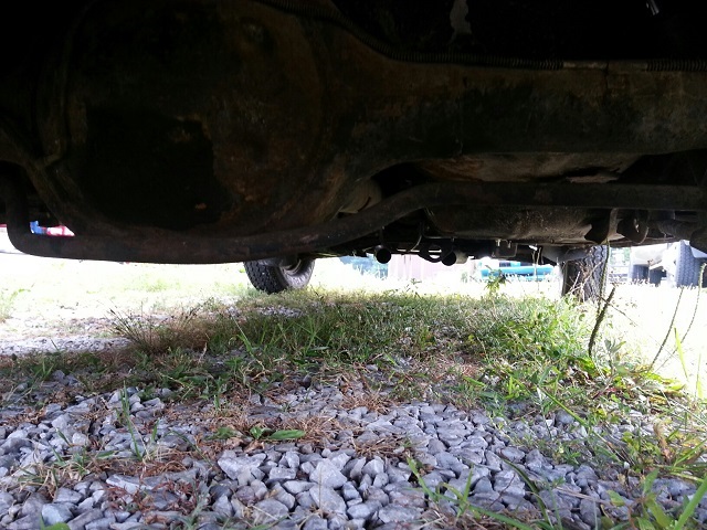

It's been awhile since any real progress on the Mustang II has yielded any results. Finally something to report. We're not ready to race the thing yet, not by a long shot. It is getting close enough to maybe, get it to a track before long.
Finally got the new rear under the car. Upon taking it apart, the rear brakes were trashed. The shoes were eaten down to the rivets. Both drums had nasty grooves dug into them. A trip to the parts store and new shoes, drums and a hardware kit were purchased. It's been at least 5 years since I've done a set of drum brakes. I had forgotten how enjoyable it is to do them (snark intended)! My one screw up, I got the shoes reversed on one side, couldn't get the drum on. Thankfully, we only tore down one side at a time, after looking at the opposite side, saw the problem, lol.
After finishing the brakes. New studs were installed in the axles. When we installed the rear, it pushed one of the studs in, had to pry it back out and reseat the stud. Only got a couple smashed fingers and a blood blister to show for this. Rear end is in place and new wheel studs installed. Just going to use the stock axles for now. After we get the car sorted out, I'm going to get a good set of axles.

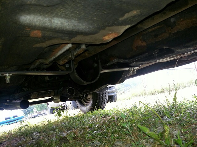

Then we removed the front seats and installed the driveshaft loop. I think that was the easiest part of the whole day.

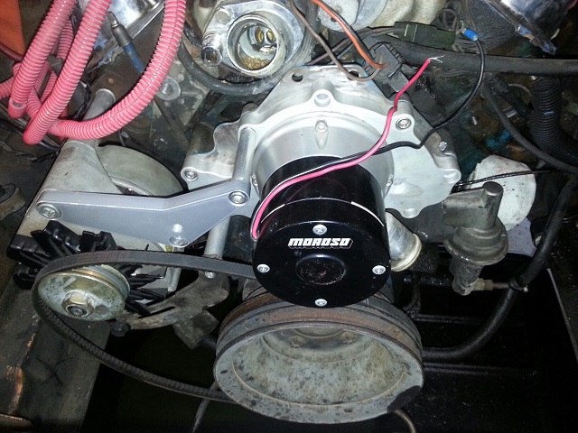

Spent today getting some things done to the Mustang II. We removed the old water pump. Took off the PS pump and all the old brackets. Boy, that cleared up some space. Gonna flush out and clean up the radiator. Reroute the transmission cooler lines and add an exterior trans cooler. For the time being removed and looped the PS lines to the steering box together. Poor mans manual steering. Eventually I'll get a manual rack and change it out.
For now we only have the water pump mocked up. Need to work on some different spacers. Figure out some belt length. Had to scavenge a backing plate from an old water pump and made a couple simple modifications to it. Not happy about having the car down. Not everything goes together as simply as I'd like.
