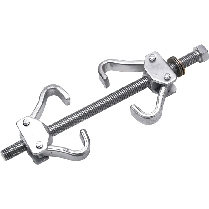

I have one of these, made a flat plate on the hex end, and went up thru the bottom of the control arm,hooking the upper hooks on the spring.
Yep, that's mine. I removed two of the hooks to make it fit in the spring and reconnected them inside it to finish the job. Lots of painful short radius wrench work.
