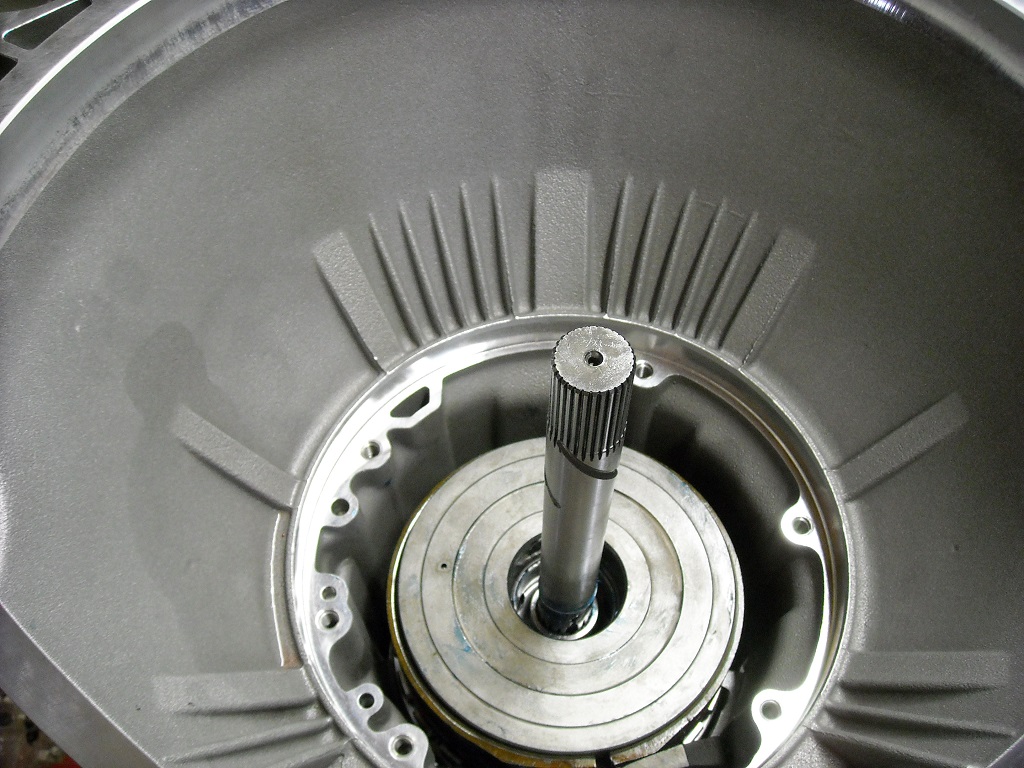

Old 12-24-2014, 01:21 PM   #4
Dragsinger
Join Date: Jul 2008
Posts: 1,760
Liked 99 Times in 60 Posts
Default Re: Woodfin's SS GT/TB construction series
On the 24th day of Christmas we are a changing gears, the two speed trans is being built.
The next day or two will complete the Reid cased powerglide of the Super 10. All parts, supplies, tools are on hand to finish up.
These photos show;
* case with only reverse clutches in place
* pump with new stator tube pressed in place
* high clutch pack
* pump gears
* assorted springs and hardware
Later I will show air testing both reverse and high clutch packs

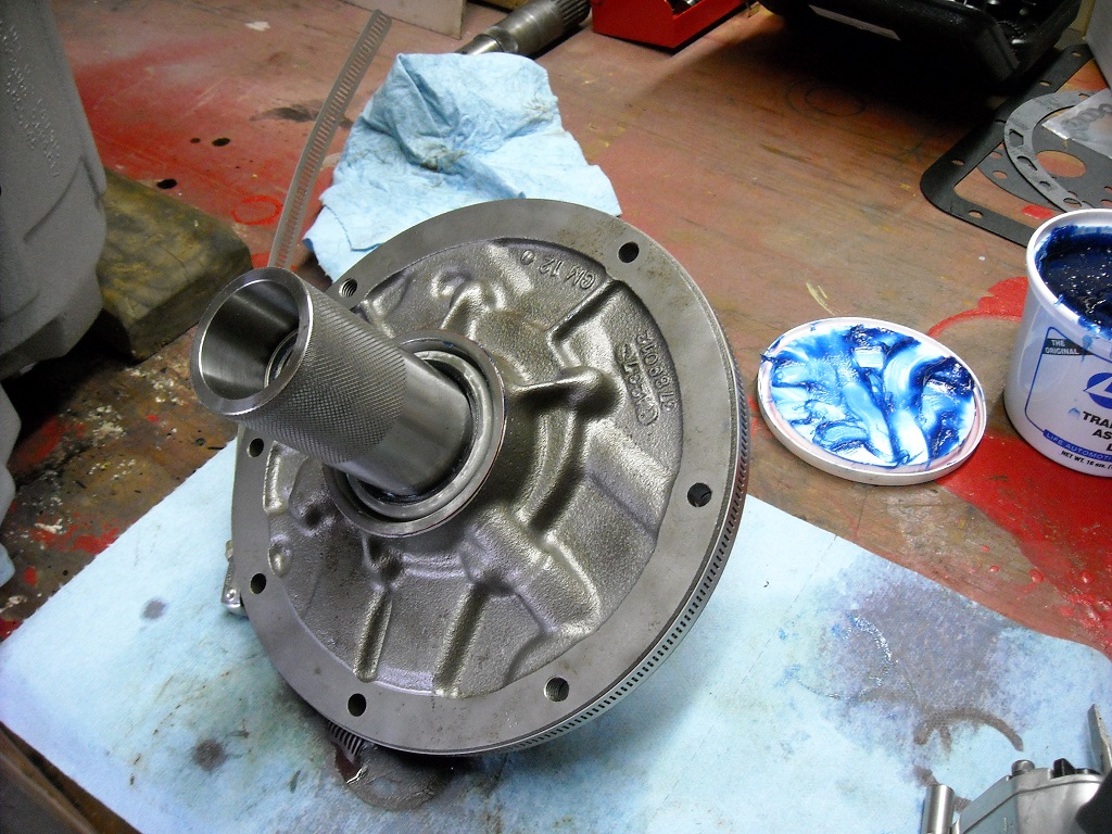

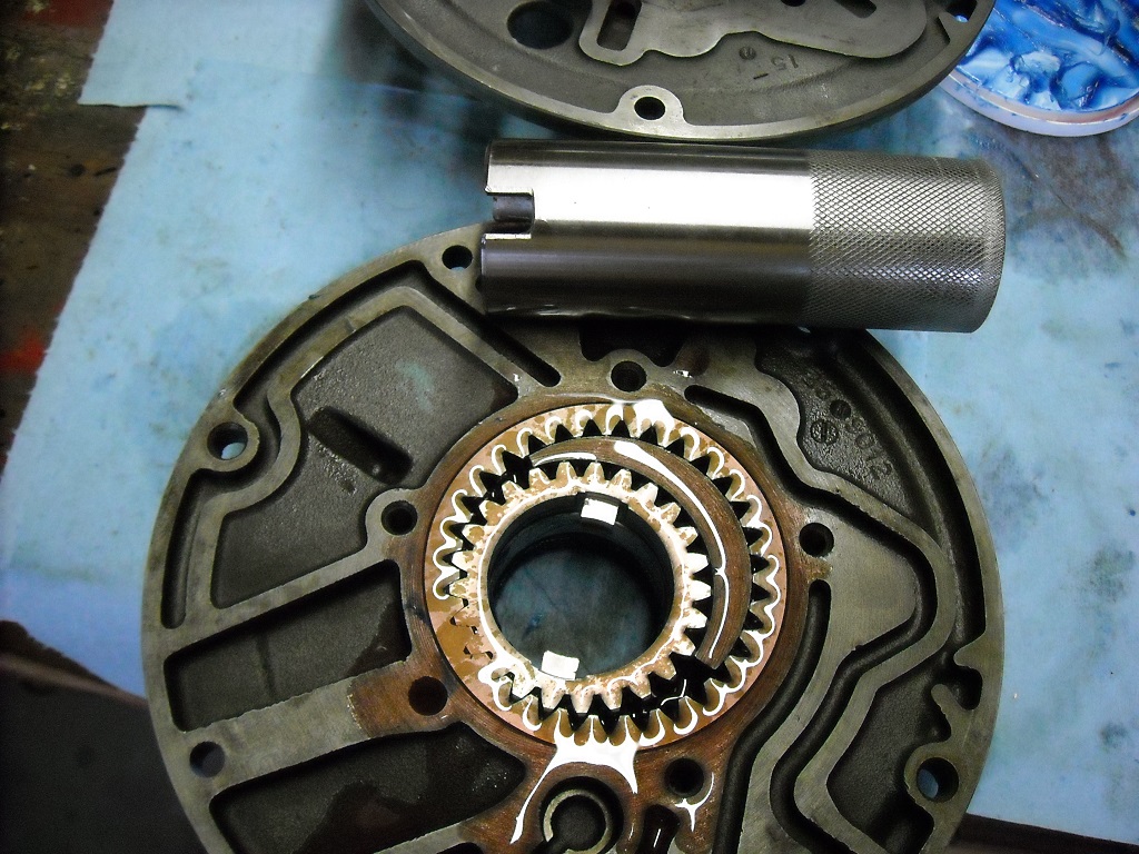

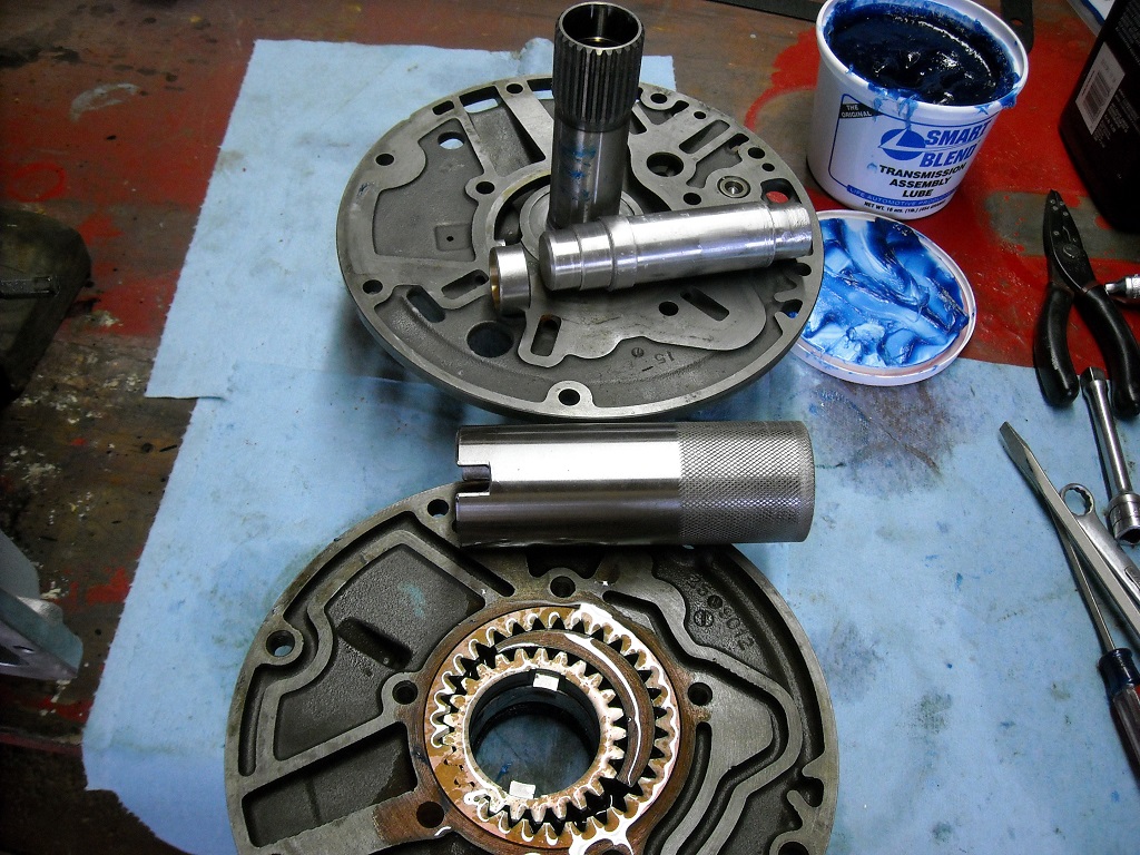

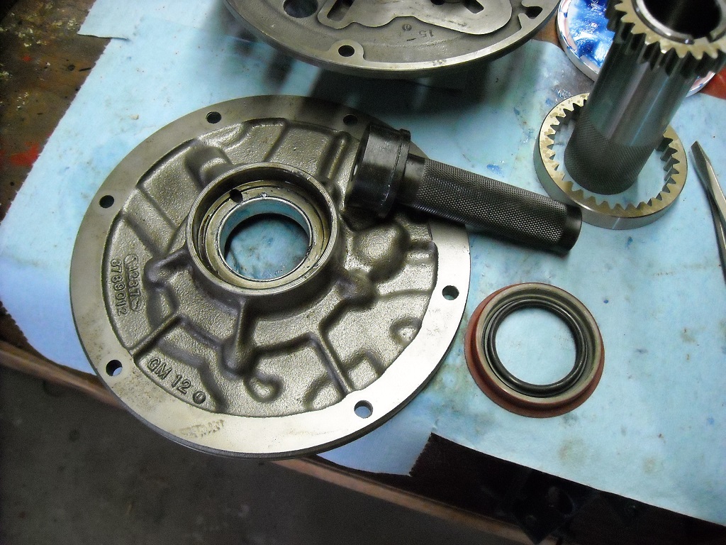

Old 12-26-2014, 04:50 PM   #5
Dragsinger
Join Date: Jul 2008
Posts: 1,760

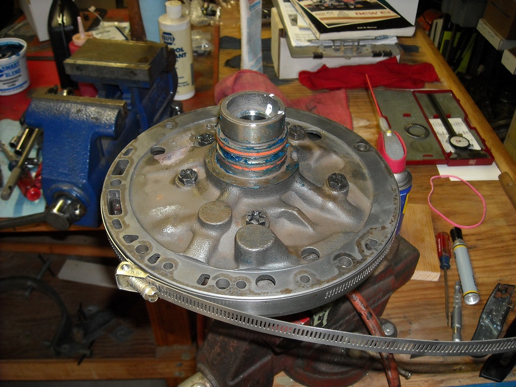

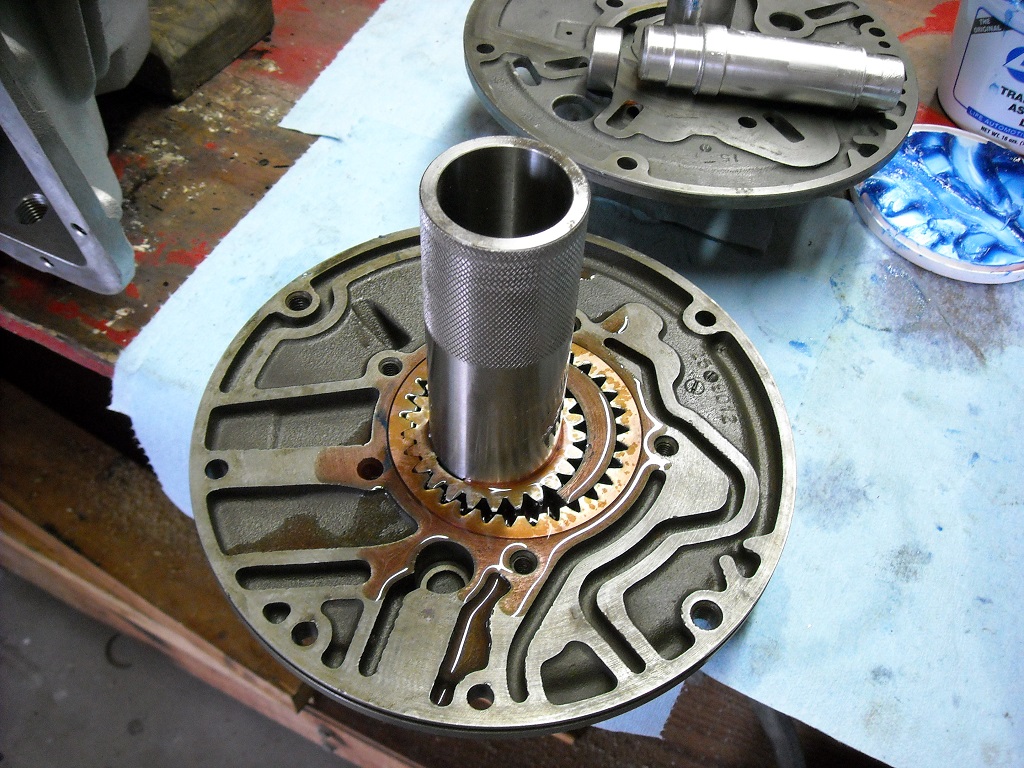

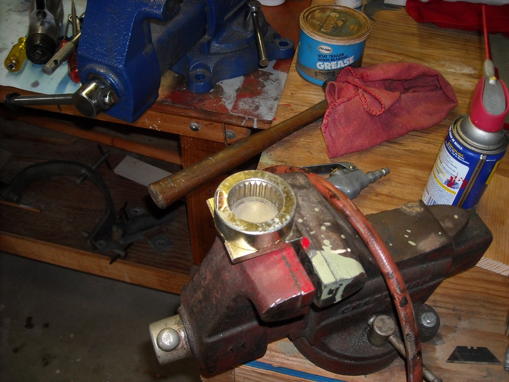

One of my goals with the Super 10 project is to show some items that are not usually addressed when documenting a build up.
To review from earlier comments, if you are considering doing more, building more than you have in the past these pages may encourage you to do so.
This information is not secret, it is common, done every day work that you can do with patience and education.
The pleasure I receive from drag racing only partly happens at the track. The work of building is also very rewarding. In addition, the learning process is very satisfying.
Using the Super 10 powerglide as an example, I could have paid about $200.00 more and bought a complete, ready to install trans. However, it would not be personalized, it may or may not incorporate some of the methods to reduce drag that are presented in the Carl Munroe book.
By doing my own building I become "1" with the machine. And that is something I like.
It is not something that suites everyone but if it interest you to learn more and do more I think that is a good thing.
The following photos show;
*High drum in place
*Pump bushing and tool.
*Pump gears and tool
*Stator bushing and tool
*Gear tool in pump
*End play checking
*Clamp to align pump halves
All this and much more is detailed in the Carl Munroe book.

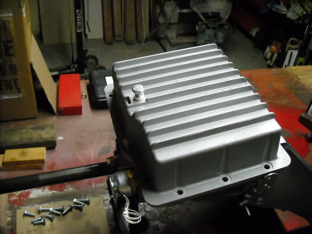

Old 12-26-2014, 08:46 PM   #6
Dragsinger
Join Date: Jul 2008
Posts: 1,760

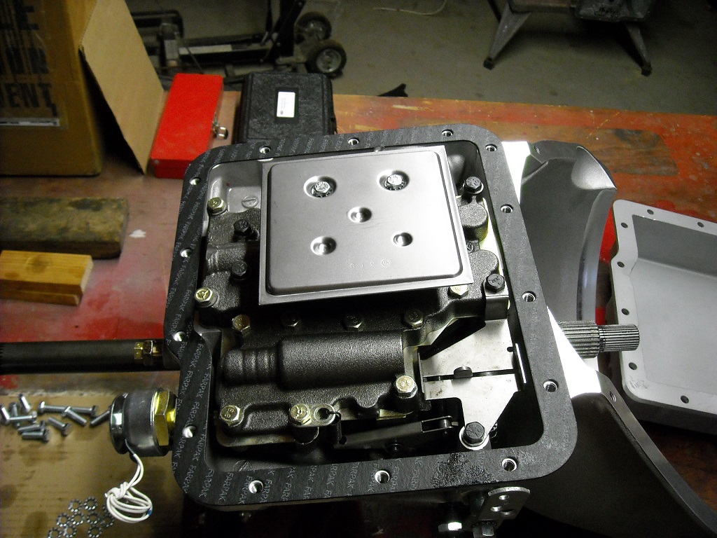

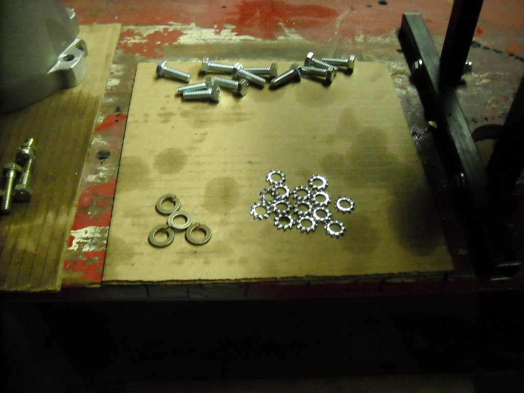

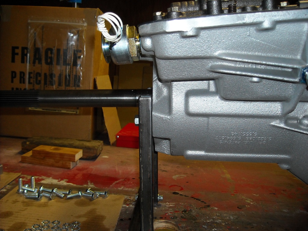

Friday afternoon we wrap up the Super 10 trans. The only remaining works is rear output shaft support and tail housing install.
In the above post I talked about "personalizing" the build. The last photo is a good example of that. This is a small item but something I prefer to do differently than what came out of the box. You most likely have heard it said, "that is how it came out of the box so that is what I used"
The BTE pan bolts are packaged with star washers but I do not like star washers on aluminum. After a few removals they will dig into the pan. In this case a thick AN washer will be installed.
Same situation with the Reid extension housing bolts, they were packed with lock washers. The same thing as with the star washers, a few removals and the washers will gouge the housing. The fix is the same, thick AN washers.
Saturday morning work turns back to the frame. Stand by for more updates,
