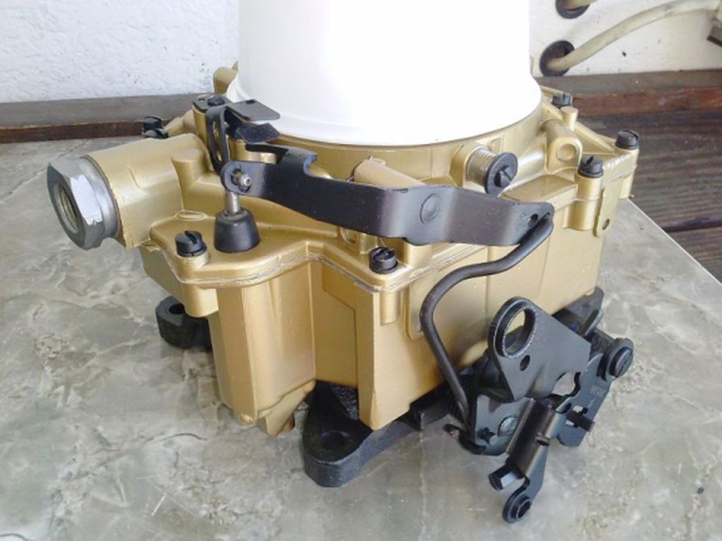

Here's the carb, which was a swap meet special, now with lots of new parts from Larry Fulton.
Not a 100 pt. restoration but I think it looks alright.
