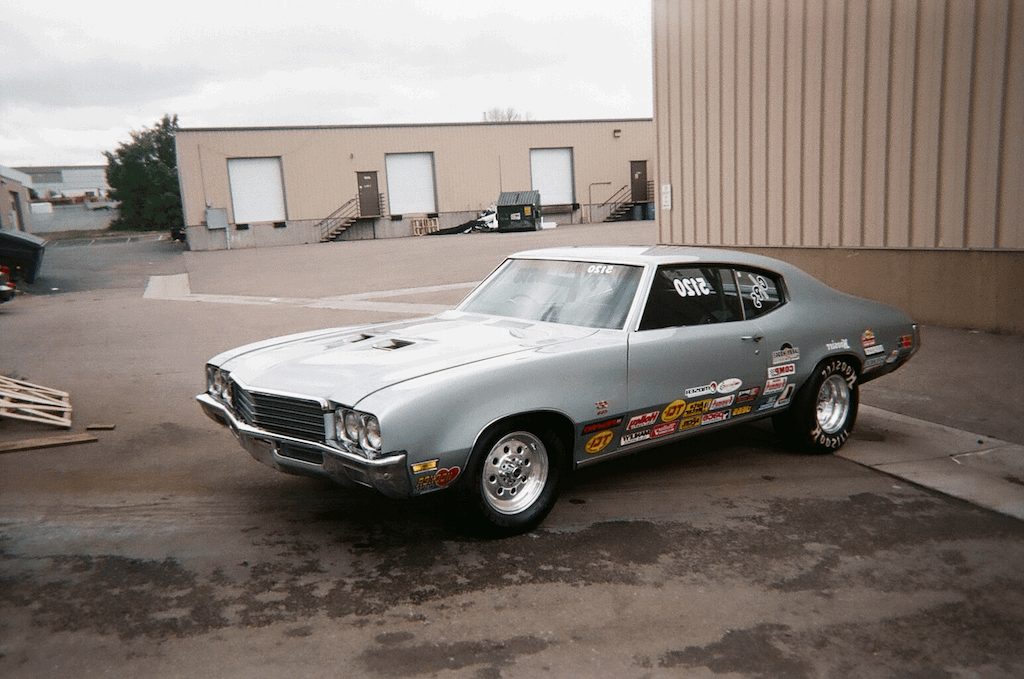

Originally Posted by SSGN View Post
Nice car and great to see some Buicks out there. I remember this car when it was for sale a few years ago. Good luck and post up some pics.
Here you go.....
Name:	Buick Stocker.gif
