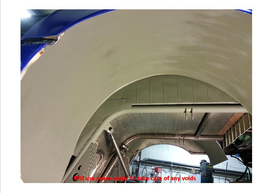

They sort of have a frame at least out front and the rockers are beefy but, I think it is referred to as the bird cage on a Corvette. The fiberglass is molded to that birdcage (somehow). The rear portion of the frame was smaller and lighter (where the rear suspension was). An aluminum frame work attached to that to connect rear bumper and a saddle for fuel tank. I think the spare tire was under that too.
You must maintain the rear frame rail top height and storage floor (trunk if you will) as well. I was told (Tech guy) to use metal sheeting in the back to replace the fiberglass. The same applies for the wheel tubs. In the passenger compartment. the front half of the floor is fiberglass and the rear part (where the seats go) is metal.

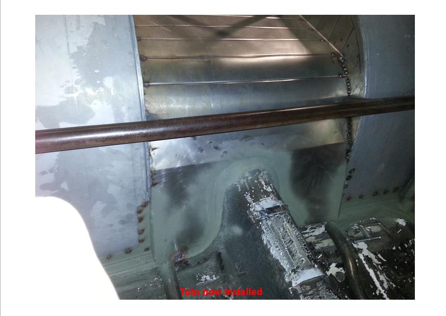

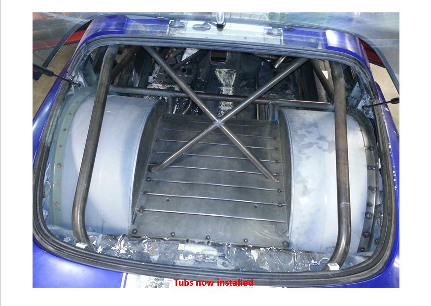

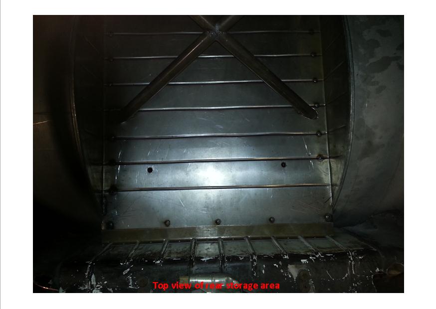

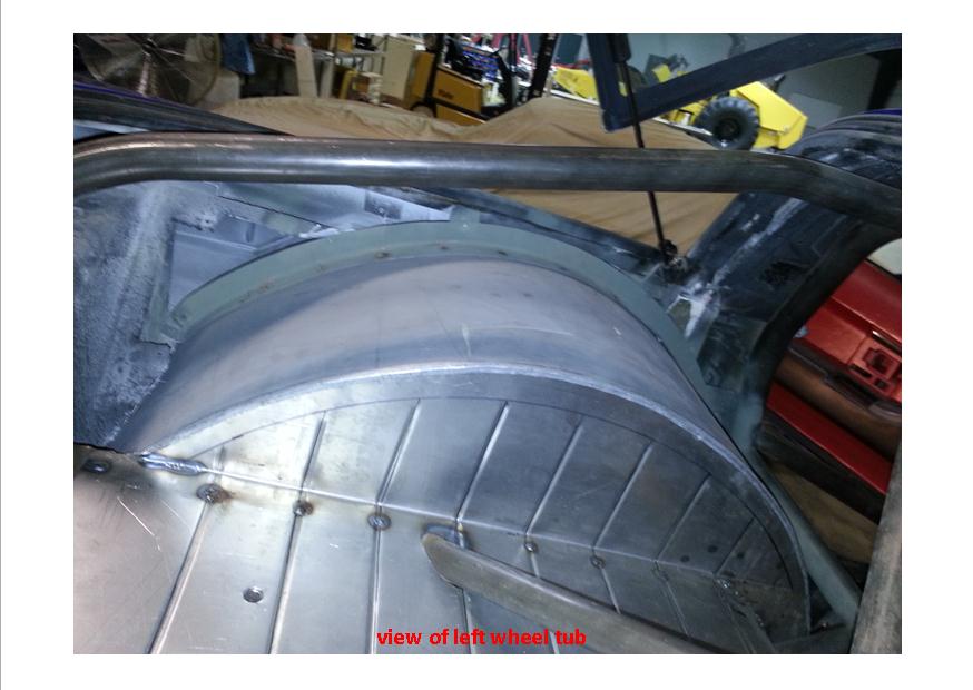

Most of these are of wheel tubs, enjoy!
ID:	38093   Click image for larger version
ID:	38094   Click image for larger version
ID:	38096   Click image for larger version
ID:	38097   Click image for larger version
ID:	38099   Click image for larger version
ID:	38100   Click image for larger version

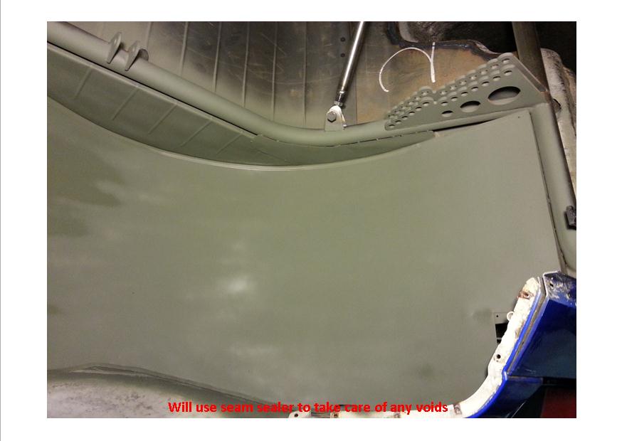

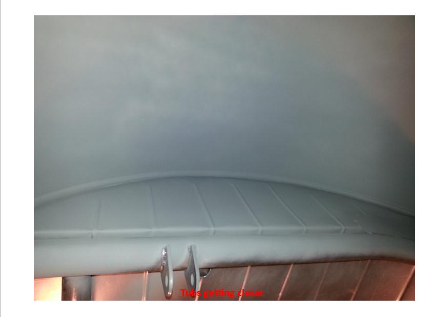

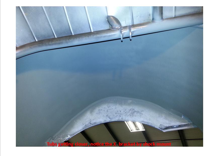

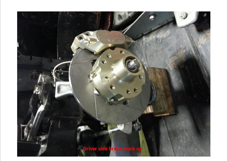

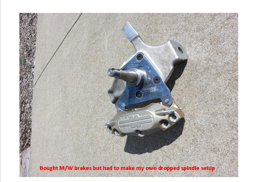

more wheel tub fun on these and start of my lowered spindle using Mark Williams brakes
ID:	38106   Click image for larger version
ID:	38107   Click image for larger version
ID:	38109   Click image for larger version
ID:	38110   Click image for larger version
ID:	38112   Click image for larger version
ID:	38113   Click image for larger version

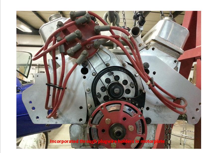

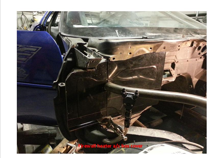

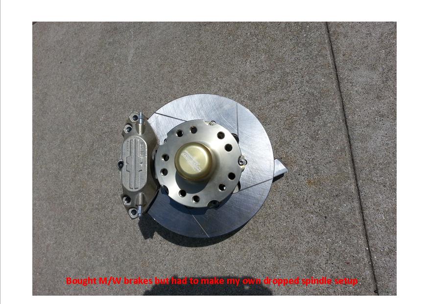

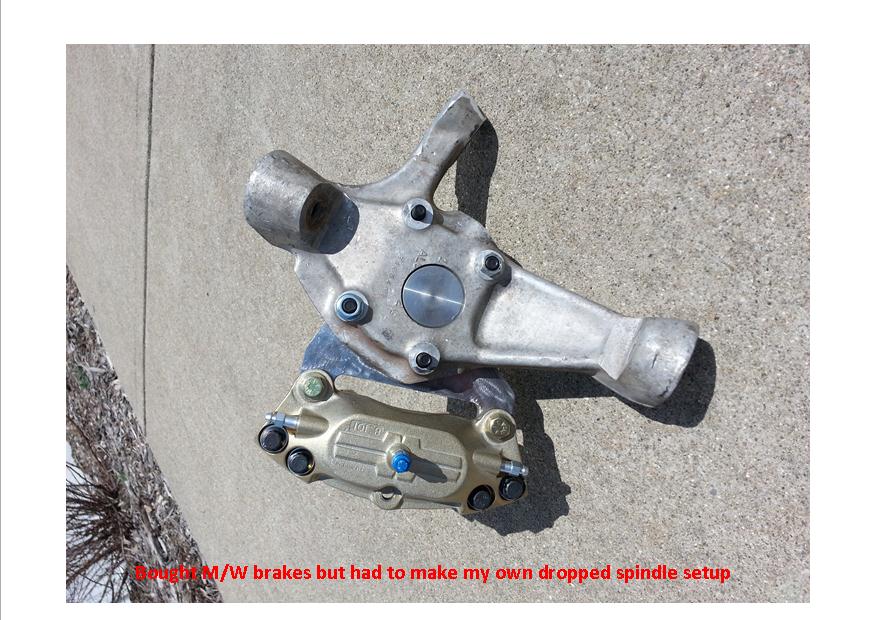

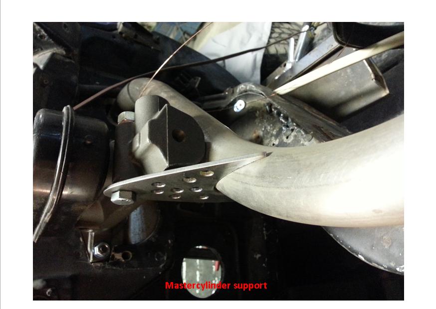

some more photos of the Mark Williams brakes I used on my lowered spindle position. The kit is for an 82-92 Camaro, less mounting brackets. AJE had these spindle stubs in stock. And the plates are now available at Cole Technologies, ask for David. The finished product has a backer plate of 3/16" on the through bolts.

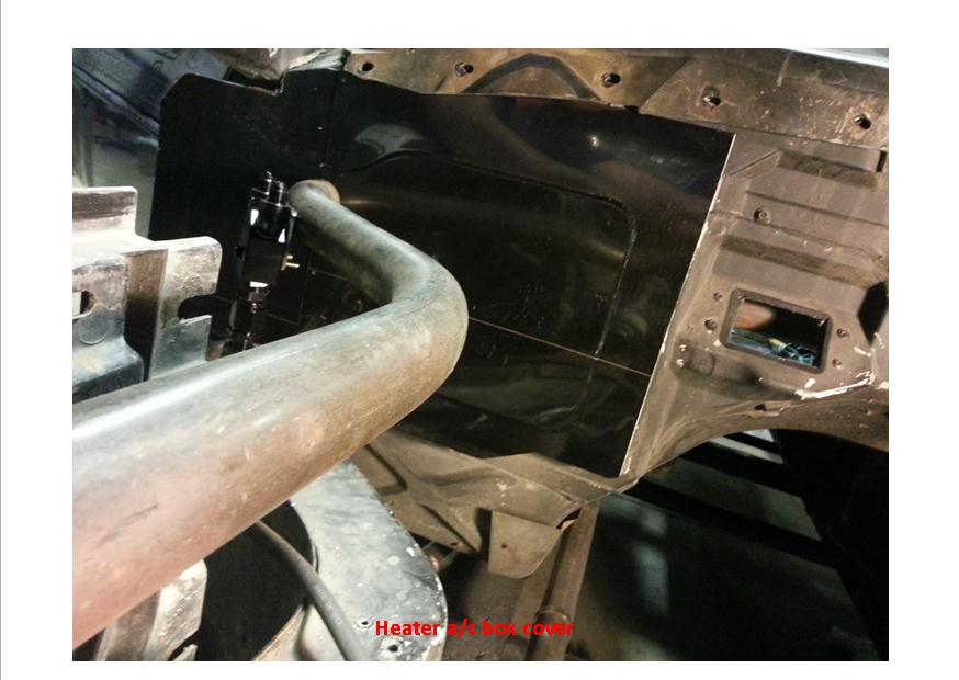

couple of pics of the heater box cover
I drew the holes for the plug wires to go through the motorplate with enough resistance pushing them to retain them in place. The waterjet cutting was done by my good friend David Tincher. I did 7 designs on this, but we decided to go with this one.

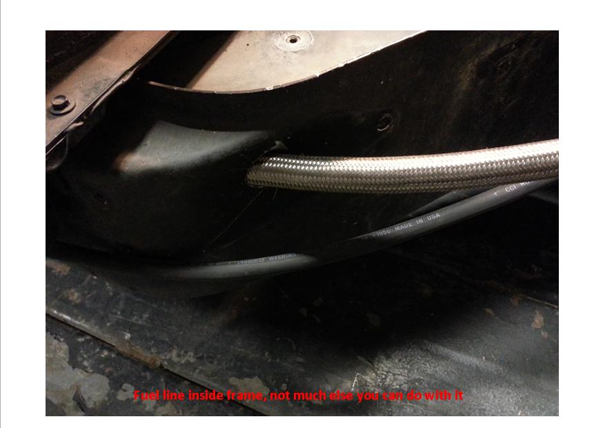

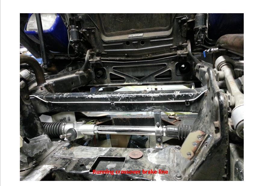

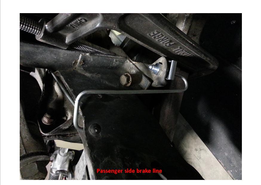

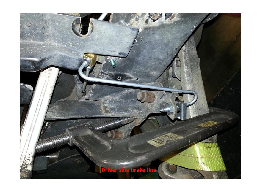

Brake line tubing to the passenger side protected from the damper, plus some of the other little jump tubes.
ID:	38116   Click image for larger version
ID:	38117   Click image for larger version
ID:	38119   Click image for larger version
ID:	38120   Click image for larger version
ID:	38122   Click image for larger version
ID:	38123   Click image for larger version
