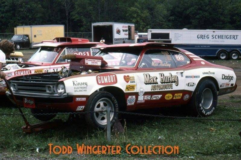

Looking for some. Found this shot of the Dart in the background:

Was this the Max Hurley Dart in the above pictures? Or was there another one?

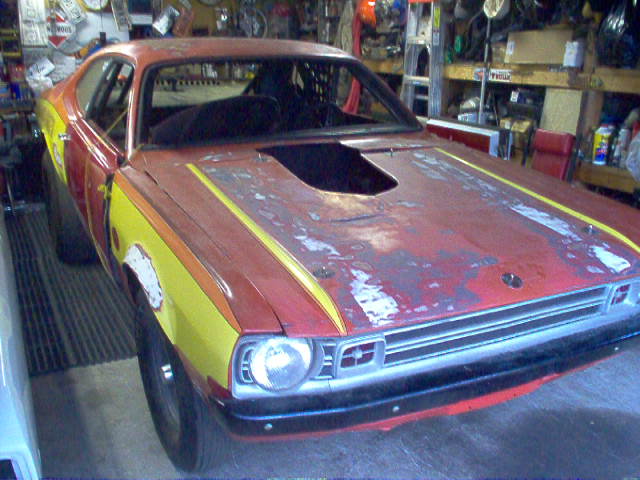

I owned the Max Hurley Demon about 9 years ago, had to sell it to buy the Poison Dart. Here is a pic when I owned it, still had the Motorwheel Fly's on it!

Waaaaay Cool sir!
Good reason to sell it.
Can you reveal where it went or if it is still alive?

Max had more that one Dart. Not sure what one was Eddie's. He must have repainted the one he got from Eddie Burl as soon as he took delivery.
