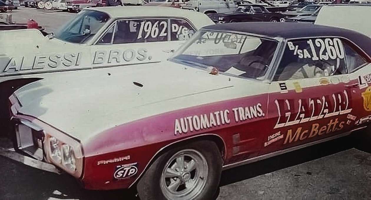

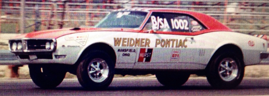

if pontiac, was bird, imo
Name:	2 - Hatari '69 B-SA .jpg
ID:	61087   Click image for larger version
Name:	1 - Weidner '68 B-SA .jpg

IF all the info you have from back during that time period is correct, then:
(1) What year could the '68 Bird I posted a pic of have run B/SA ?
(2) What year could the '69 "Hatari" Bird have run B/SA ?
Both obviously DID run B/SA, at least 1 year, at least at 1 track, under some sanctioning body.
When ?
When ?
B/SA=
8.50 in 1968
8.00 in 1969
7.50 in 1970-71
???? 1972
8.50 in 1973-up
So I'd guess those pictures were either 1968 or 1973-up.

"...B/SA=
8.50 in 1968
8.00 in 1969..."
That solves the '68 B/SA pic, for me. Dealers usually ran the cars while they were still the current model year.
According to my math, using an online calculator, a factor of at least 391hp would have been needed to put a '69 Bird into class B. S0, anything from 391 thru 414 would put it into B. 415 would put it into A, & 390 would put it into C, IF my calculations are correct.
So, could it have possibly been 395, 400, 405, or 410, in '69, maybe ?
