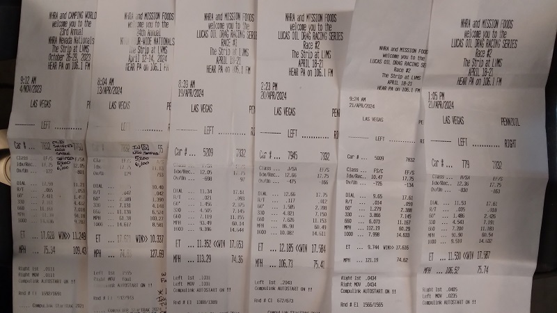

I had red light itis the entire 4 races plus I ran from September forward to the end of the year in E1 except adjusting to a single day of .030, .031, and .033 lights at Bakersfield Q1, C1, and E1, then next day went red again in E2. Pomona was off the trailer .020 Q1, .010 Q2, and -.008 again red E1 (though - .666 to -.797 under index in lower elevation and good air). (The absolute bane of a locked stock ECM/PM with virtually zero tuning capabilities...So far).
But, I long ago grew up racing at my night owl time of day, not many early morning races. It was afternoon time trials, night racing, and I wake up after the sun sets (no matter how long I have been up!) A natural born night owl here.
Coffee, and a lot of it is my wakeup juice. So, experience tells me I am close, but get away from coffee as a prelude to class racing. It was killing me. Then I found a legal cure, as I stopped taking my coffee pot to the track, but then also too shell shocked from many E1 red-light, I swung the as bad opposite direction to .060-.098 greens that will not also win many rounds/races. Though a few more than leaving first reds will.
Long story short, I finally found an easy (and legal), cure, and though it took a while, it took. Last race was Q1 .005, C1 was .012, E1 (still not yet fully convinced, I came up on the converter in E1, then before staging said nope, I backed off 200 rpm, staged and lazed out a .059 just to make sure it was not red), and banged off what I thought was my best run yet, followed by E2 .018, though both on the brakes at the big end I took just a bit too much stripe...OK, the car has been in the zone, though very slow at Vegas, very consistent when I am not attempting to push it the 3 tenths plus faster it is absolutely very capable of running, and just driving it the same, and the drivers head is finally out of his butt and in the game also, at the same time.
Ok, let me take a pic of 6 time slips, and resize the pic and post it. All are at Las Vegas, altitude struggle bus track w/that lousy DA. 1 from E1 November 2023(cold out), 5 from April 2024 (98 Degrees out), pay no attention to R.T.'s I covered that already. Pay little attention to the final ET's 5 of the 6 were somehow on the brakes, a lil' or a lot, leading or following. 2 different shifters, many tiny or large changes, and a major class change and change back, all are either E1, E2, C1 competitive races.
But, struggle or not, as a lifelong bracket racer ...7 thou between November 2023 E1, and April E1, and look at all the 1,000' ET's and MPH. The car has been in the game, the driver was just needing to catch up, and quit worrying about going fast. The super fat air, with the stock ECM/Power Module is doing its job, even if phat and rich as can be. The dial in's are not all equal.

Default Re: A 30 year journey, and a 2nd chance.
Gary Lucier - 7832 STK. / 7832 E.T. EF/S Slow Sled. I am, but a simple test of your true patience. So, do all the really "Big Wheelies" you can!

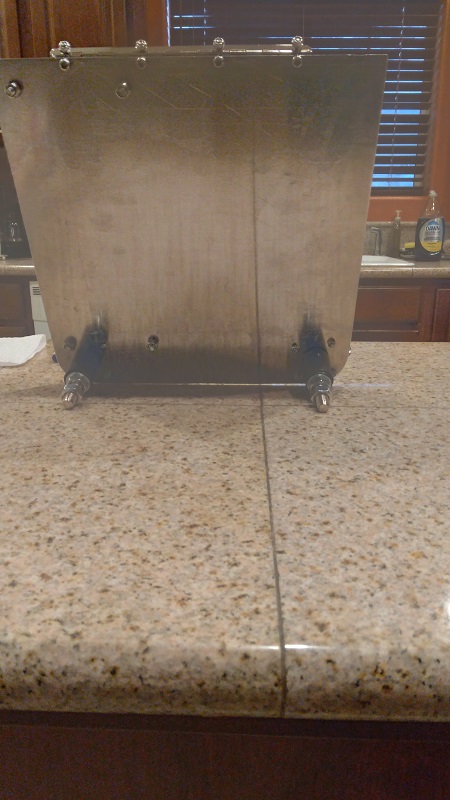

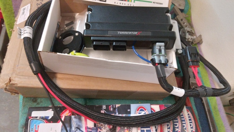

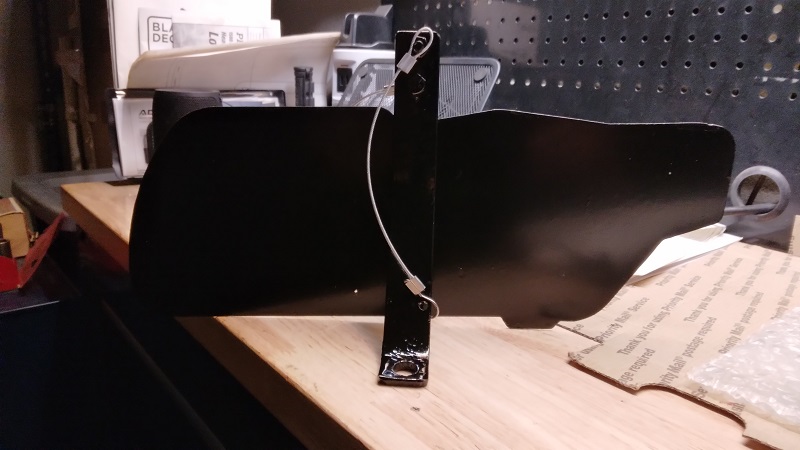

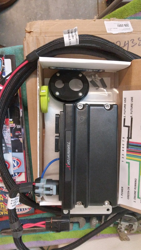

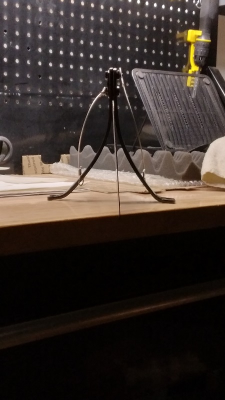

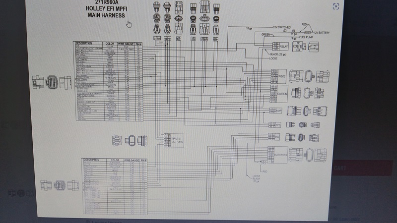

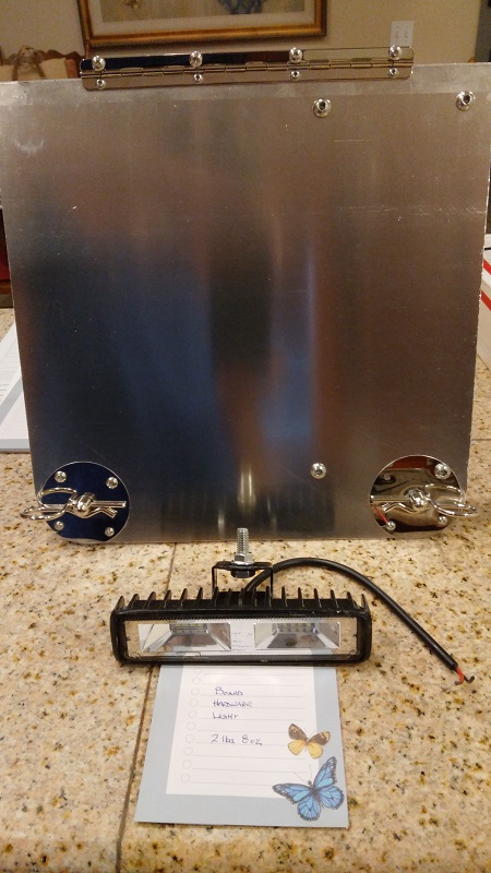

On to start bigger and better things, and finally start to make this car finally tuneable! Car is still in storage in Las Vegas until all the parts and pcs are in and ready to put on the car, but the Holley Terminator X ECU, Main Power Cable are in already, and made up a pr. of electronics mounting boards (1 for me and 1 for a friend in Texas (Greg Hogue), who is building a Stk.1984 2.2L Daytona Turbo Edition).Click image for larger version

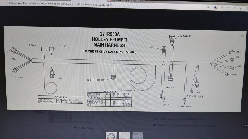

I will be using an un-terminated 15' main harness to create a custom harness (Using the Universal MPFI docs as a guide), as they don't make a terminated harness for the 84 Daytona 2.2L/135 CI Single point TBI.
