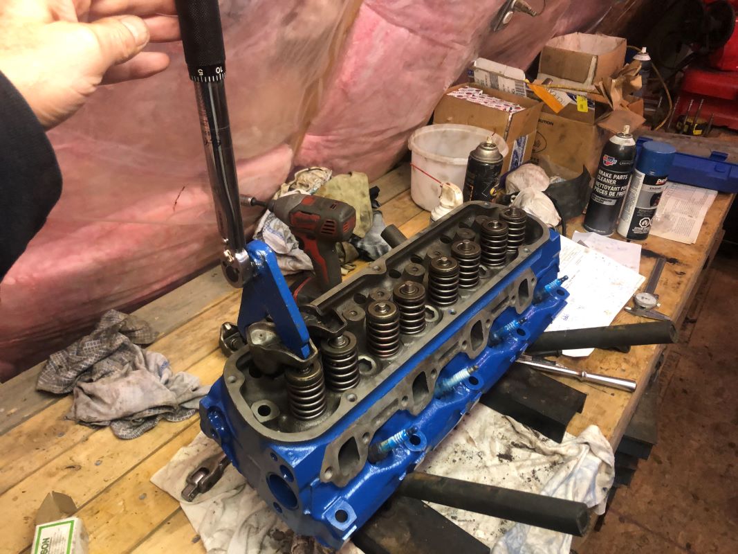

Next up was a way to check the springs on the head. I cant find my checker (of course) so i made one that fits the rocker arm and a 1/4" drive torque wrench. By taking the springs on and off to confirm, i found 50" is equal to 50# on the spring. 90" is 90# etc.
Now i can confirm spring pressure on the car.

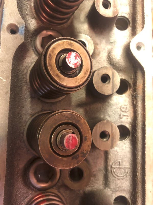

Another benefit to the tool is, i bolted the rocker arms down, then used the tool to compress the springs .400 or so and after using red marker on the tips i was able to (crudely) approximate where the rocker and spring contact. Almost all are a thin line on the stem but some are a little towards the outside which means the rocker arm is too high (or you have too long of a pushrod)
Obviously its not perfect, might of pulled too far or not far enough which would affect where it marks but generally it was pretty good.

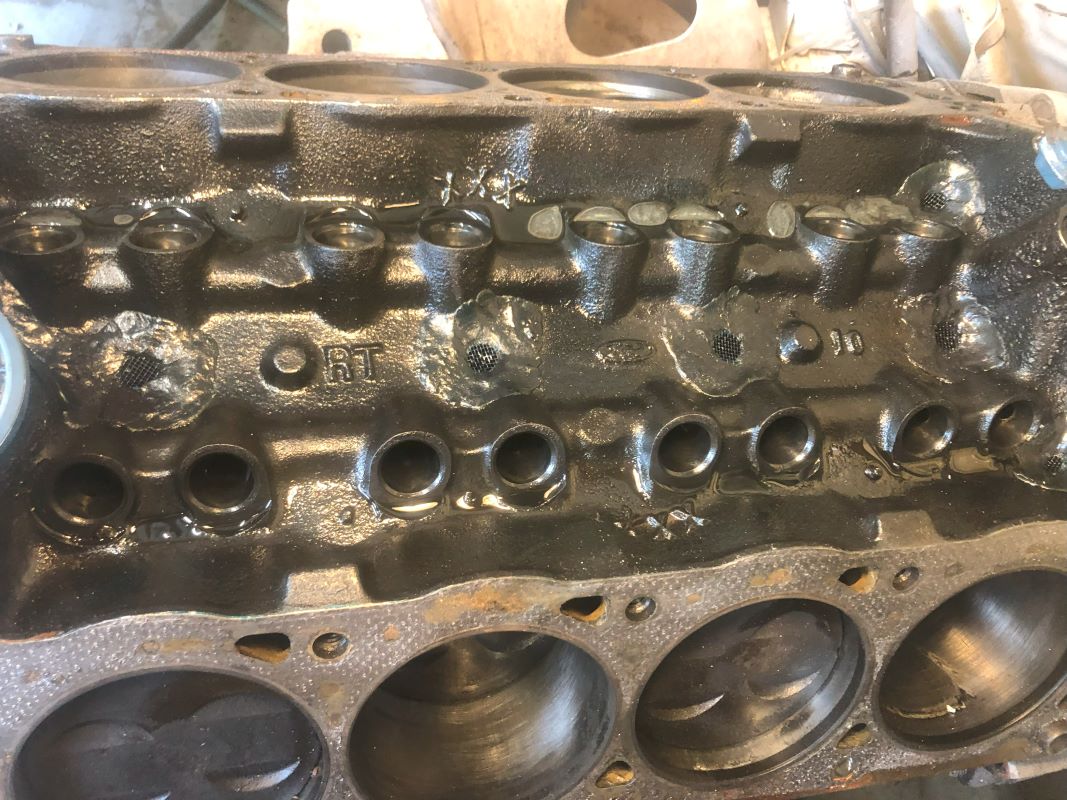

Another good thing was when I pulled off the intake, I found that I had ground out the oil return holes and covered them with screen and epoxy...this was just an engine to move the car around the shop but apparently I took my time with it? Lol!

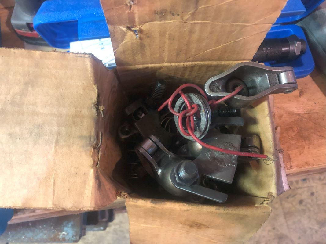

More good news was finding the .030 shims packed away. I also just found some hardened pushrods (for guide plates) and a HD oil pump drive shaft for a 302, new, still in the box.

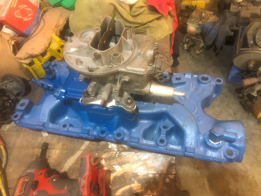

Last pic is the complete intake and carb ready to install.
