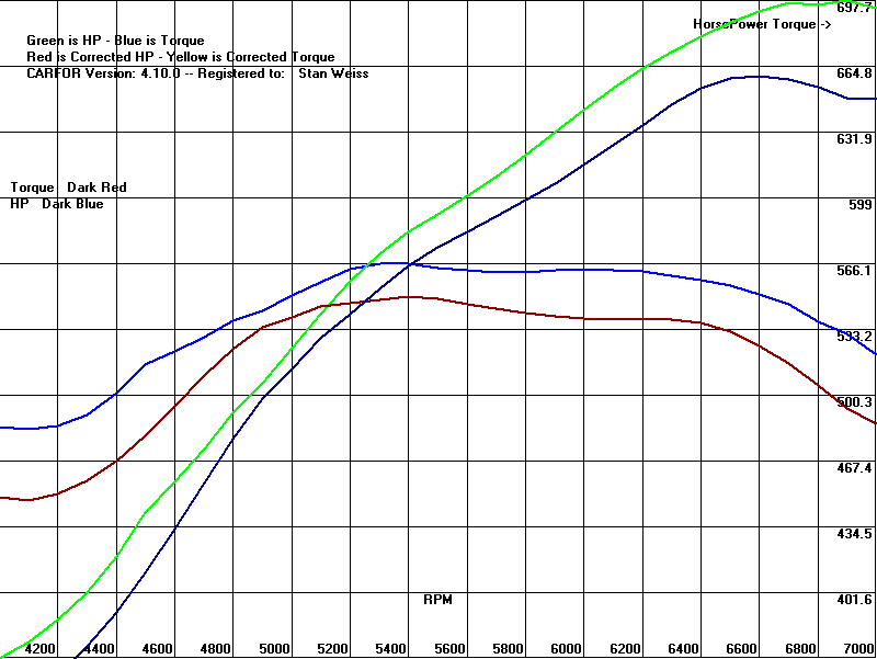

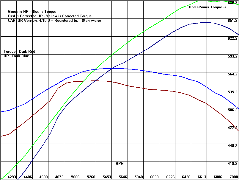

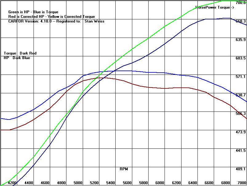

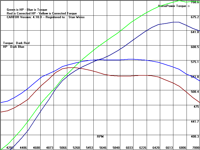

As a followup. I find it interesting how at around 4900 RPM almost all of these have the torques come so close together.
Stan
ID:	71781   Click image for larger version
ID:	71782   Click image for larger version
ID:	71784   Click image for larger version
ID:	71785   Click image for larger version
