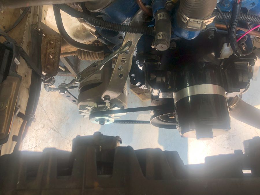

Liked 403 Times in 158 Posts
Default Re: U/SA 302 ffffford build
Here's a pic of the alternator set up now. Once I have time I'll probably go back and replace the aluminum flat bar with a new prettier one with only one hole, this was a piece of scrap aluminum from the kids junior that's been gone for 6-7 years. (Why I never throw anything away, LOL!!)
Alternator is nice and low now, belts tight, charging great. Once I get to the track I'll find out if high rpm kicks the belt, lol.
