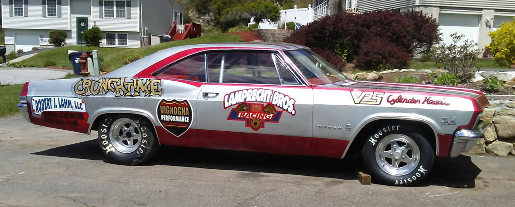

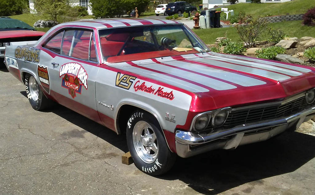

Been a long time coming, near the finish line. Over 3 years now, best I can do on a limited budget. 396 Shortblock done, finish heads. Then driveshaft has to be made.
Plan is August
Will Lamprecht
Div 1 I/SA 65 Impala 396/325

WOW!
The car looks AWESOME ! I love it .

Looks fantastic!

That car is awesome!
