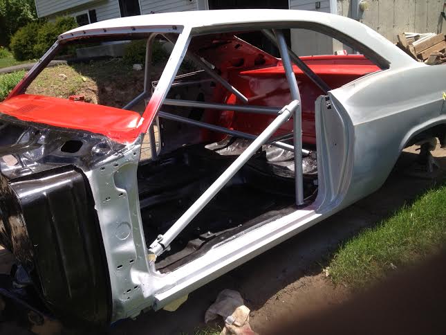

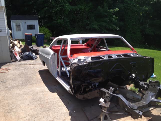

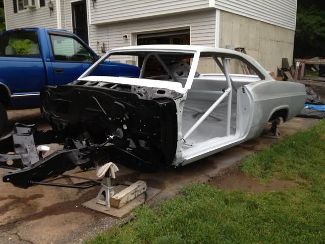

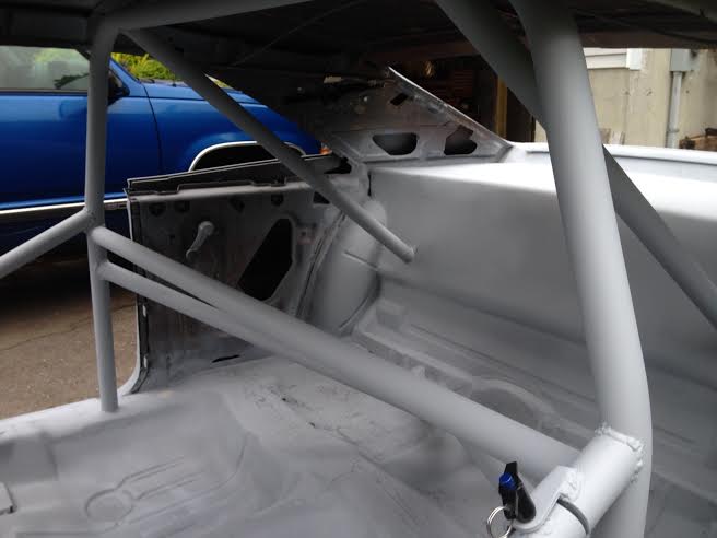

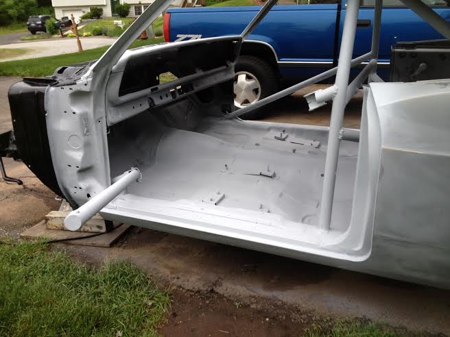

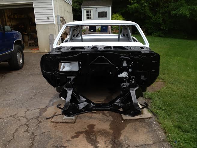

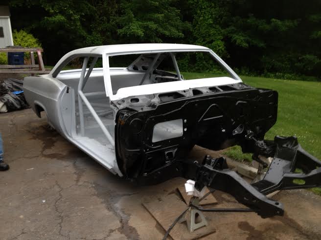

Here is update of build. Frame attached w/ solid mounts. Roll Bar and interior sheet metal all done including trunk "firewall" sealing off trunk area. Bucket seat mounting brakets installed Lots of work by myself, may not look it. Happy w/ progress- Rear end , front suspension and brakes next and paint next- hope to have rolling chassis soon.
Will Lamprecht I/SA 396/325 in pregress

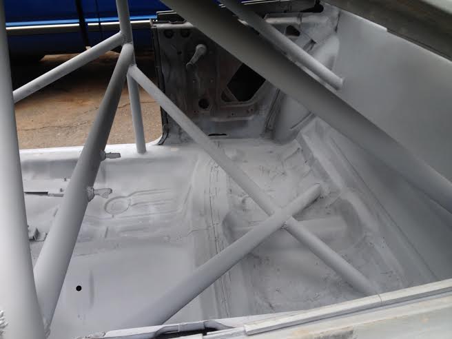

new pics- painted roll bar & dash, ect- color of car will be same as roll bar, metallic silver.
