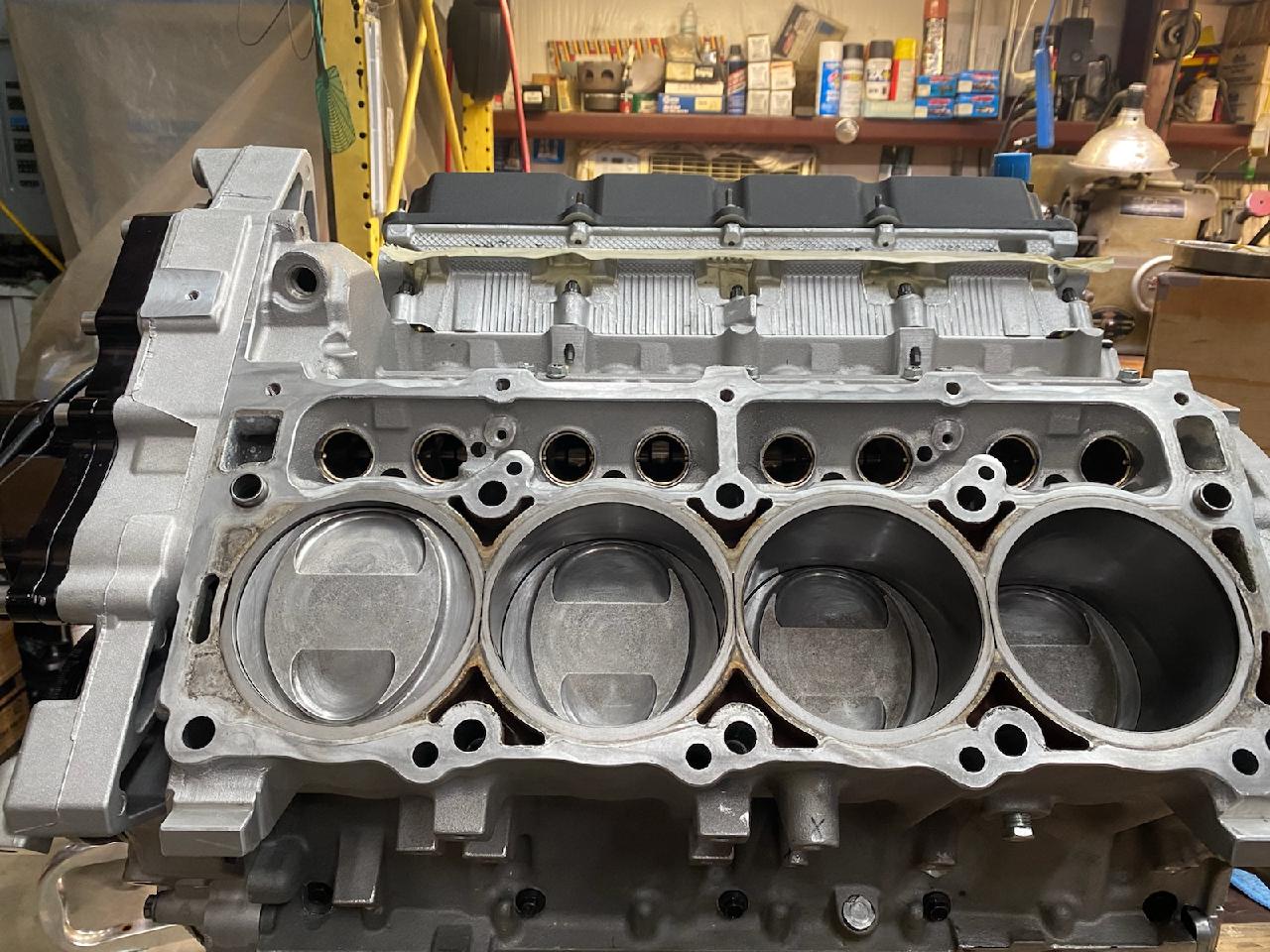

Getting closer to smelling smoke. Front cover, water pump, damper installed and torqued. Holding the block with one hand a pulling the damper bolt to
129 Ft/lbs it took a few try's but I got it done. Checked TDC to the ATI damper it was spot on. Today is head day. The heads are easy. Its the pushrods and valve train that is more fun than an empty barrel.

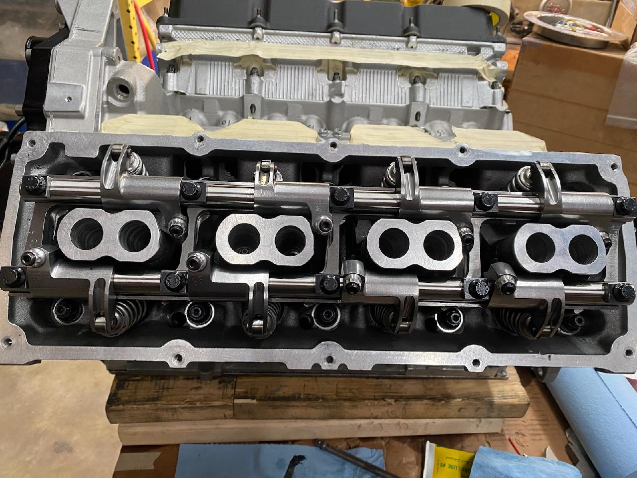

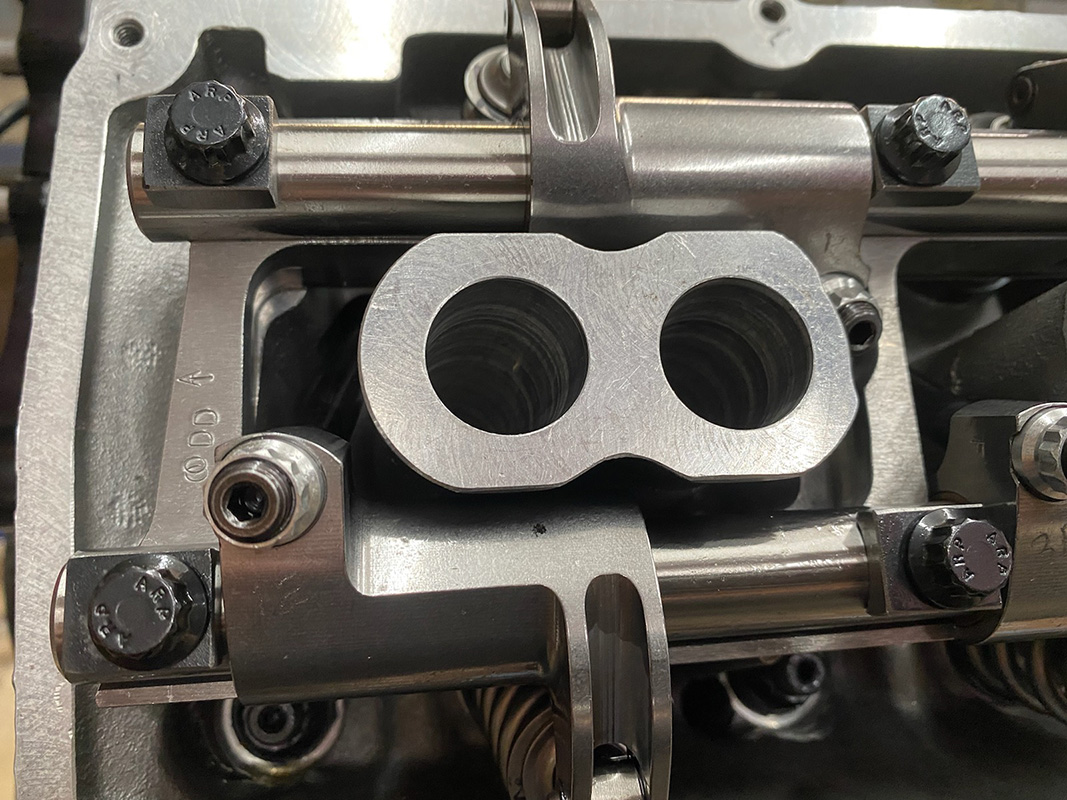

Started to put the last head on then I realized the lifters will only go in before the head is installed. It's just one more stupid old man trick.
ID:	64224   Click image for larger version
Old 08-16-2022, 01:59 PM   #644
Posts: 10,629
Likes: 1,922
Liked 10,682 Times in 2,222 Posts
Default Re: Dumbo The Flying Elephant
No place for big hands and fingers, its busy up there.

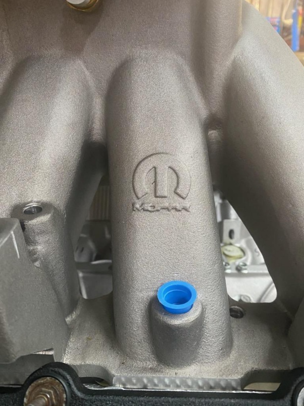

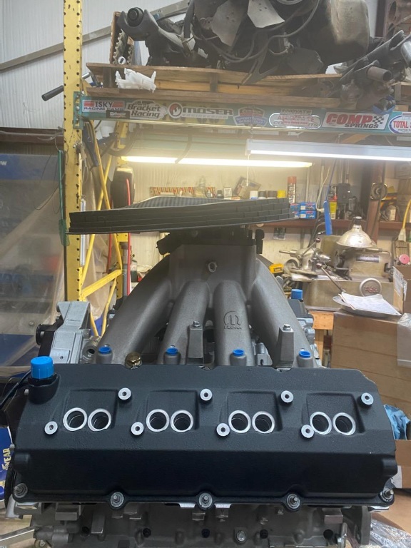

Dumbo is starting to develop a little bit of a personality. I still need to button up the oil pan, but that will be tomorrow.
Today is Taco Tuesday a day late but the margaritas will be good. They won't be as good as Stan and Shella's but they will contain "grog" and imitation lime juice and salt. I know they will be bad for my diet, but oh well!
ID:	64227   Click image for larger version

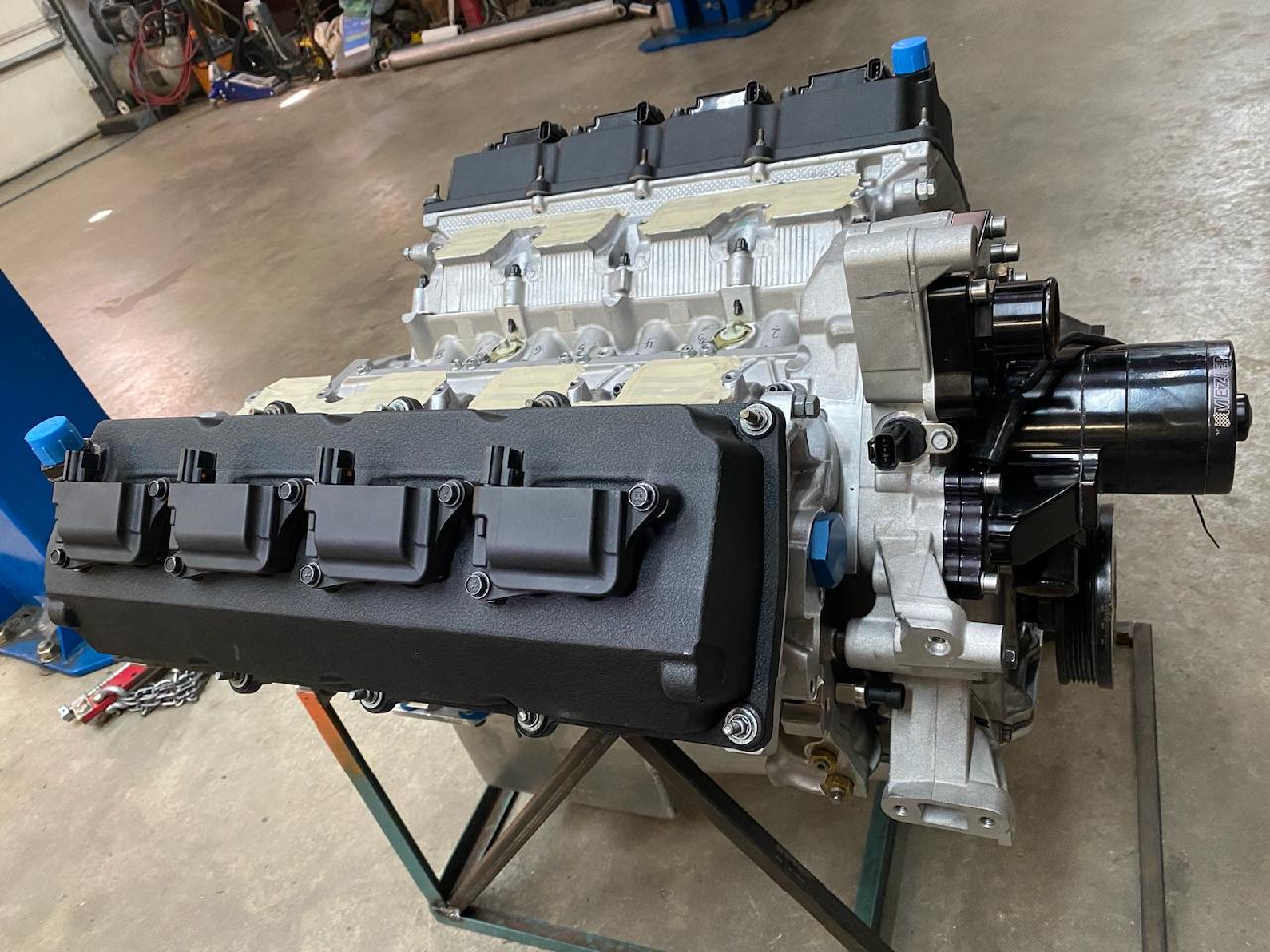

Ta-Dah
I just hope its not Ta-Dud!
I hope to record a Dyno pull or two next week, good or bad. As Steve Kopein would say " I just got's to know "
I know I'm not finished but there is a list of things I want to try on the next one. Patsy says I'm hopeless.
