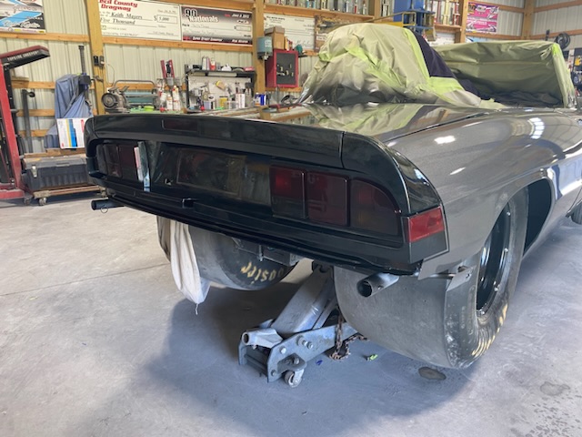

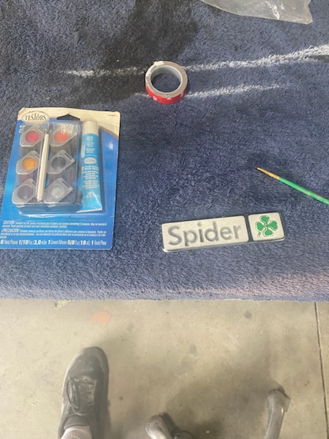

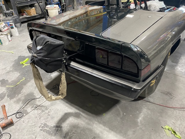

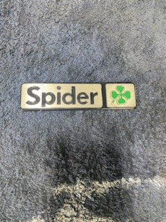

While I was waiting for some things to dry I mounted the onboard air compressor, and re-painted the quadrafollio (cloverleaf) emblem. This was a special edition Alfa so I thought it should go back on

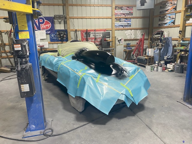

Old 05-03-2023, 06:12 PM   #62
Keith 944
Keith 944's Avatar
Join Date: Feb 2006
Location: Dela-where?
Posts: 2,193
Likes: 1,160
Liked 1,877 Times in 577 Posts
Default Re: S/ST-S/G Alfa Romeo Spider Roadster

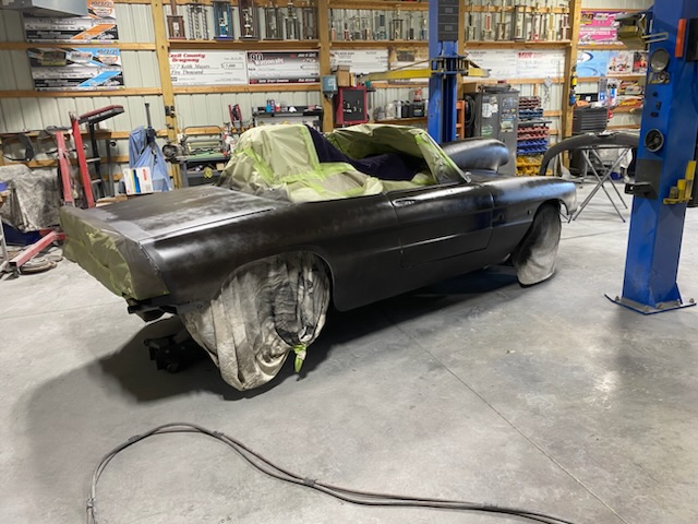

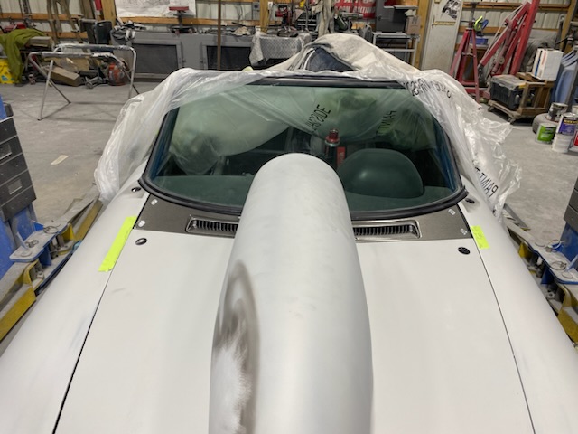

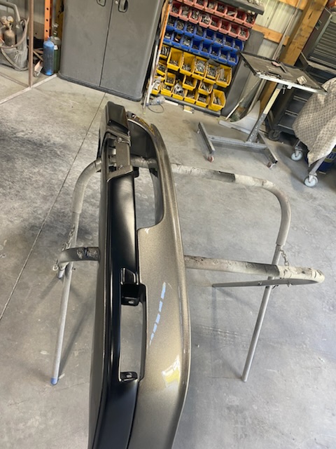

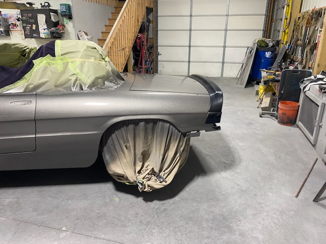

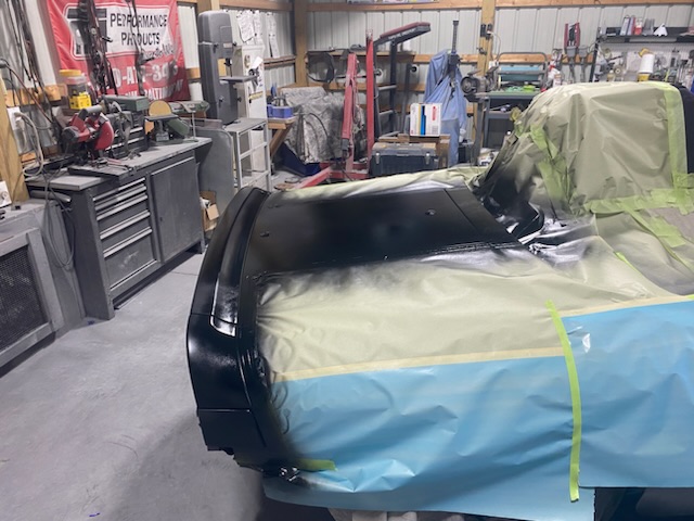

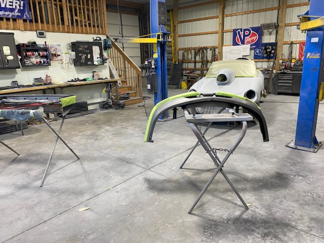

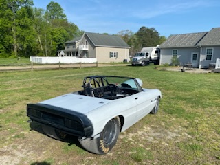

Ok these were the last steps before painting, a final 400 and scuff pad all over sand. About a 2 hour cleanup of the shop. Then another wash down and tape off then the black sealer.

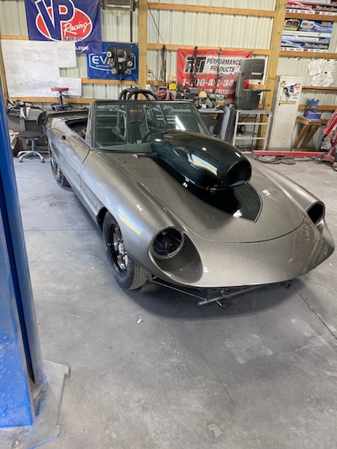

Old 05-05-2023, 07:50 AM   #66
Keith 944
Keith 944's Avatar
Join Date: Feb 2006
Posts: 2,193
Likes: 1,160

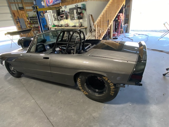

Well most should see it this weekend so here comes the final stages of the build

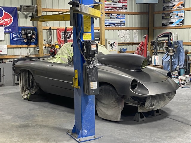

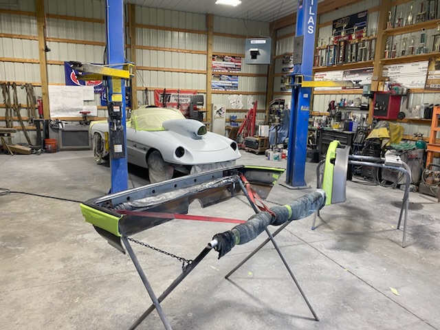

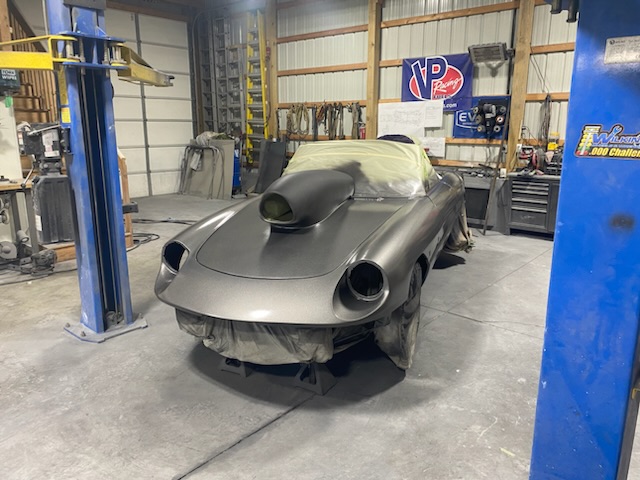

Laying on the color, this is a single stage paint so after spraying I wait overnight to tape up the stripes and finish with clear coat before the 18 hour recoat time.
ID:	67188   Click image for larger version
ID:	67189   Click image for larger version
KEITH MAYERS
2-1/2 X somebody
Still many X nobody
Old 05-05-2023, 07:55 AM   #67
Keith 944
Keith 944's Avatar
Join Date: Feb 2006
Posts: 2,193
Likes: 1,160

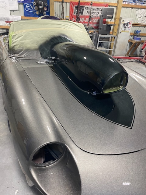

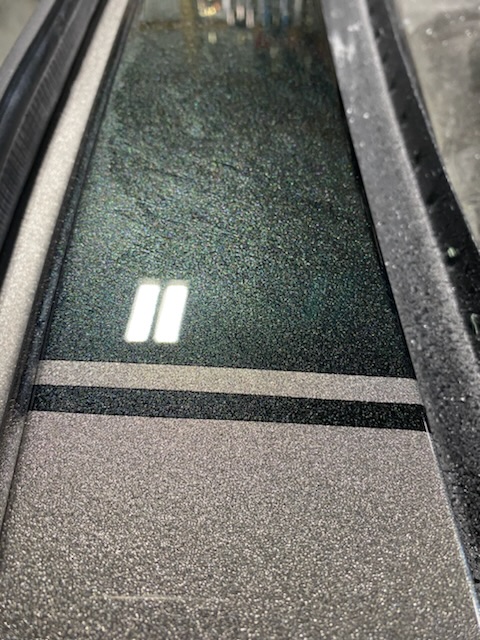

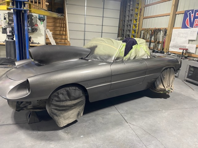

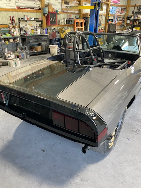

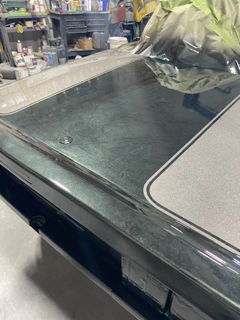

Ok now lay down the black base, mix up my pearls with the marbleizer and top them with an intercoat clear let set up and lay down the clear!

Old 05-05-2023, 08:02 AM   #68
Keith 944
Keith 944's Avatar
Join Date: Feb 2006
Posts: 2,193
Likes: 1,160

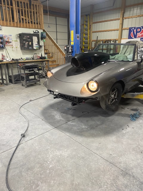

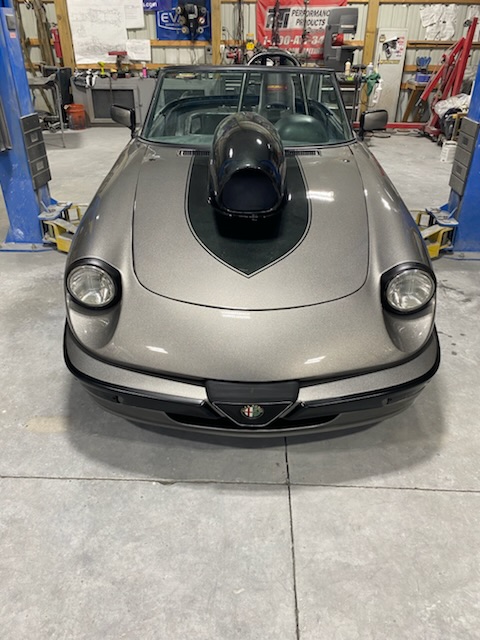

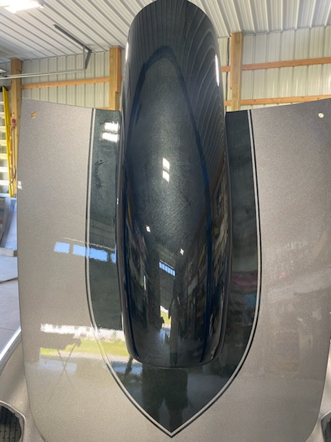

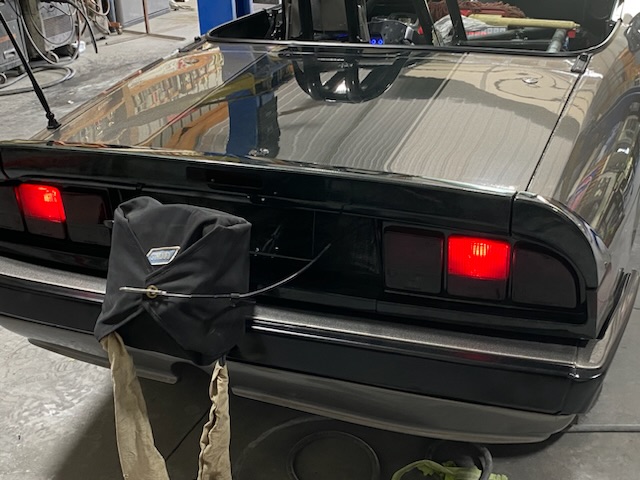

Clear laid out nice so a quick buff and time for re assembly

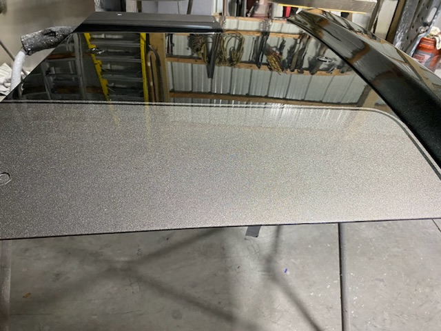

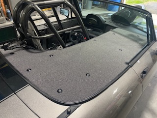

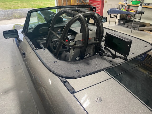

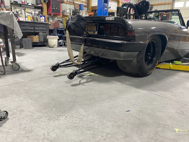

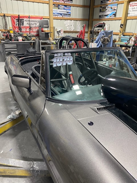

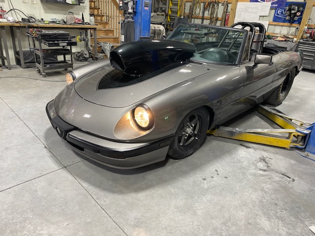

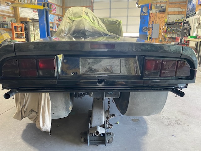

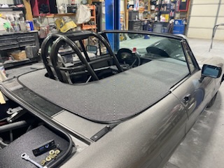

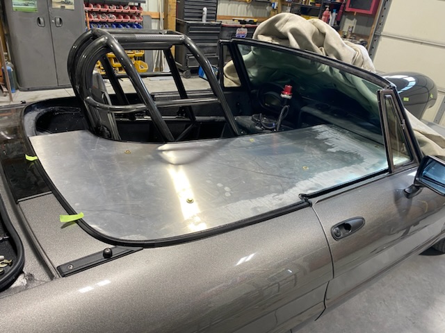

Last few things to do. Made drivers compartment cover and covered it with the same material I used for the door panels
finish putting on a few little parts here and there like the wheelie bars etc. got all the lights working, throw the tag on and away we go.
