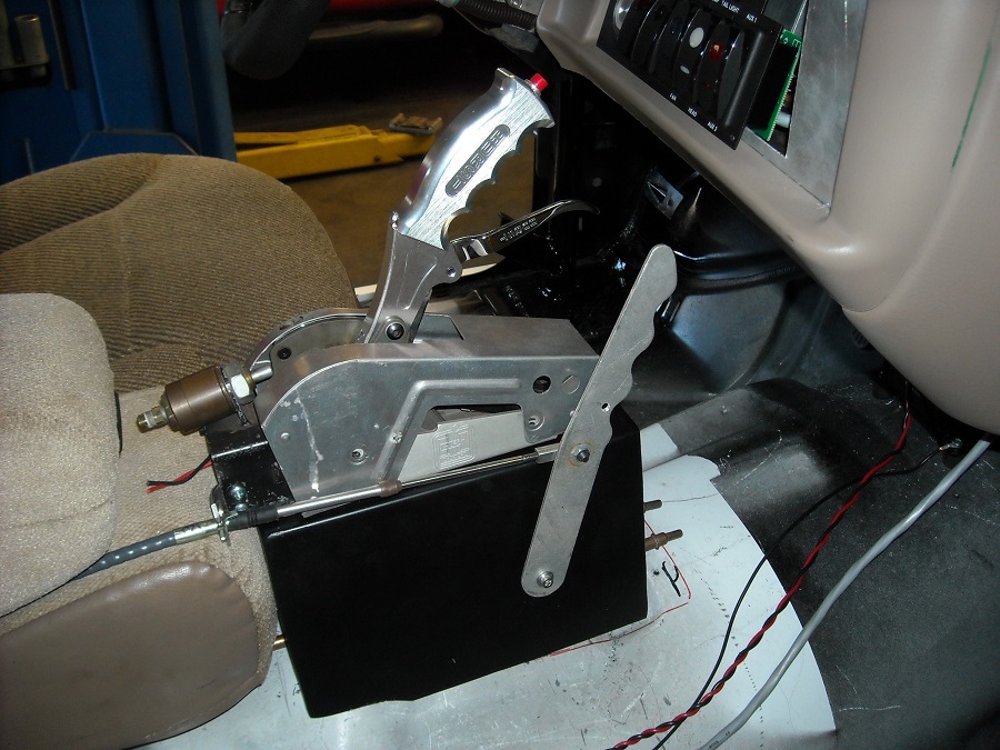

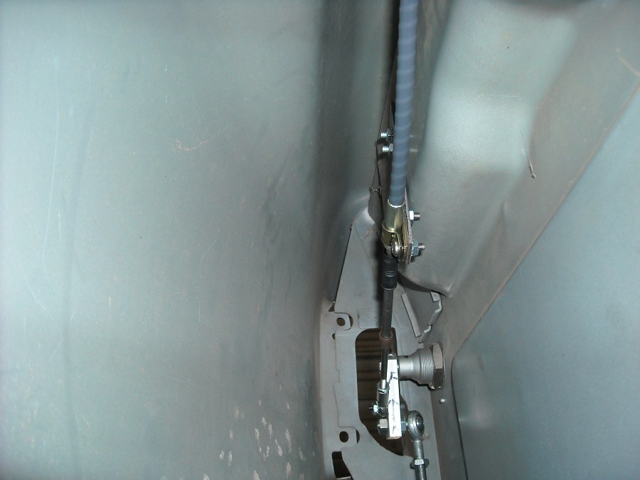

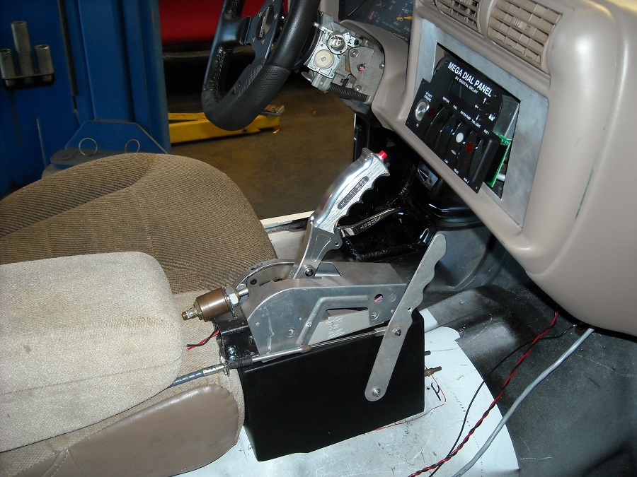

Here are both ends of the master cutoff cable. The "taillight" end has a flat strap tab with clamp and the "shifter" end has a clip like used with a dragster throttle cable.

The drivers handle moves about 1/2 the distance the shifter moves. In the above photos the drivers handle is "off"

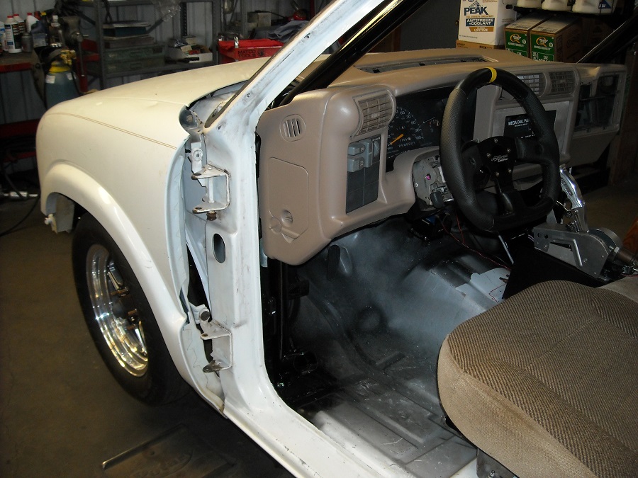

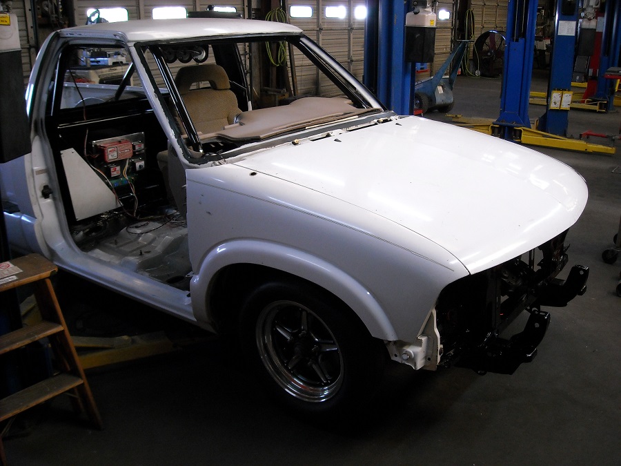

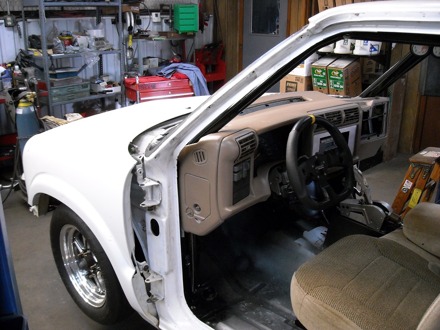

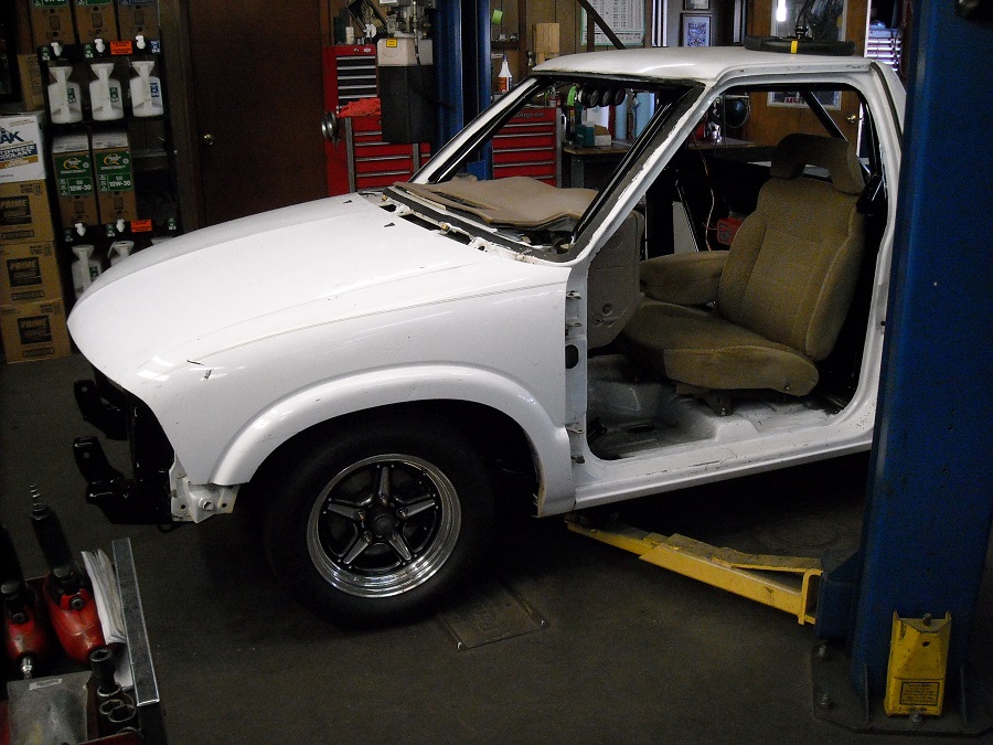

The vision is coming along. Fenders & hood temporary set on for fit check. I wanted to double check where some wiring and some components will be mounted.

Old 02-13-2015, 07:52 PM   #250
Dragsinger
Join Date: Jul 2008
Posts: 1,760
Liked 99 Times in 60 Posts
Default Re: Woodfin's SS GT/TB construction series
Keith,
note that the switch handle is well ahead of the shifter. This buildup is the 4th time I have incorporated the drivers electrical cut off handle in a race car.
After many runs never any remote situation where the switch was accidentally turn off. During a run you are no where near the lever.
However, there have been several times I was strapped in, ready to roll and the power was off. Turning on power is as easy as reaching beyond the shifter and pulling a lever. Very convenient.
Larry Woodfin 471W
