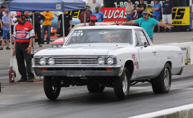

Saturday May 27, 2017
Beech Bend Raceway
Bowling Green, Kentucky

Thanks Doug! Sunday morning brought a first round heads-up race against a .900-under the index car lol...I almost had him.

Looks like it leaves nice and square, Rich. Cool car, for sure. -Al
