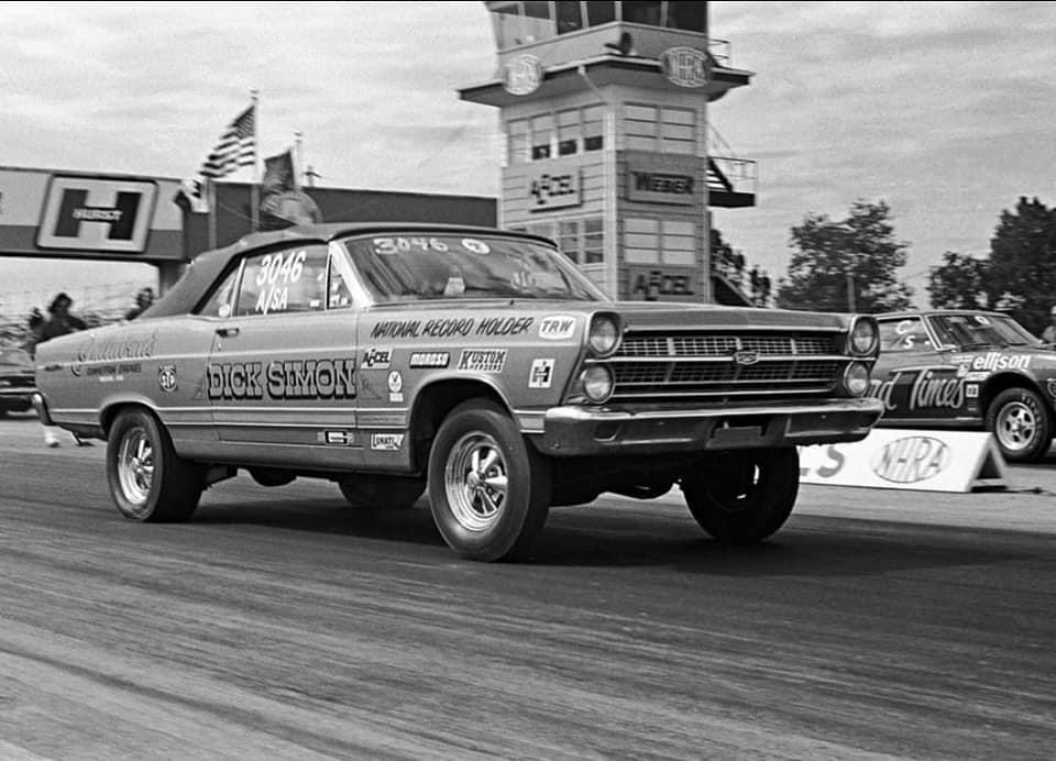

Also....can find ZERO reference to ‘G Gurch’ - World Champ Stock Elim’
Is the name the correct spelling?

Nice find, picture of Simon's 67 Fairlane ragtop in A/SA.
Best likely fit is
1968 A/SA=8.00
1967 Fairlane ragtop, 427/425-8v factored at 463hp (they vary from about 460-463hp back-calculating the factoring) comes out at W/P=8.01.
Perfect fit to class, but so was the 427/410-4v Fairlane/Comet 2door post, and ran the same class A/SA=8.00. And that 4v combo, left unfactored at 410hp, was stronger - lots of wins. But the flat-hood 427-8v was factored too high. The Glass hood 427-8v combo was only factored at 472hp. The cold air was worth more than 472-463=9 hp or even 472-460=12 hp.
The FLAT-hood FACTORED 427-8v wasnt a very competitive combo- I'm not sure if I found any national wins with it. Factored too high at least back then.

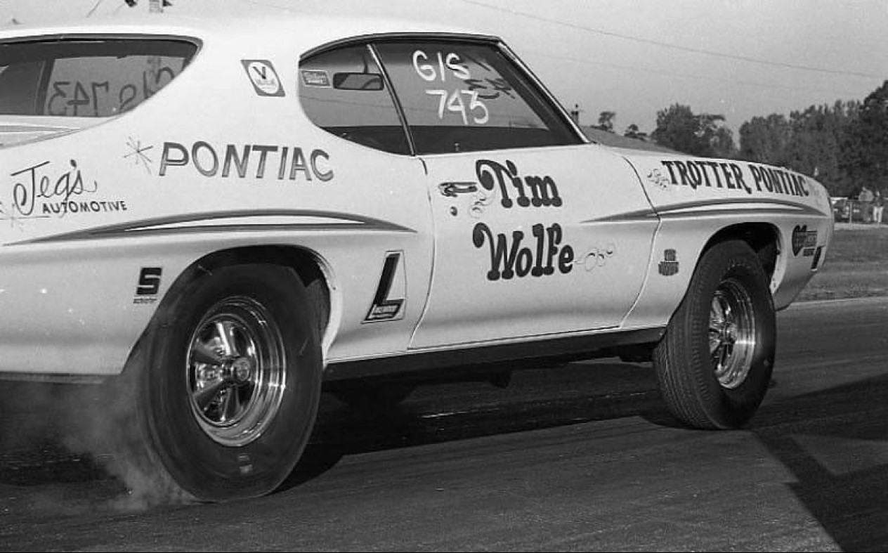

How 'bout if I throw another Wolfe Pontiac racer into the mix. This one is listed as Tim Wolfe. The car has G/S on the window. Looks to be a '70 Judge.
At the moment, that's all I know about the car & driver.
Name:	Tim Wolfe '70 Judge .jpg
