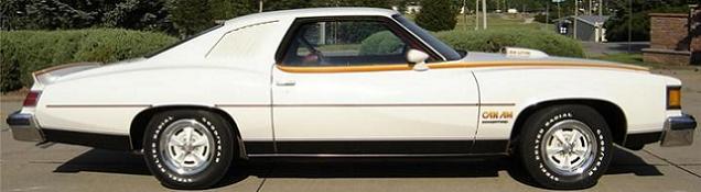

Yeah I just checked the sheet for the '77 W-72 400 cars. I mentioned earlier that the Can Am is the only car that could run an auto behind a '77 W-72. But I checked some online info and discovered that the Can Am never came with a stick. So I took another look at the spec sheet. Here's what it says. "Auto only in Can Am". So, earlier, I took that to mean that the Can Am was the only body in which an auto was legal with that engine.
But what they meant was that the Cam Am was legal only with an auto, and not with a stick. The site I checked said they came only with a TH400, and none were produced with a stick. I'm not real familiar with the Can Am, so I'll do a bit more research on 'em. I do like the looks of 'em, for whatever that's worth.

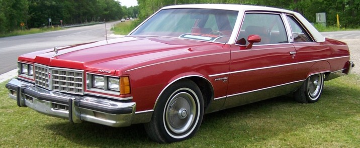

OK, if the online info is correct, here is a '77 base model Bonneville. The one I like for racing is the 2-door with the swept back roof line. Back in the old days we called 'em "fastback" . It appears as if the bottom of the rear window is aprox half way of the rear wheel well. This will give that extra little bit of side vision I mentioned.
The 4-door rear window doesn't go as far back, so there is less side vision. And the Landau roof has much less glass and more metal. So this type roof will give less side vision than the other 2-door roof type.
But there is a problem with these cars. There ain't many left. Most have been crushed long ago. They are not a sporty lookin car like a Bird, so there is just no demand for 'em. So, just finding one of 'em may be tuff. Therefore, I'll expand my possible choices to provide a better chance of finding a suitable car.
