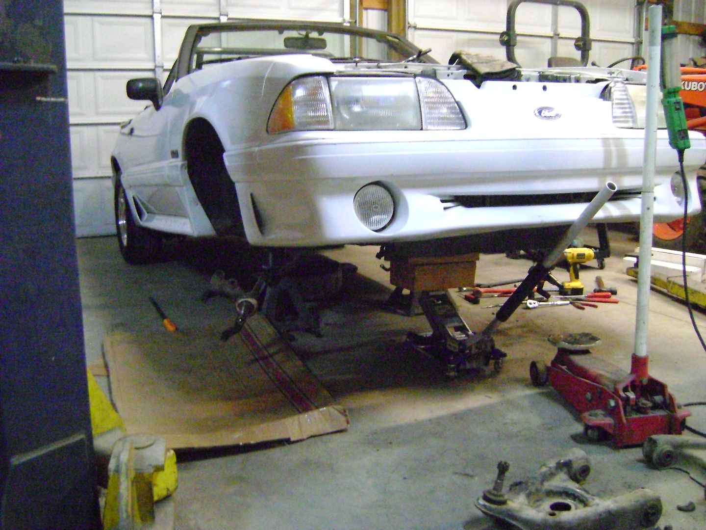

I'm not slacking folks...got the car home this afternoon with the roll bar welding finished.
![]() Busted the front-end apart and I will remove the rubber bushings in the control arms in the morning. Need to locate some ball joints as one of the boots was torn. Once the front is done I can move toward getting that engine out. Btw, the spring compressor was a pita...a floor jack under the other control arm was much quicker/easier. ![]() ![]()
Rich Taylor I/SA - 321 |

Going back together w/ uncut drag springs is a different story, for sure!
I put a set of uncut Eibach drag springs in my 87. I think I used a combination of the compressor and the jack, starting the nut on the balljoint, then lining up the bolt holes in the bushings. It ended up sitting too high. I got greedy and cut 1 1/2 coils off, sat too low. It was a lot easier to get them in, though! I found another set (Both sets were new, unused, bought from guys on The Corral.) and cut 1 coil. The height was good. My car is not an all-out drag car. If it were, I'd be concerned that by cutting the springs, I increased the stiffness too much, reducing the effectiveness of the weight transfer. |

I'll be using the compressor going back in with these 4-cylinder springs...hoping they will be right the first go round. Lots of weight coming off the front of this car...bought a manual rack yesterday which is supposed to be around 30 pounds reduction. Got hijacked today for a Chinese ping pong table assembly from hell...I will be working on the car this Thanksgiving holiday.
