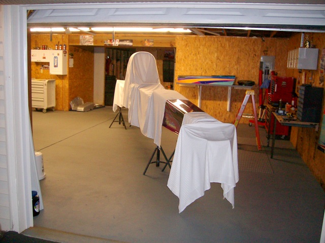

Originally Posted by Ron Brindisi Jr. View Post
Great Point guys... Thanks, I do not need a fire after 2 years on this project!
Did u guys use a 2 pole or 4 pole switch??
Top secret! lol
