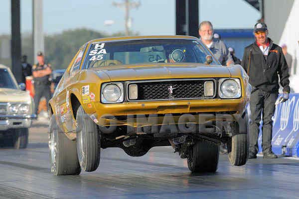

Originally Posted by astikhossw View Post
Doesn't the stock racer in Arkansas with the 73 have to run the motorcraft carb and that car runs well under in G and H.
That Is Verne Buchanan. The only intake & carb in the guide are:
D3ZE-AA, & 11 – 1563x1960/1250xAV

Yea that's the one,Robbieracer you should try to run this combo low compression dish piston,open chamber AA heads ,.481,.490 canshaft and you already have the carb and intake.may have get another hood I don't think you can run ram air with this one.
