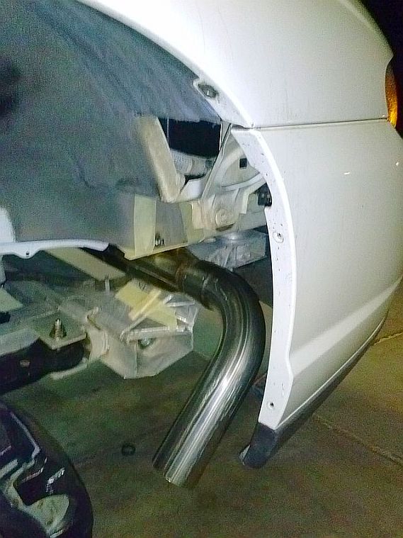

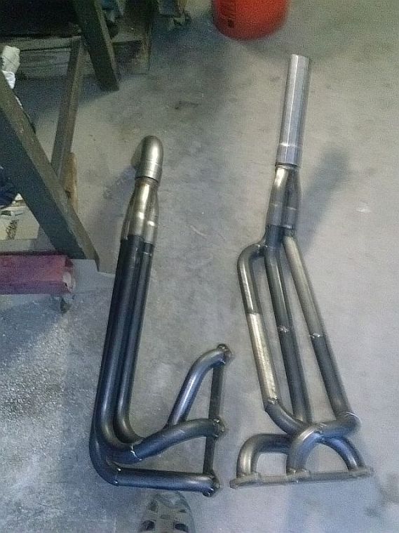

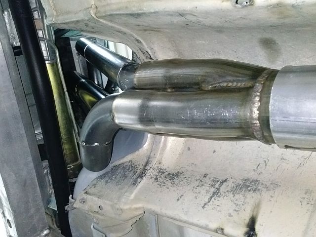

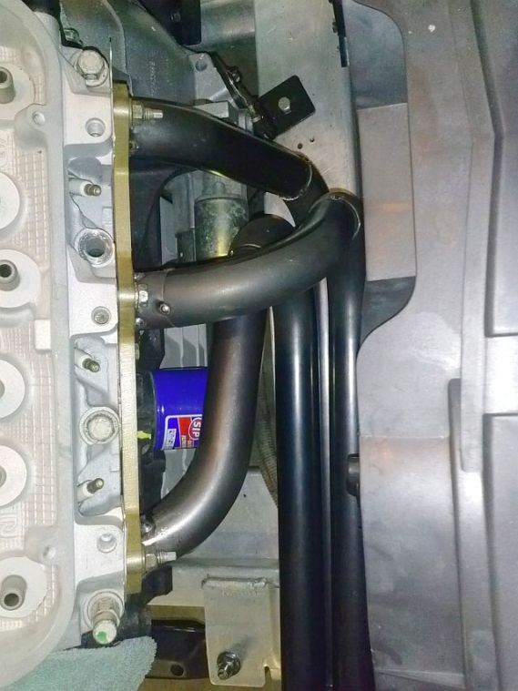

We made the 1, 1/2 , to 1, 5/8 step headers, using pieces from Speedway, and merge collectors off of Ebay. We had a local chassis shop water jet the flanges.
The overall length , basically was determined by the constraints of the front header exiting in the r.f. wheelwell. They are all welded...No tethers!

Awesome pics, thanks Mark. I was trying to figure out how to get equal length in this type of car. I was thinking of adapting full length RWD headers to exit the fenderwell, but was wondering about legality. Your solution is much more elegant, if you can use that word concerning a dime rocket.

Interesting headers Mark. Looking at that last photo howerver, I hope you never pop a head gasket!! Should be good for keeping the tires warm though....
Huh! Never thought of that.
...Been doing them like that since the 80's.
Not too many other good options on some of these things.
I suppose it would be worse for a RWD to grenade a transmission and have the oil go under both drive tires ;-)
