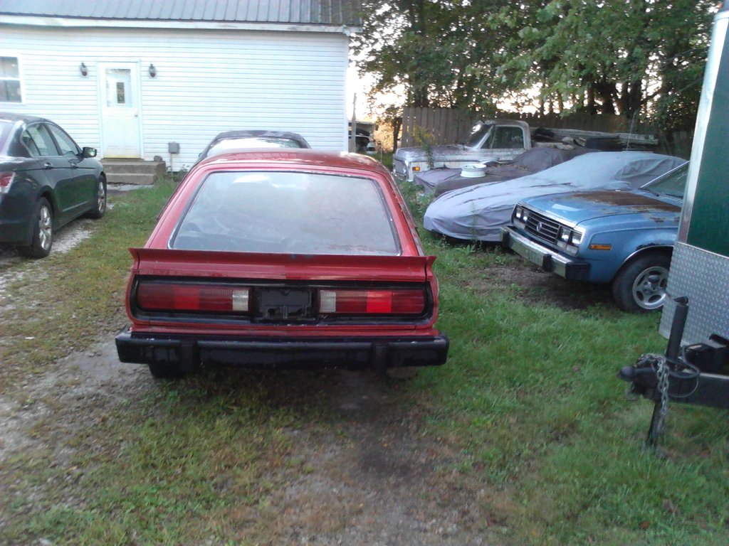

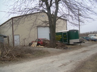

At this point (early Oct as I catch you up), I'm looking at a rusted out piece of junk I'll have to part out. A new body is needed, and I still preferred to go with the Spirit platform rather than switch to something that classes differently, so looked around at what I had in my own stable of cars and saw this 'jewel' that had been sitting in front of the pinball shop since 1993. It's a weather-worn 1982 Spirit GT that was originally a 151 4 cyl 4 speed car, no engine or trans, that had a straight good body, that I had bought back then with the idea of throwing a V8 and an automatic in it and bracket racing it eventually. There was some initial work I did to it right after hauling it home back then, the best part of which was installing an 8 3/4 Chrysler rear end that has the same width as the original tiny AMC rear. The pinball business was getting going good about that time for me, so I shelved the project due to building the business and let the car sit where you see it in the picture. It was still there in the same spot as of October 2015. Man, where do the years go??
Now then: is it rotten underneath like the '80 Spirit was too? Going to have to pull this one out and take a full assessment.
On to Plan B!

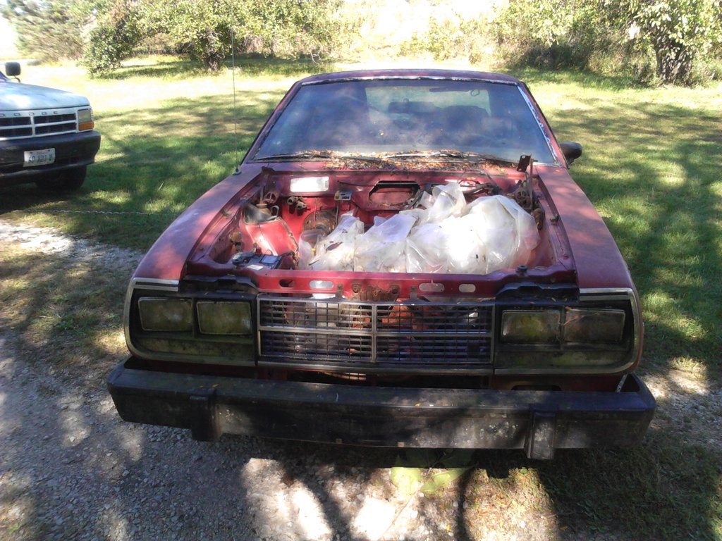

Default Re: Resurrecting the Rambler
(Early October now)

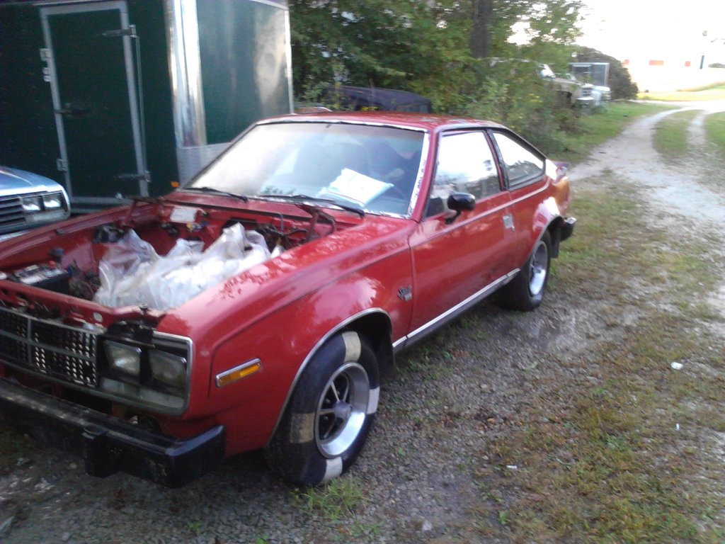

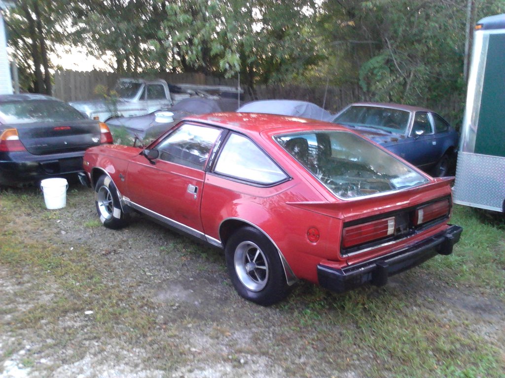

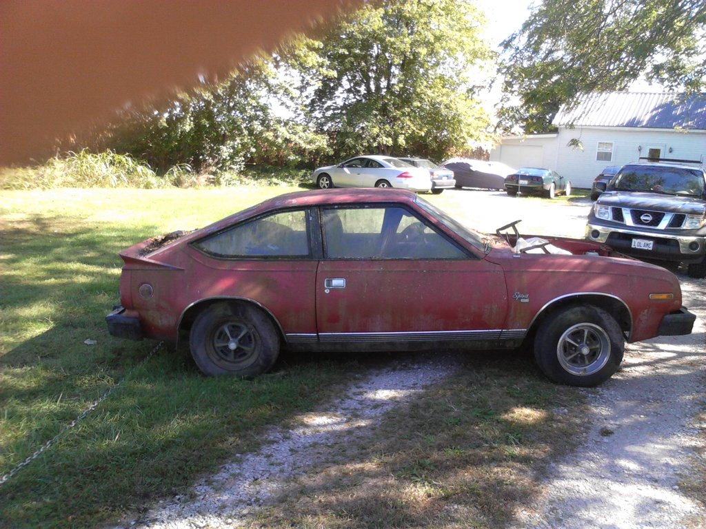

So we clear out the jungle brush and half a ton of assorted junk that got piled up behind this 82 car, and try to avoid ticking off the inhabitants of a nearby hornet nest, ( how fitting is that? Hornets at an AMC collectors house?) . Aired up the rotted tires, hooked up a chain to the resident 4wd Dakota and yanked her out from around the shade tree.
And her she is in all her leaf-encrusted moldy glory. The remains of a dud 350 Chevy engine is parked in the engine bay underneath the plastic.
Time to jack this one up and take a look underneath at everything. Hopefully not a repeat of Plan A.

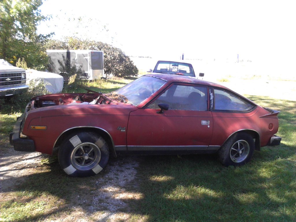

First bath in probably 25 years, what a change! Outside now looking much better, got to get underneath and peck on a few places next.
