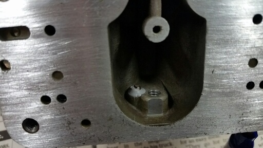

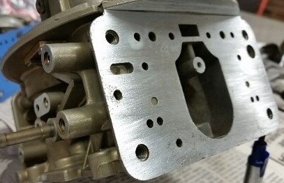

Ok, I have finally found the real issue here. I did end up re-surfacing the bottom of the body and that is sealed up well. My original thought was to take out the power valve, I never tried that. So after looking at the baseplate, a lightbulb flickered on. First picture shows how I originally had it put together, second one is the fix.

Old 06-07-2019, 09:52 AM   #16
Bobby DiDomenico
Join Date: Jun 2002
Posts: 924
Likes: 106
Liked 101 Times in 52 Posts
Default Re: Fuel in intake
So changing from a 4 hole to a open plenum manifold gasket solved your issue?
It made a huge difference in the idle. from what I see, the first gasket blocked the source of manifold vacuum that feeds the PV. I think the PV was opening during idle. At least that is my new theory. Spark plugs are now dry as well.

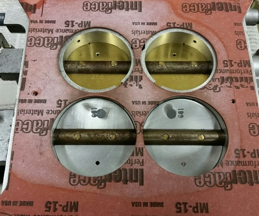

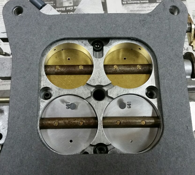

I think I've fixed this issue. I had thought the PV was opening because of the base gaskets. Well I found that fuel was collecting in the vacuum space in the body behind the PV, and was being pulled in thru the vacuum port thru the baseplate. Gaskets were leaking bad on both ends. I re-surfaced both ends of the body where the fuel bowls go. Amazing how bad a shape they were in once I started working on them. I will never build a carb without doing this. The vacuum space is dry on both ends now and spark plugs are also dry. Still a little fuel in the intake, not going to worry any more about that. I'll see how it runs. I won't mention who built this carb, but he was recommended in a thread I started here. Stevie Wonder could have diagnosed this problem. And thanks to all that helped. On to the next problem......
ID:	50228   Click image for larger version
