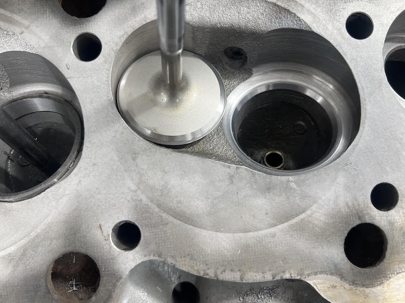

Here's a better picture of the head before work was started. Notice both valves are sunk quite a bit. I checked all the valve heights, and checked PV clearance, CC the chamber 100.5. So according to my calculations its short on compression.

Seats installed.

Setting height, there's 60 now with a 2.065 valve BBC.............
For us crayon eaters in the class, can you explain the pictures in better detail please?
I understand you want all the valve heads the same height in the chamber so with sunk seats, you're replacing the seats and getting all the heads to sit at the same height...got it. But in the picture where you say you have .060, you're measuring from the deck height and what? I can't see but I'm assuming you're going to the top of the seat you installed?
Once all valves are sitting in the same place in the chamber, the cc's should be closer to start with...am I on the same page or in left field?
