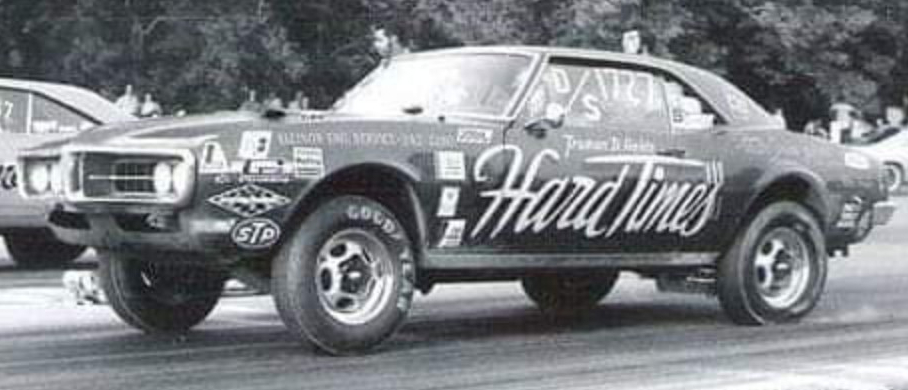

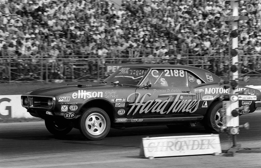

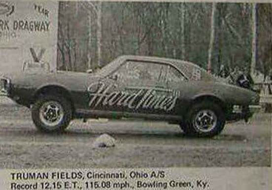

"...???? 1972..."
Yeah, I think I posted a pic of Truman Fields running A/S @ the Summer Nats, in '72. So, that was a special year. Seems that Stock had sort of "Pure Stock" rules that year. I suppose the weight breaks were different, which caused Truman's Bird to run A/S. He even set an A/S record.
http://classracer.com/classforum/showthread.php?t=51198

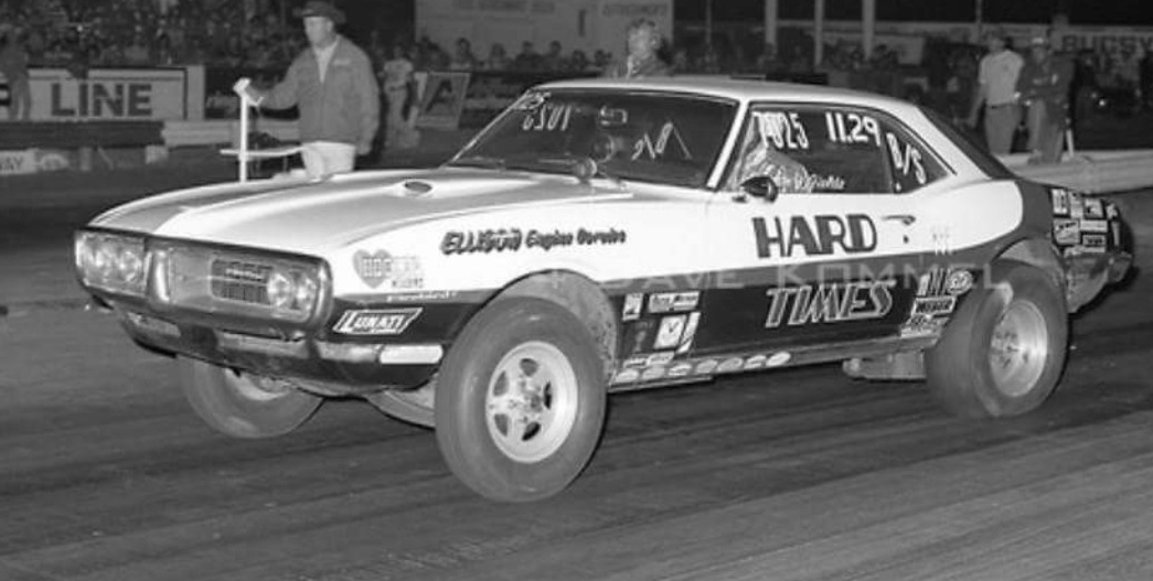

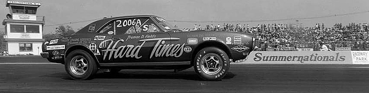

Then, '73 was the year Truman won Stock @ Indy, running C/S. Then, in '77, Mike McKinney won Stock @ Indy, running that same car, in B/S. Lots of rules changes back in those days.

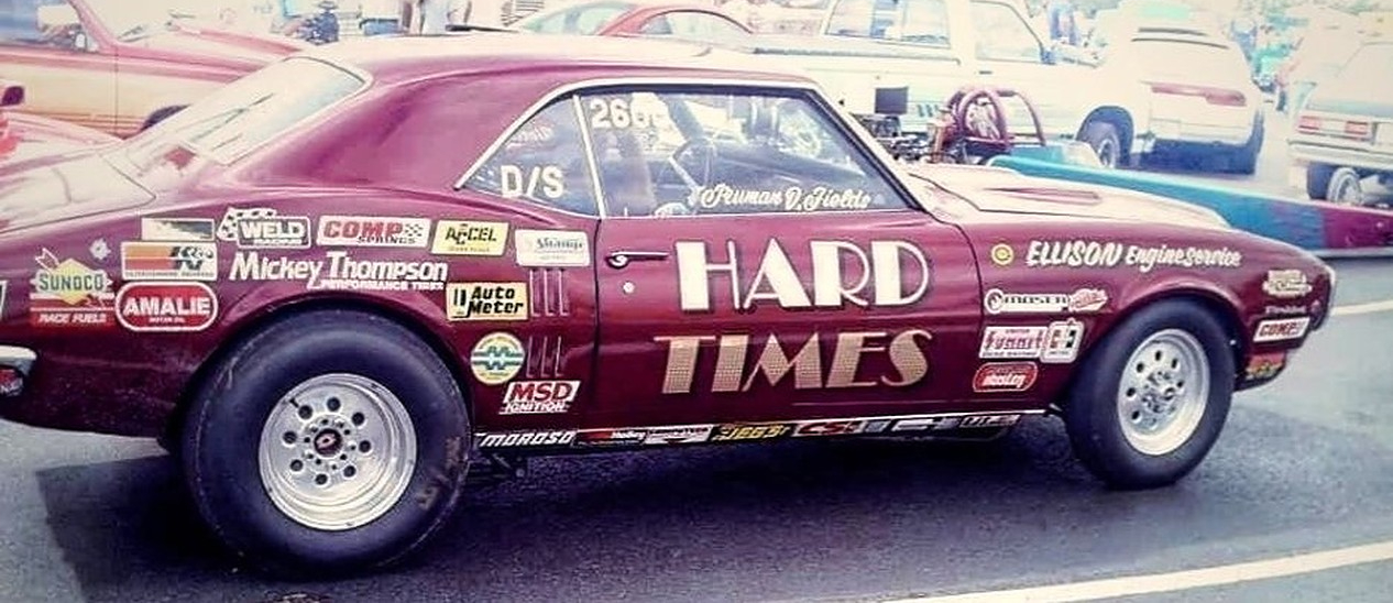

Pic #7 shows Truman running in D/S. Don't know what year that was.
He ran '68 Birds with several different paint schemes. Pic #8 shows one of 'em, with B/S on it. Also have a pic of it that color, running C/S.
Pic #9 shows a Burgundy color he ran, in D/S. So, these pics show Truman Birds in 3 color schemes & 4 different classes. He also moved several times, as noted by the different perm numbers.

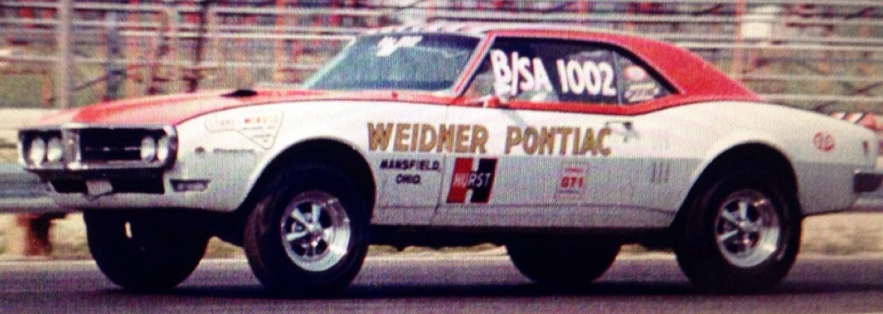

can't prove it was or wasn't

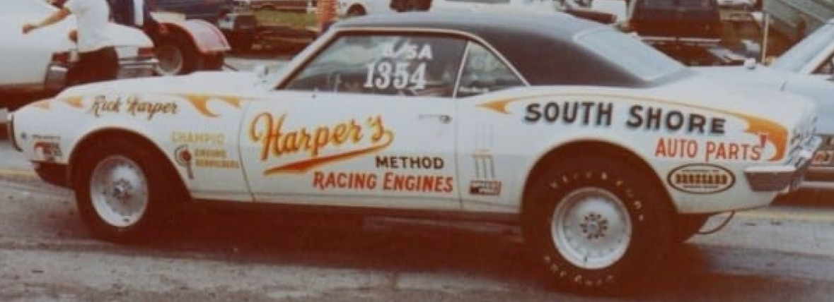

Name:	1 - B-SA .jpg
ID:	61110   Click image for larger version
Name:	2 - B-S '68 .jpg
ID:	61111   Click image for larger version
Name:	3 - Weidner '68 .jpg
