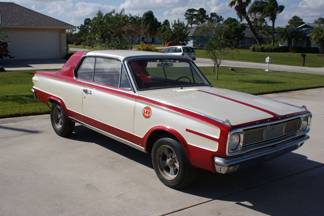

This is Ted Spehar's old Politician race car as it is today.
