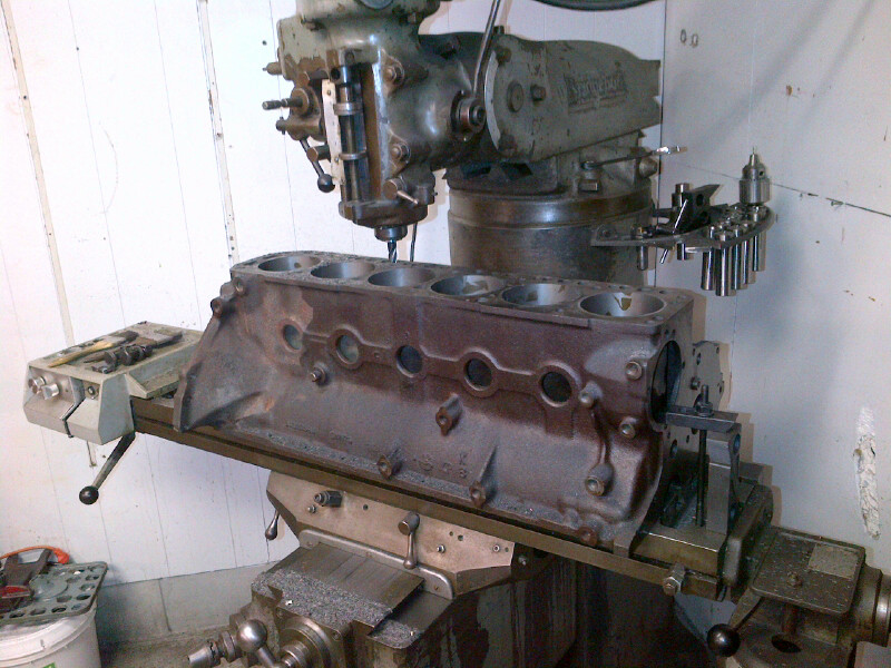

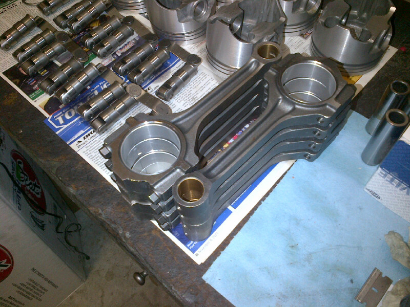

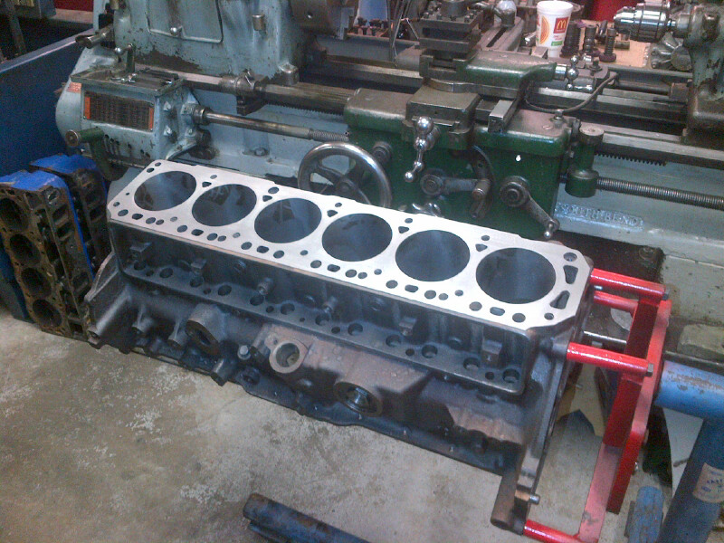

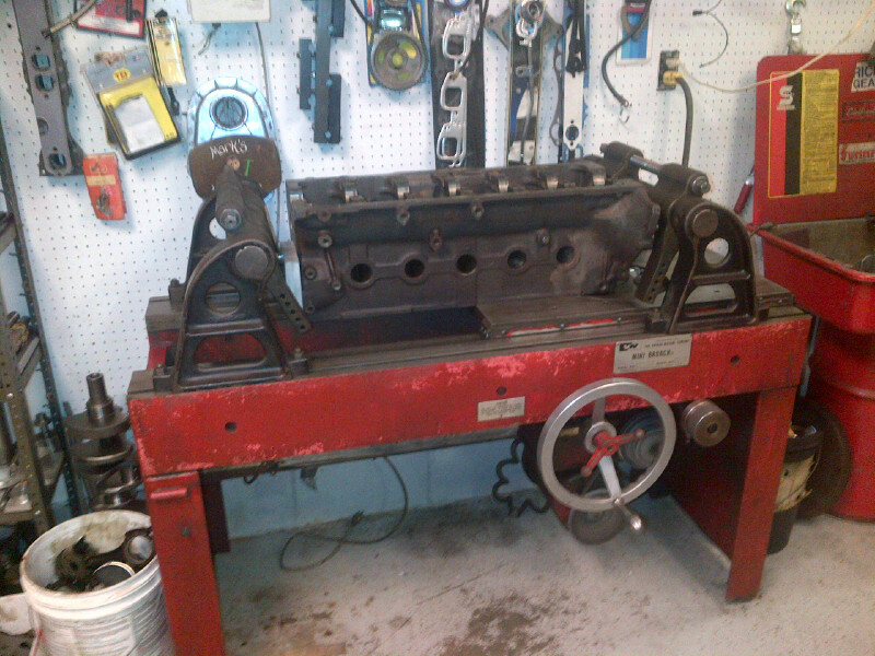

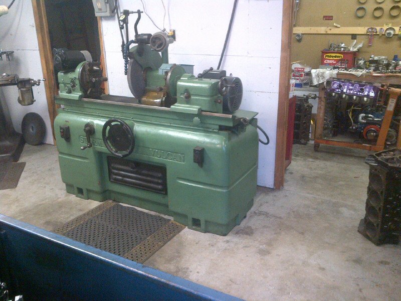

Couple of new pics from last couple weeks up to today.. Need to get my ***** in gear if we are so make our goal to the gators.. Cutting the tops of the sleeves on the Bridgeport, Made a little fixture and final decked it today! Hurray! Might go out in the garage tonight and set up the final bore operation 4.00. Picked up this little Jewel (crank grinder) this past Thursday at an auction. I think I'm the only one in the neighborhood with one! 5.4 "stock" Triton-mod-motor rods ready to go!

rods..
