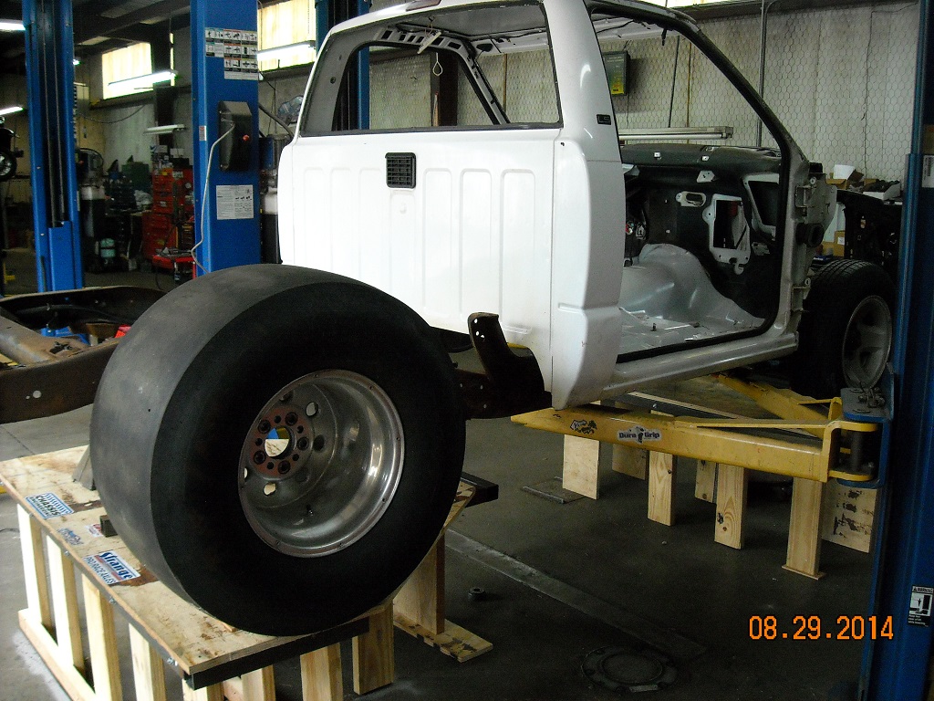

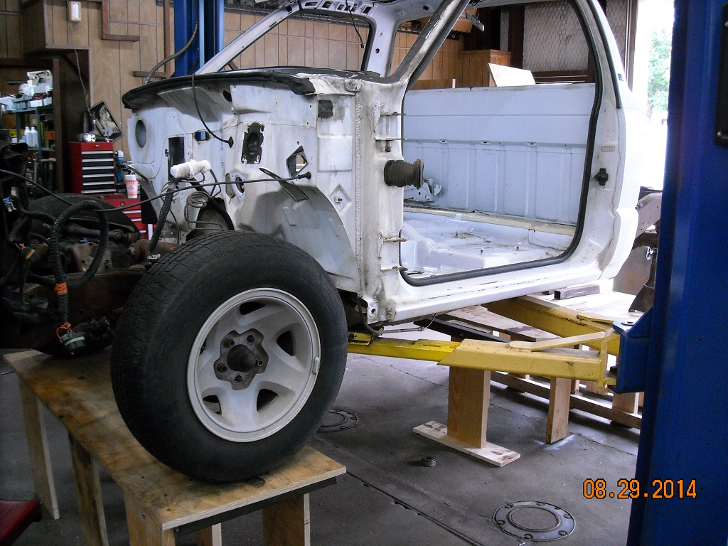

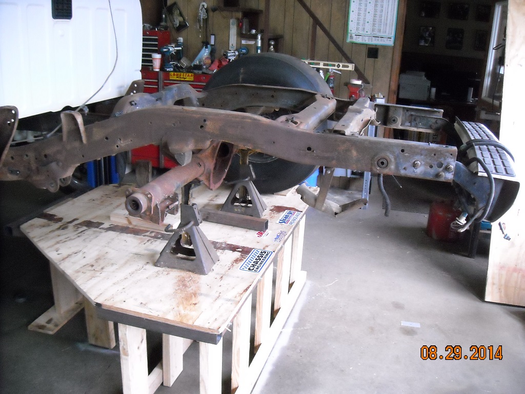

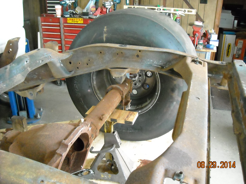

Saturday morning, on the chassis tables. We can begin to see the rear section frame mods that will be required. Next week will begin the four link and crossmember mock up. Also note the bare 12 bolt housing that will be narrowed and braced.

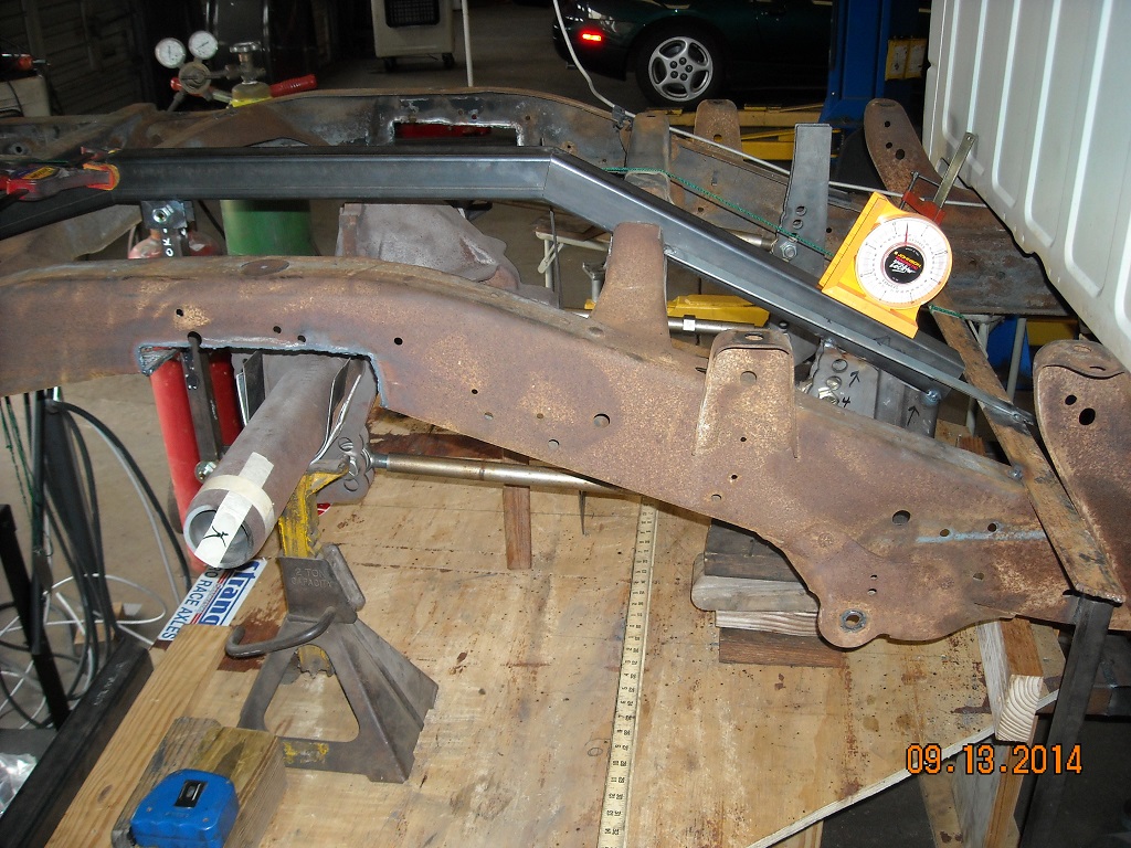

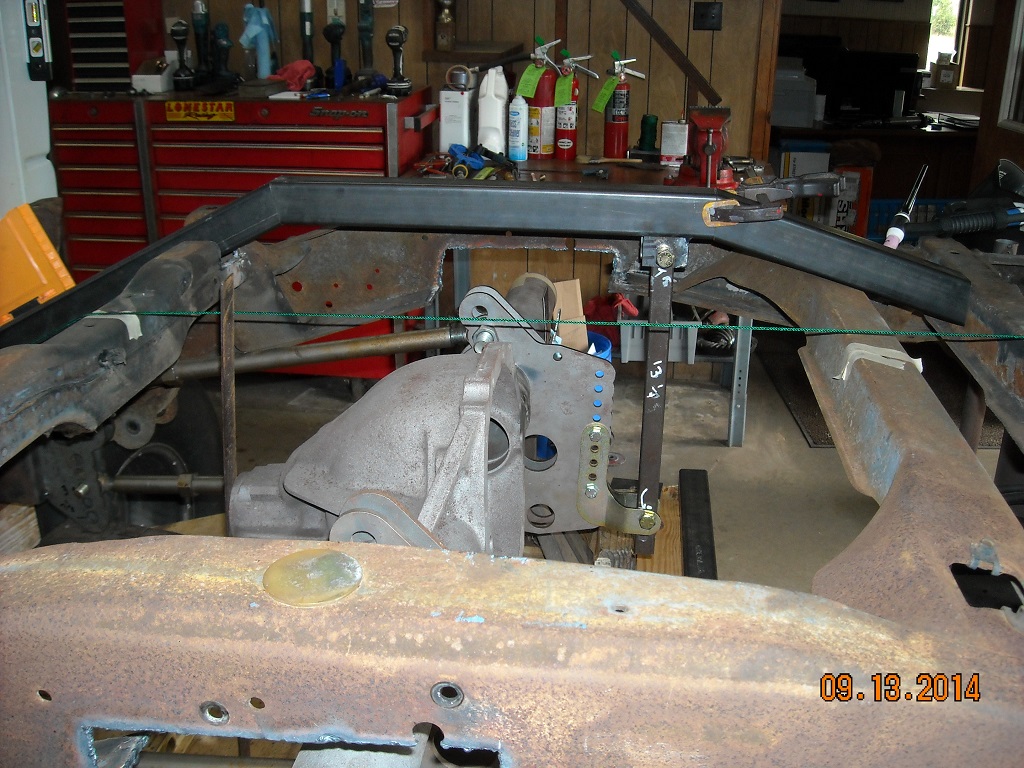

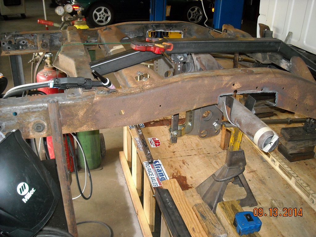

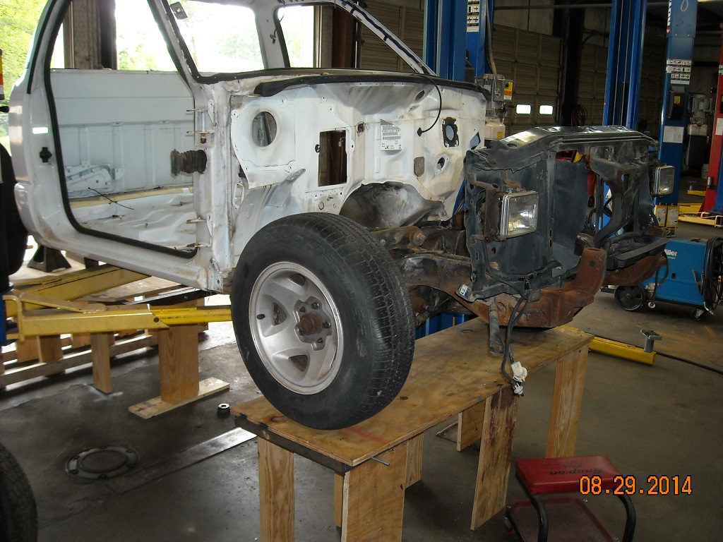

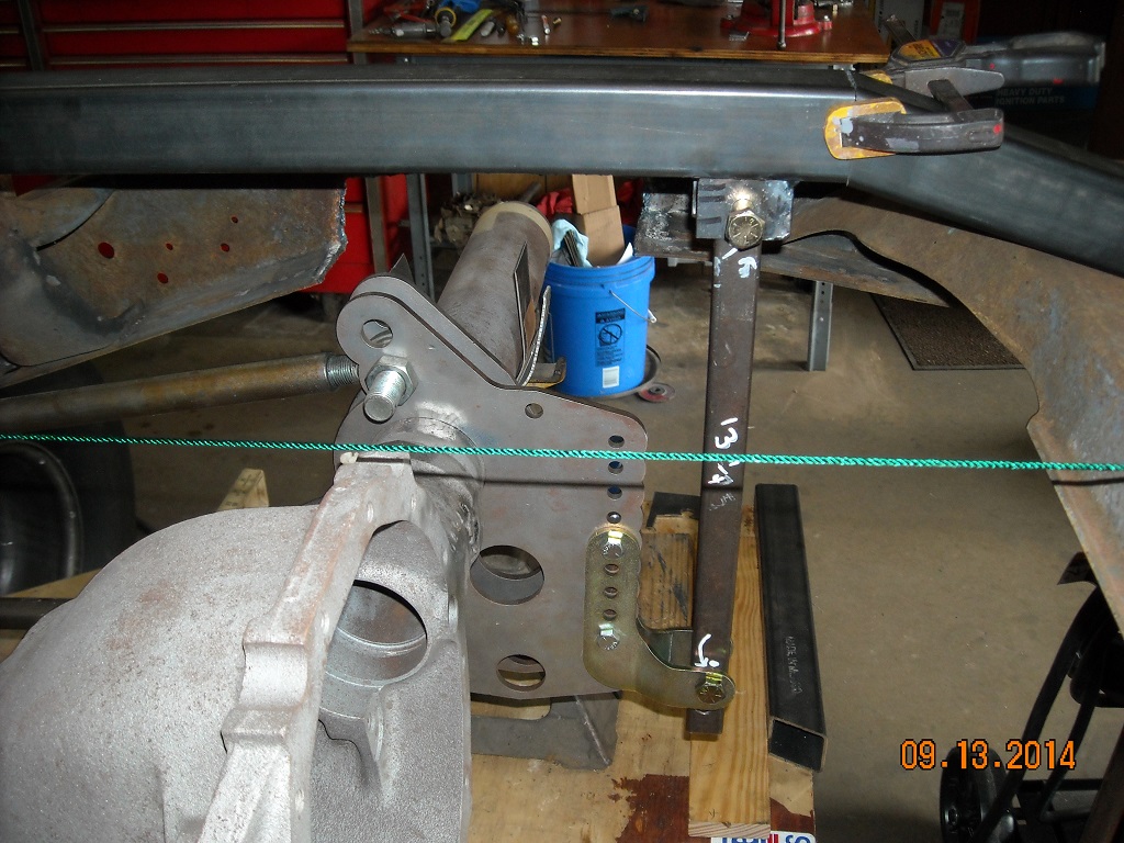

In the first post about this project I mentioned it will be an in house, shop built package. So far, so good, check the new right side frame mock up.
The four link front upright piece is 3 x 2 x .125 tubing. The upper rails are 2 x 2 x .125. New rails are tacked and fit well. Next week will complete the same frame work on left side. Coming soon, anti-roll bar crossmember and hardware. Plus front crossmember between forward four link brackets. The new frame is 23" outside to outside. [8 1/2" in-board of the factory frame on each side] This allows as large as a 32 x 14 but I plan to run a 31.5 x 13.5 M/T radial. There will be a crossmember between the shock mounts and that is also were the roll bar rear struts will attach. Good progress and more soon.
Larry Woodfin 471W |

In the photos the factory frame sides are still in place. Once all new frame tubing and crossmembers are in place and final welded the original frame sides will be cut off. This method uses the stock frame as a building jig and is a big help with aligning everything.
It is not obvious in the photos, I have four pieces of "outrigger" tubing welding to the original frame down to the floor. In addition, the front crossmember is blocked at ride height. The truck is level and square and plum on all planes. Also, the front spring are removed to allowing setting ride height on the construction tables.
