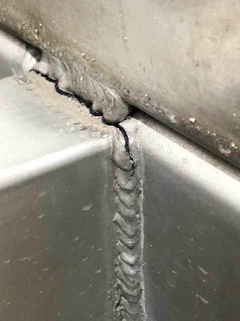

Since I doubt they will repair the trailer or replace it, and in the event you want to keep it, you can do a structural repair in the same fashion as done on airplanes.
You can use 2024 structural aluminum angle extrusion, cut it to the proper width and attach it with Cherry MaxiBolt rivets or Huck Blind Bolts.
You can get the extrusion from Aircraft Spruce:
https://www.aircraftspruce.com/catal.../alumangle.php
For the Cherry MaxiBolt and Huck Blind Bolts eBay is the best place to get them. You need to determine the diameter of the hole you are going to dril and thickness of the area you are going to join to choose the proper part number. They also require a specific pneumatic gun to pull them that you can also get used on eBay and resell later. Nevertheless, this type of repair will last as long as the trailer.
If you want to read more about this type of repair, the FAA has available as a free download the aircraft mechanics manuals. Great source of information for sheet metal, structural repairs, electrical and plumbing. It is a large pdf file. Chapter 4 of the manual covers structural and sheet metal repairs.

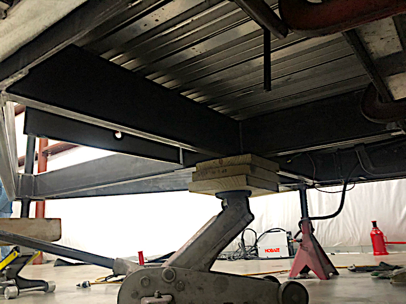

Yes. SSDIV6. We are going to repair. Have no choice
We have the tongue pulled back level.That is why
the gap is big in photo. We was going to weld cracks
First. Then double up the with tubing or like you suggested
Thanks

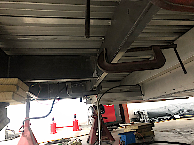

Just an update on the trailer. Just in case anybody else
has the same problem. We cut out the aluminum tongue
A-frame . We built a replacement out of 2x6 steel tubing
and bolted the A-frame to the trailers frame rails.
Just have to paint now but better than what we started
with.
