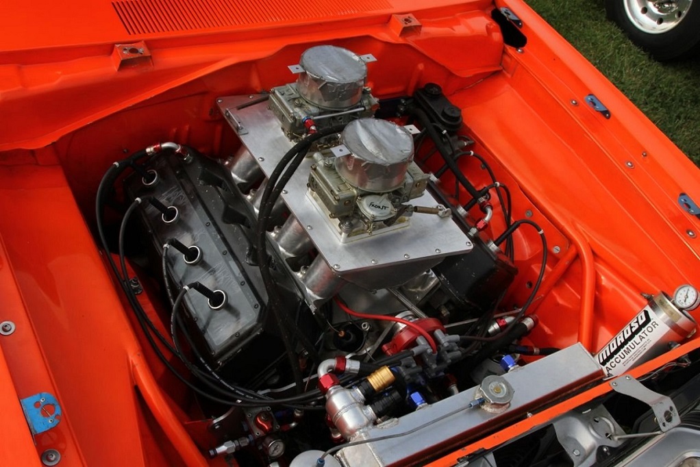

Westcott power in the Comella Dart 2015 according to the Hemi Shootout site.

Cool valve covers. Are the removable sections around the plugs see thru? Great for quick inspection of springs, push rod cups,rockers etc which are so stressed in these engines which see 9500. Would speed up pre-start up lubrication routine as well.

The see through parts are not removable, at least easily. There are 12 screw plus O rings. The racer still removes the whole cover for inspection and valve adjustment, spring replacement, etc.

Great picture!
Check out he removable section on the inner pannel. What a great idea to get at hedder bolts when working . Wish I had thought of it as hedders and there bolts were a bitch to get to when replacing a head or whole engine. Bet this cuts off a lot of time in the process

Before the SS/AH guys fire up they're cars first thing of the day, are they pulling the covers & lubing the valve train before they fire them up?
I see Chuck has an accumulator. Are all the guys using this for pre lubing the valve train before fire up? Or, just for bearing oiling?
This is where I put mine
liteweight
