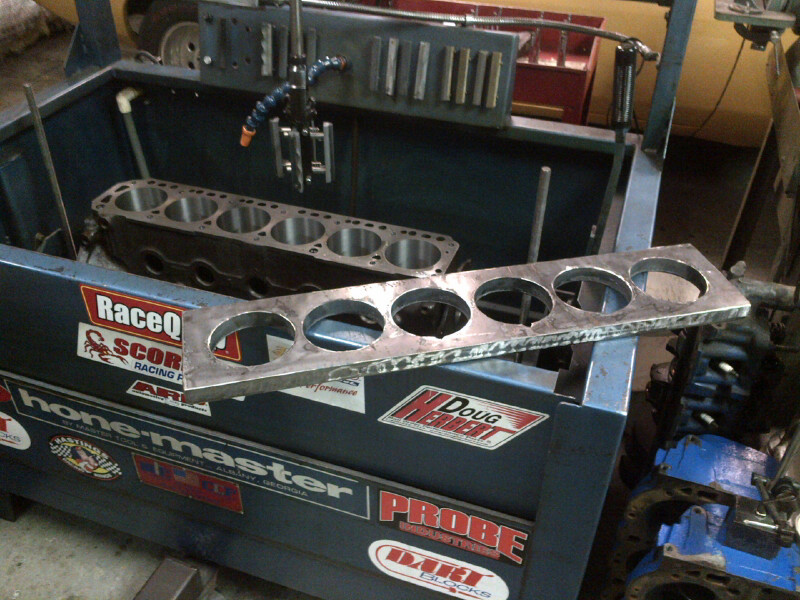

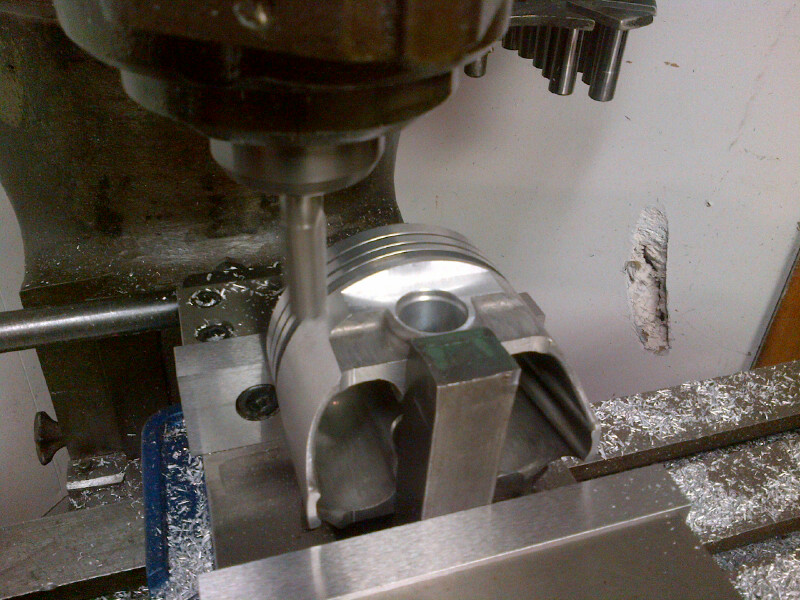

Well the holidays are here and progress has slowed down some. Was out in the garage last night for a couple hours trying to lighten up these lead slugs a little more. down to 600g. flat. still real heavy by today's stds., but it is what it is. I think I can get another 15-20g's out of the pin though! Block is sitting in my manual labor hone, LOL. waiting for me to finish the home-made tq. plate up. Torched it out today, as you can see the rough shape, a couple more evenings on the mill and I'll have all the head bolt holes in and surface it. Made it out of 1-1/2 thick A-36. Maybe get block finally finish honed by the weekend if I can complete the torque plate between all the family Christmas festivities. Merry Christmas to all board members!!

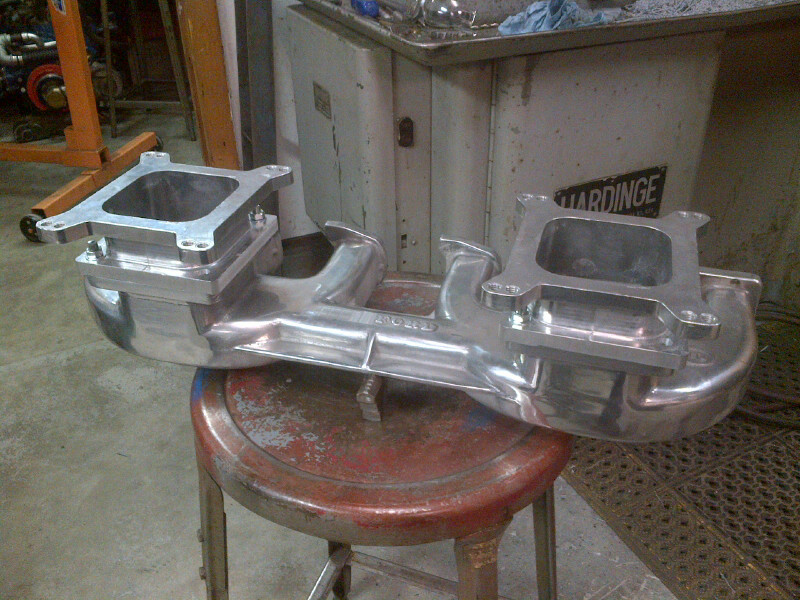

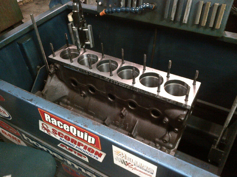

Thanks! I just started on the cylinder Head, I actually have 3-cores. I will do one the best I can myself, then when I get a few extra bucks this spring I'm going to send another out to Sissel or Valley Cyl. head for a pro-port job and compare results. Finally finished the TQ plate, got the carb adapters on the intake. Going tomorrow to use a buddy's flow bench for some pre-lim data. Also picked up 2-donated holley 500 cfm 2-bbls. Going to try them on the dyno first, along with 2-450 mech. sec. 4-bbls- than finally the 2-660 center squirts. Project moving a little slow at the moment, but nevertheless is moving..
