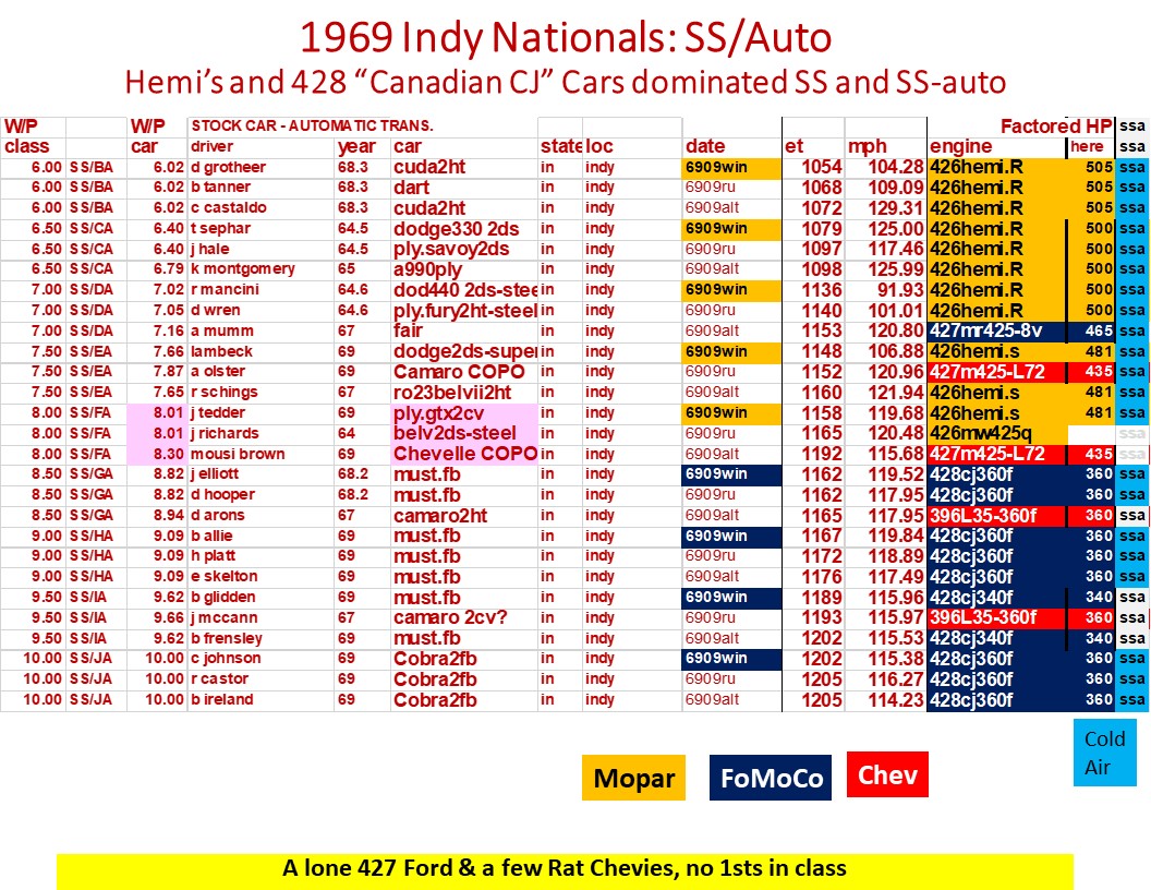

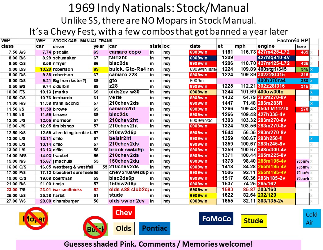

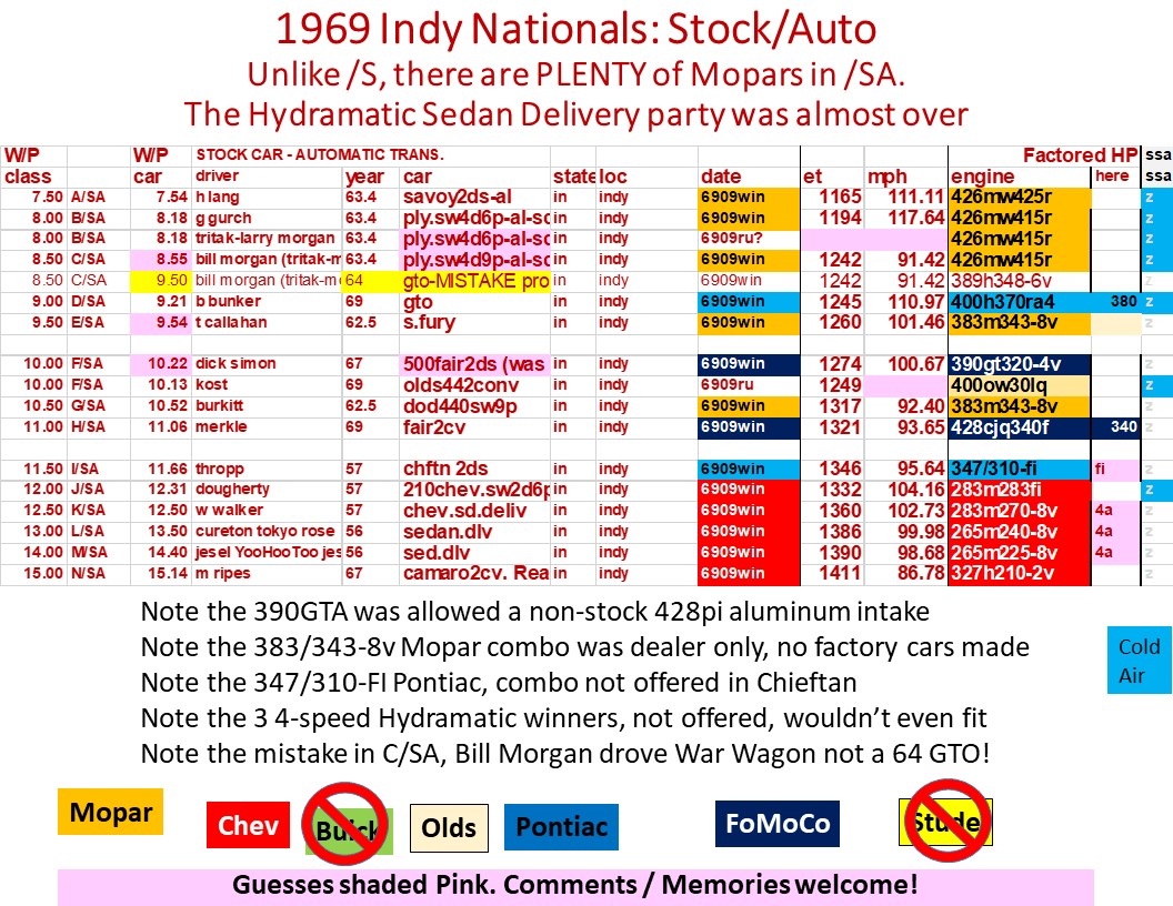

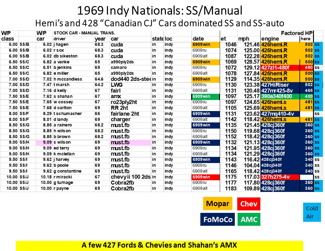

Originally Posted by Rat Patrol View Post
DC - Do you have any results lists for 69? I’m just starting to write up the page.
Yes, of various pedigree. I'll dig some out.
I have original Pomona sheets somewhere, have to dig em out.
I have a narrative from drag news for 69 Indy, no results sheets. Here are the files I built from that, including the usual few guesses in pink, but also a couple that are just plain listed wrong, which is also all too common.
For example C/SA=8.50 Morgan shows a GTO. No GTO ever ran up that high. Morgan had a 63 Max Wedge wagon.
D/S=9.00 lists Robertson in a 69 Buick but again no such combo. Could be a RamAir4 or a 67 Z28.
SuperStock narrative is really unusual. They list:
*Winner
*1st Alternate (I call runner up or RU)
*2nd Alternate (I call ALT)
I've never seen one written up like that, but there we are.
I was surprised to see a 64 LWG Galaxie in there as RU as late as 1969.
This was the last year the 64s could run in SS due to the 5-year rule, and the 63s were already gone from SS.

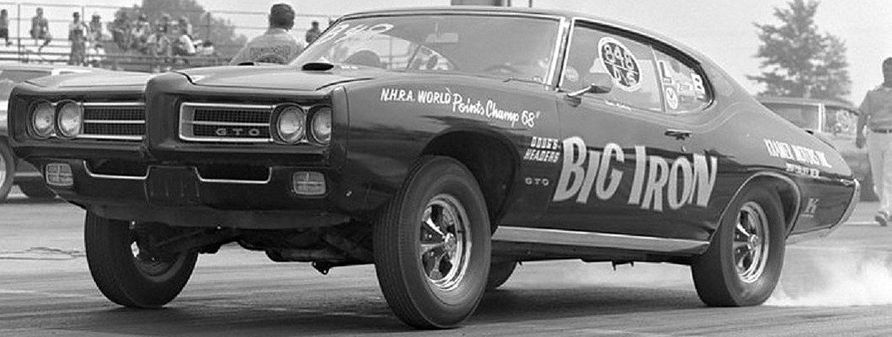

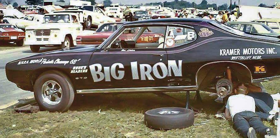

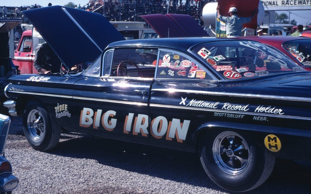

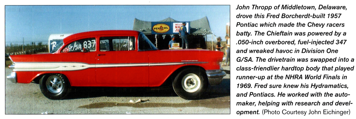

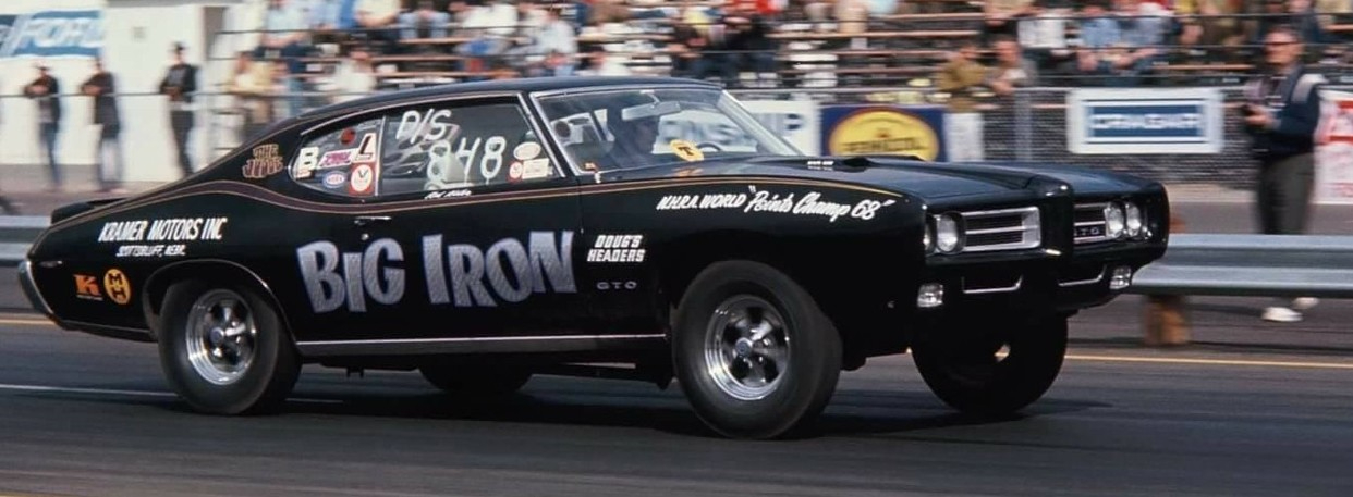

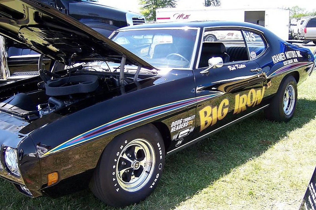

Since I'm always lookin for the Pontiacs, I couldn't help but notice that the new RAIV powered Pontiacs won D/S & D/SA.
Rod Kister had won the Stock points championship in '68, with his big '60 Pontiac rec holder, also named "Big Iron". Then the '69 Judge was followed by a '70 Judge Big Iron.
Not familiar with the other driver's name.

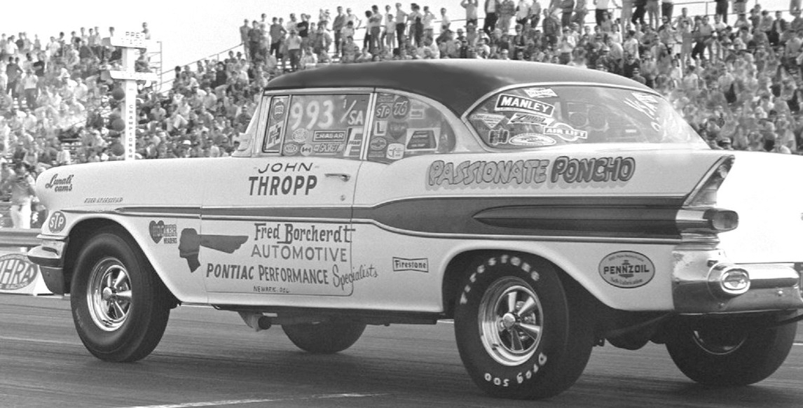

John Thropp ran at least 2 different '57 Pontiac bodies.
