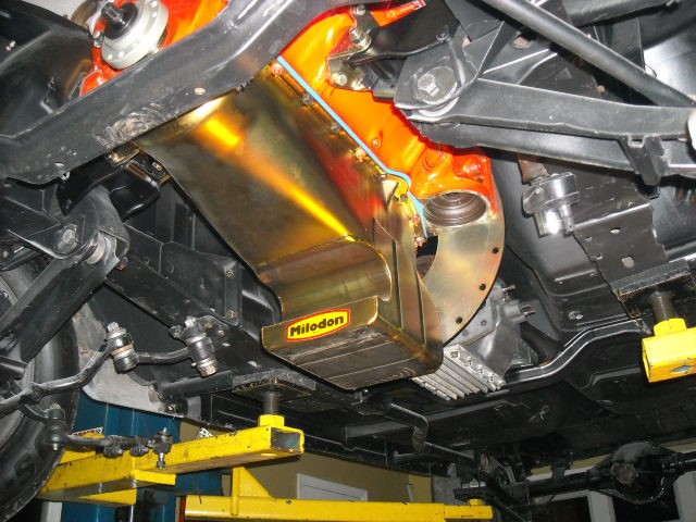

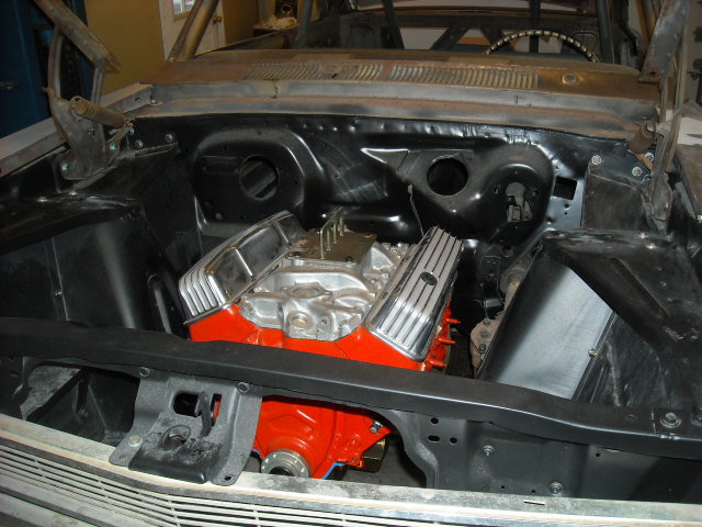

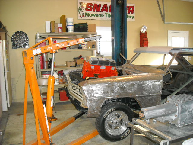

Over Thanksgiving I retrieved the car from my buddy's shop with no more done on it than in the last pics I posted. I've talked with Dave Cech and reserved my spot in line with him to do the body and paint...should be taking it to him in the next couple weeks. I got a great deal on a clutch and flywheel here on Classracer, and bought a Quicktime bellhousing from Tim at the Car Shop. I thought now would be as good a time as any to drop the motor in for a test fit and make sure everything was going to line up right, so that's what I did today.........

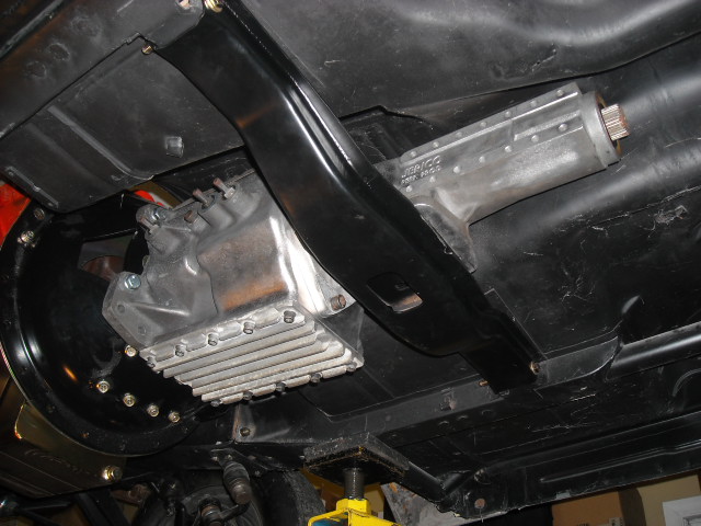

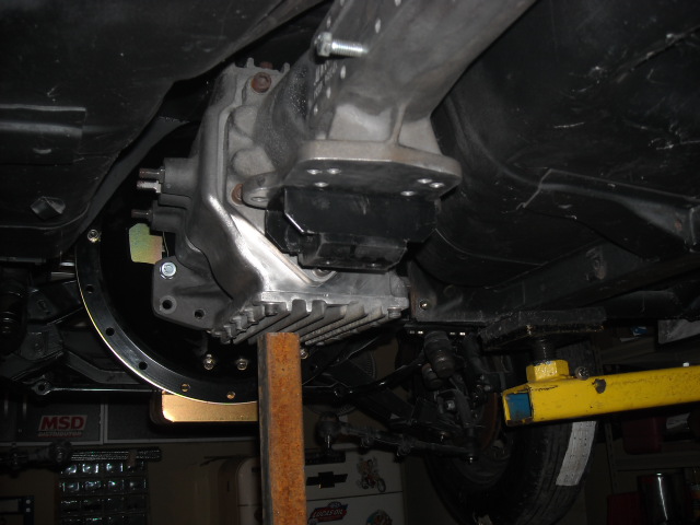

I lost my innocence tonight - I've been messing with cars for over 20 years now, but up until a couple hours ago had never installed a manual transmission! Good thing that Jerico is light! I should've asked Santa for a tranny jack...I'm sore in places I didn't know existed.

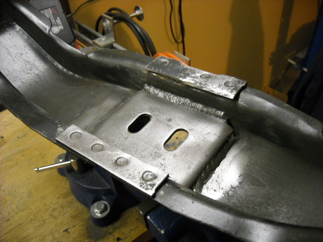

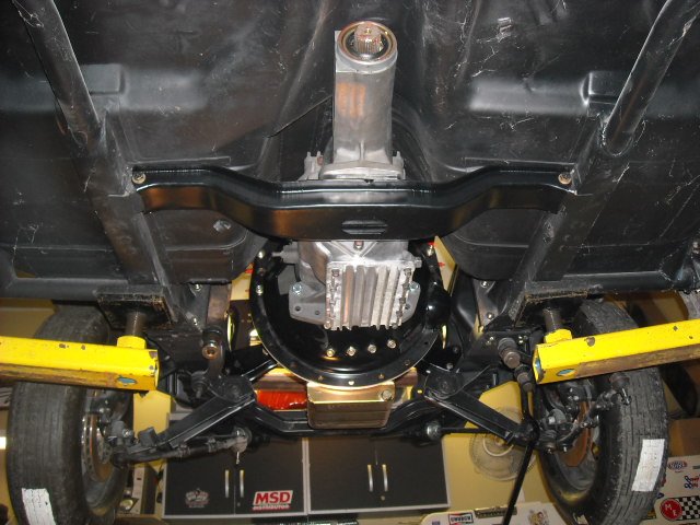

One more detail I thought I'd post about - the crossmember. The Jerico is around 3/4" thicker than a PG from the pad where the mount attaches, to the center of the output shaft. After wasting a bunch of time trying to design a thinner mount, I decided to just modify the crossmember. I cut out the piece in the center that the mount bolts to, lowered it down into the crossmember, and welded it back in. Stock rubber mount, bickety-bam! Next up....giant hole in the floor for the shifter.
