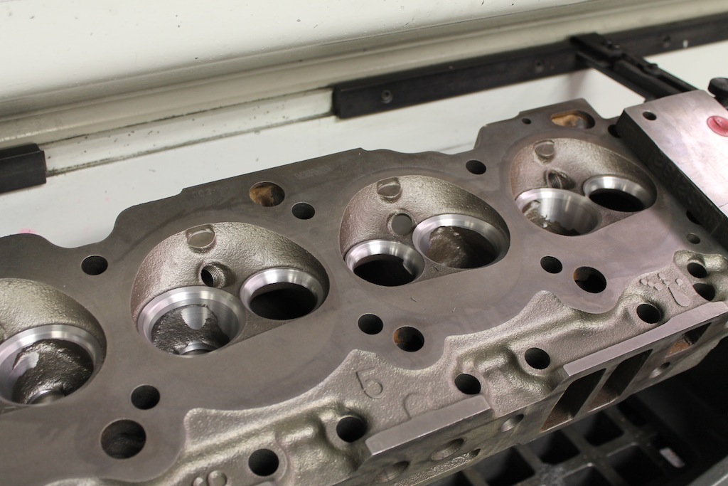

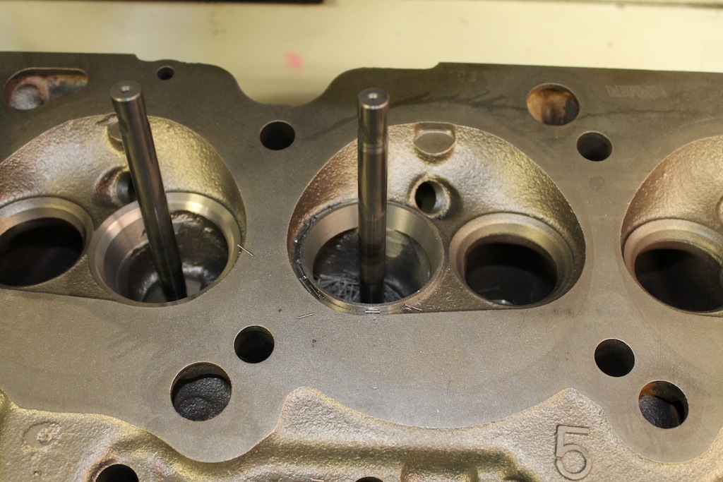

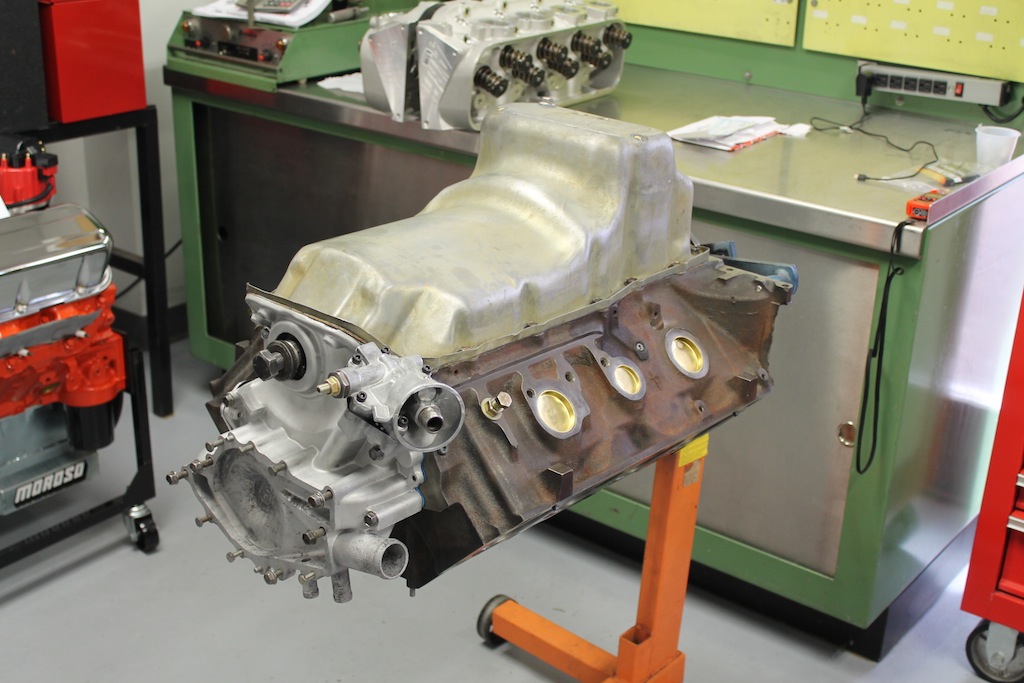

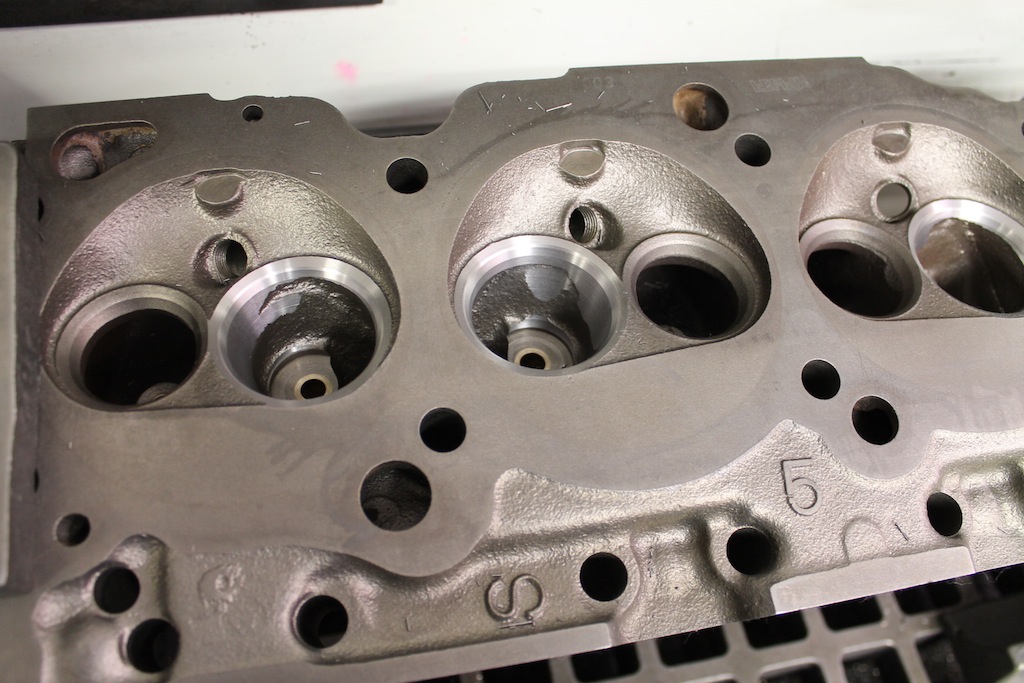

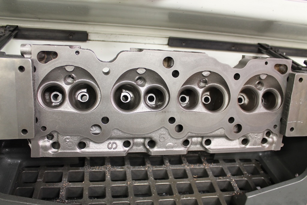

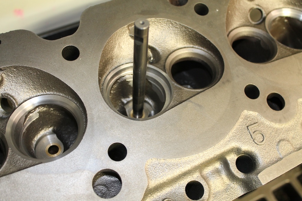

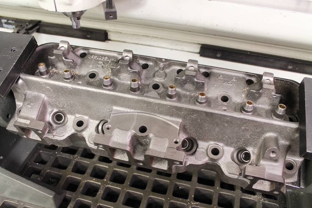

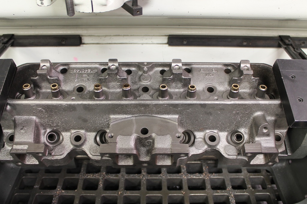

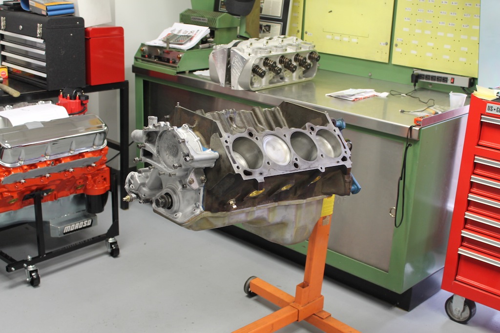

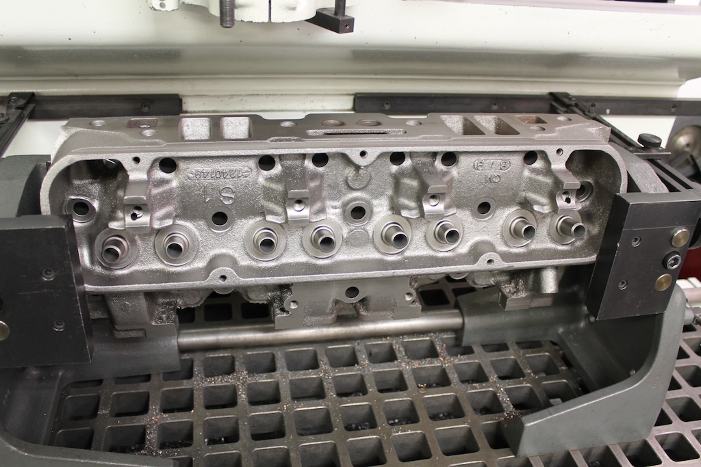

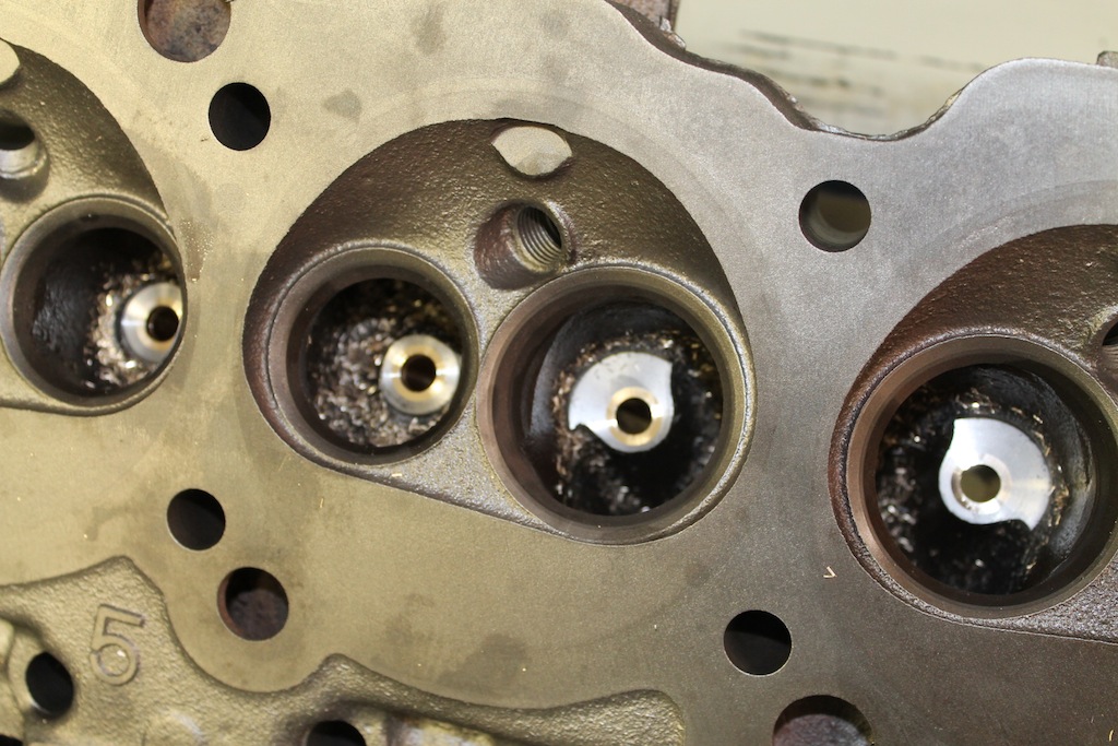

I was able to get my short block back together, she a rough old girl. 3.912 stroke with a 4.342 bore, 10.69 compression. After finalizing my head design I started on the valve guides, I also ordered some seats if they are needed.

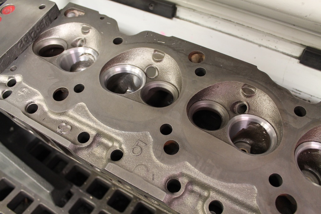

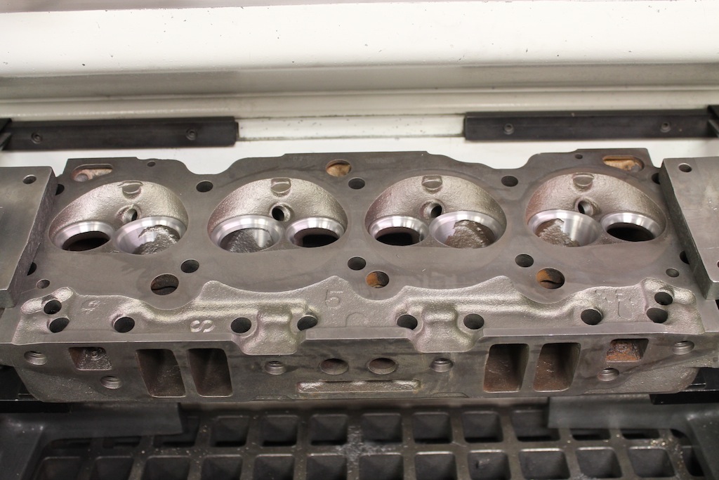

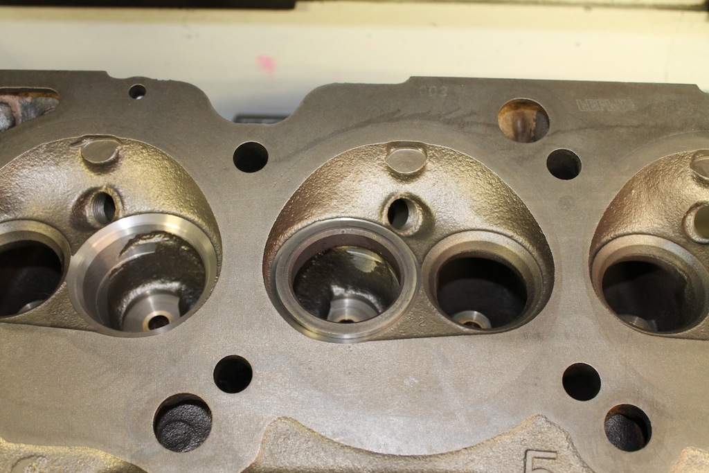

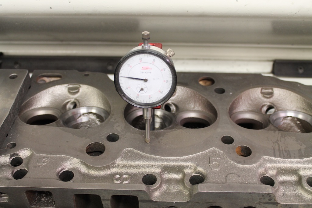

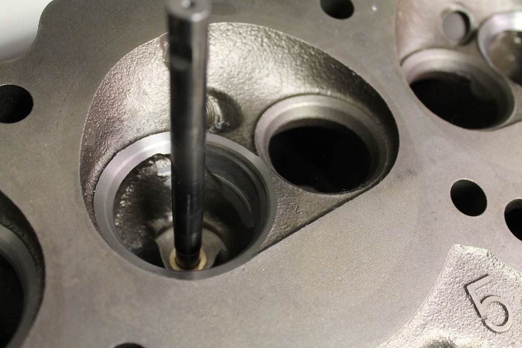

I proceeded with the valve job, and of course after setting my valve depths there was one problem child, a seat that would not come in at the proper height after replacing all the guides, good thing I had seats made to fix this potential problem. I installed a intake seat, problem fixed. Valve job is done, CCs will be set at 59.5.

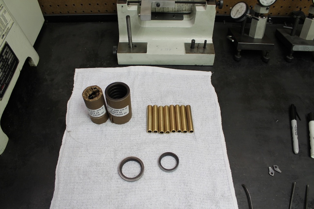

Thanks for the nice comments. Lets talk about valve guides and valve jobs. These particular heads utilize bronze knock in guides, the guides are bought with the ID .370 (undersize) the guides are installed which distorts the ID, I then cut a carbon relief slot in the bottom of the exhaust guide with a .450 reamer .125 deep. I use carbide core drills (similiar to a K Line core drill) which I had made, the guide is drilled to .3715 making it strait and round, the guide is then honed to final size with a Sunnen hone with Sunnen hone oil. You now have a perfectly round and strait guide, which allows you to cut a perfect seat. A perfect contact patch on the seat allows you to transfer the heat in the valve to the valve seat.
Rich.....I know you like this stuff, ck out this link
http://www.chevelles.com/forums/13-p...-pictures.html
Look closely at the valve contact patch (lap lines)
