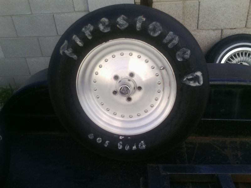

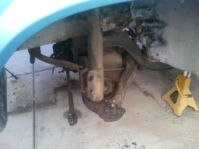

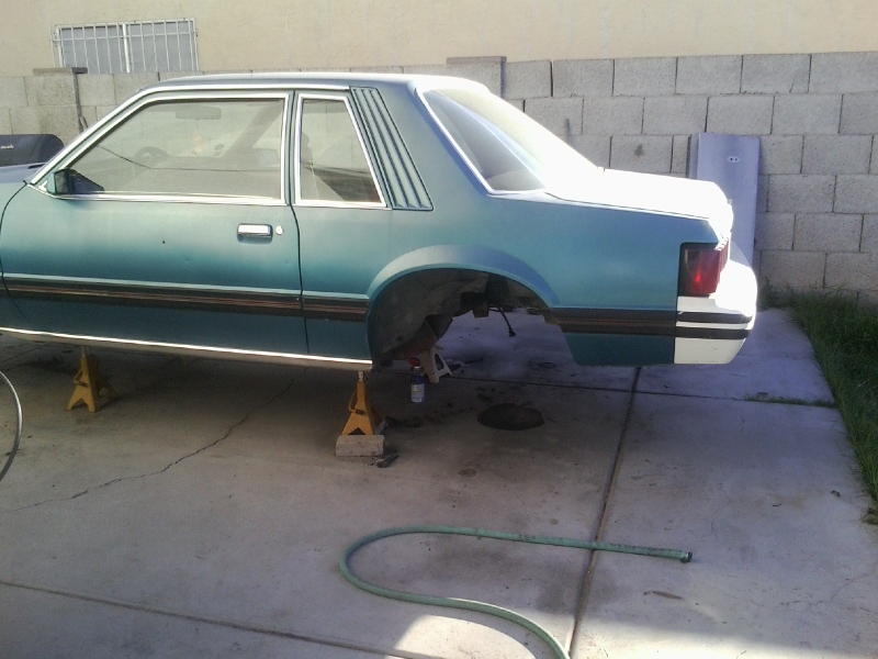

I'm finally getting some work done. Rear end out, cleaning up the sheet metal. Pulling the front end apart. Nasty greasy mess. Got a great deal on the rims. I cant remember the last time I saw Firestone Drag 500 tires. I like the old school rims.
