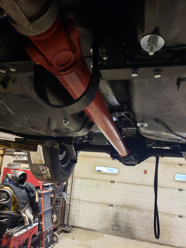

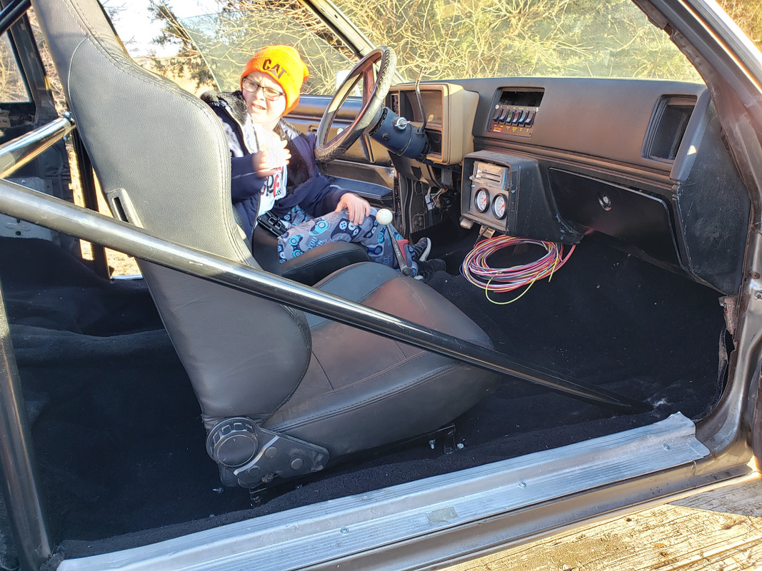

We have made slight progress with a new driveshaft loop and driveshaft.
We have completed the brakes and they are bled, working well. Next, was the interior where we have completed the carpet, seat mounting, and seat belts. The switch panel is just sitting in there and not the final destination.

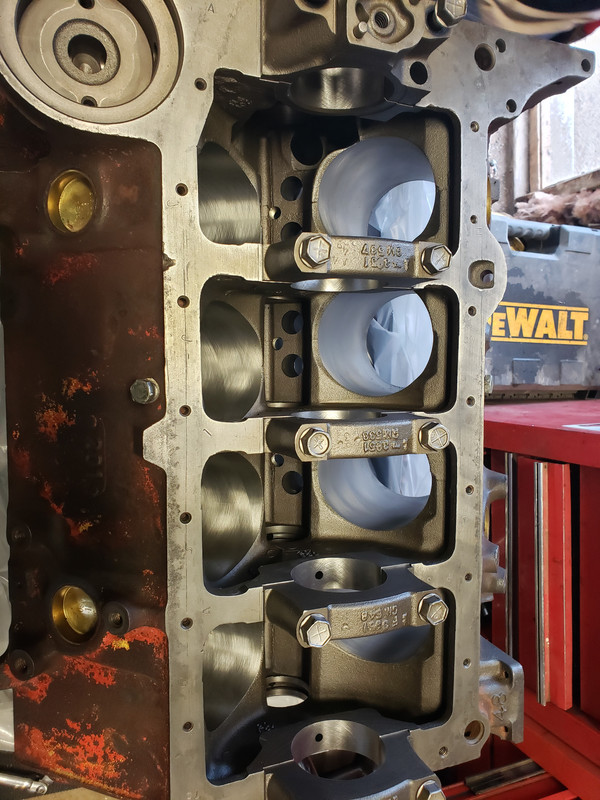

Lastly, We have finally received our block back and now can start assembling!!!

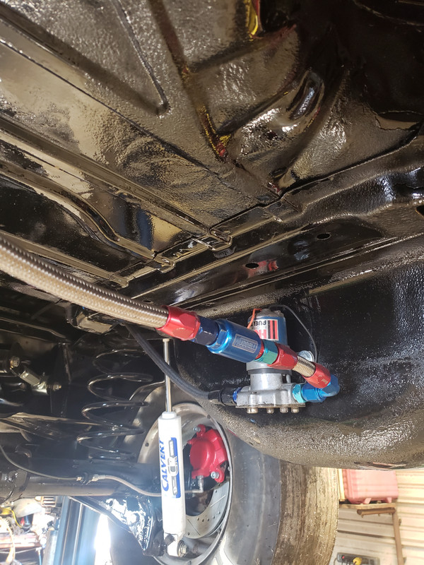

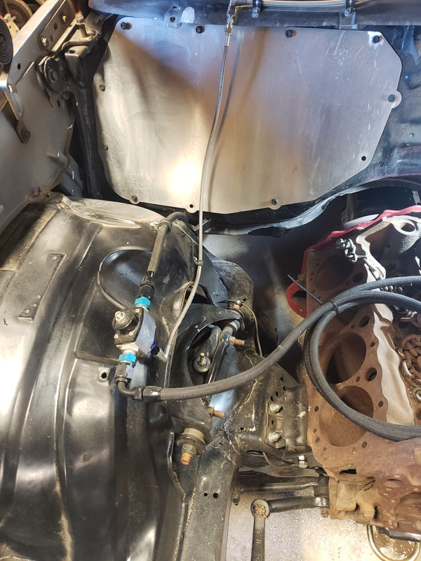

Fuel line, pump, regulator mounted. Whats everyone use for a quick "tap" for fuel checks?

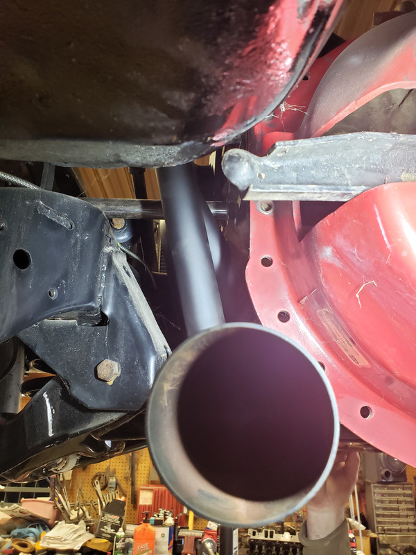

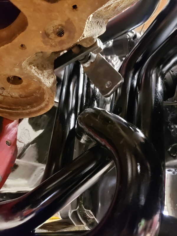

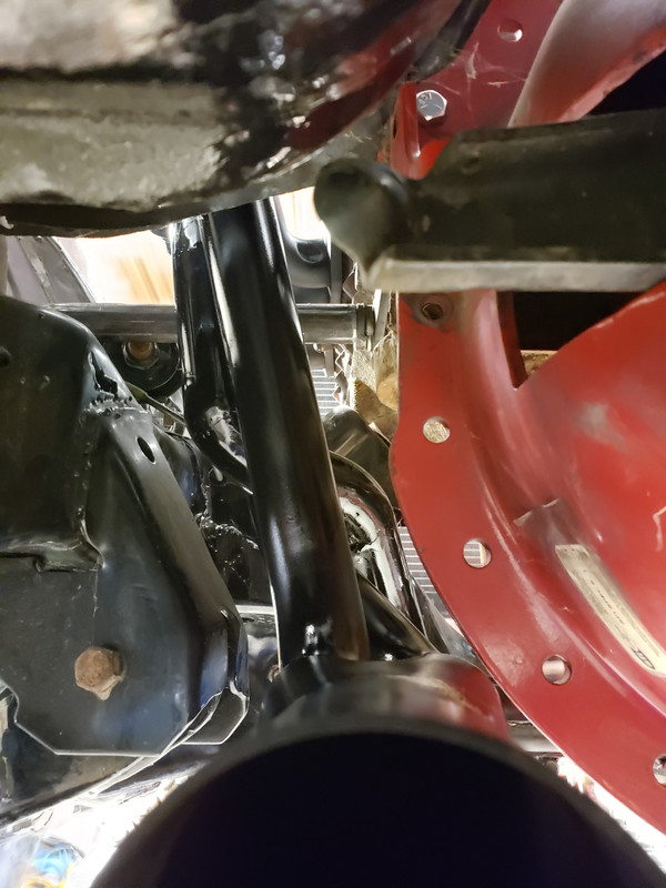

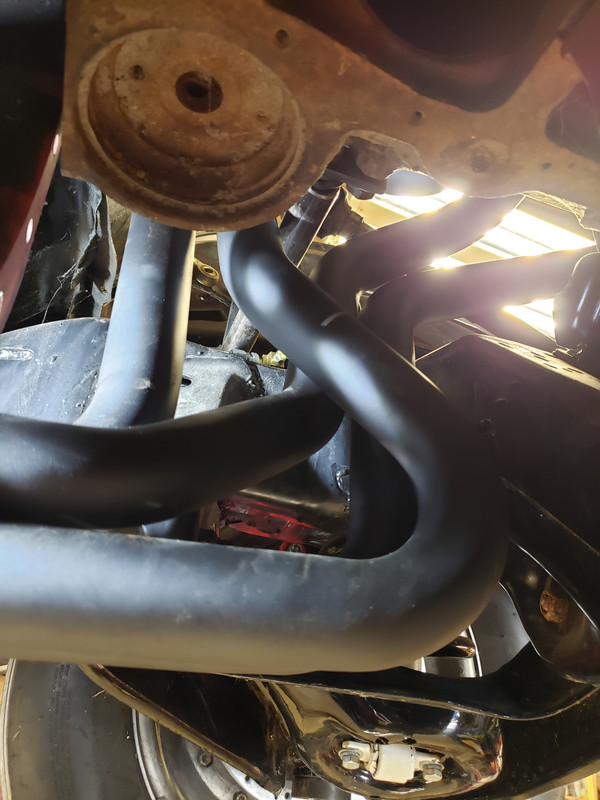

Something we've been scratching our head on is the clutch linkage and finding the right headers. We end up just buying a set and rerouting the #5 hole to give us clearance. Here is the before pics.
J518 is offline   Reply With Quote

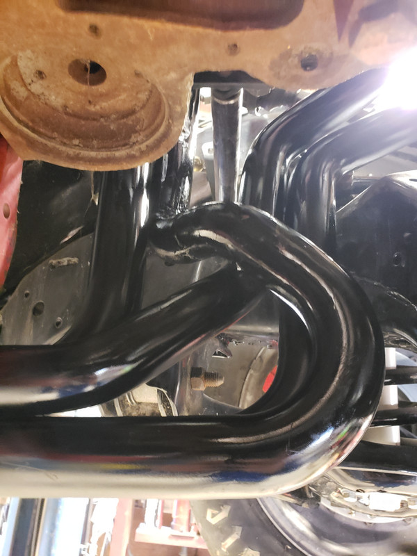

And the after...

Update on the rest.
We did get our crank balanced. We also bought a set of Total Seal rings $$$$
Intake acid dipped and painted.
Waiting for bearings to start assembling.
We cleaned up and painted the instrument cluster and bezel around it.
Settled on the switch panel location so we started wiring. So far I am really happy with how the wiring is going and the routing to the glove box.
Tach mounted.
Fuel pressure gauge mounted.
Clutch and flywheel arrived.
Should really see some movement now if we can start assembling the short block!

Maybe I am just used to the old Holley fuel pressure regulators, but that appears to be plumbed wrong. On my Holley reg, the higher pressure feed goes to the bottom, where you gauge is plumbed, and the side ports are reduced by the adjusting screw. Seems odd that you couldn`t find headers to work with the factory clutch linkage, as I have seen several stick G body GMs with a 4 speed and headers, but at least you could make those work.
