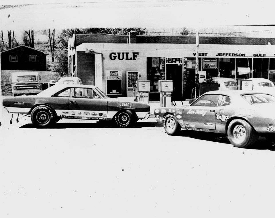

Looking for some. Found this shot of the Dart in the background:
http://classracer.com/classforum/att...4&d=1448837382
https://www.forcbodiesonly.com/mopar...age-jpg.64401/

Was this the Max Hurley Dart in the above pictures? Or was there another one?

Max had more that one Dart. Not sure what one was Eddie's. He must have repainted the one he got from Eddie Burl as soon as he took delivery.
