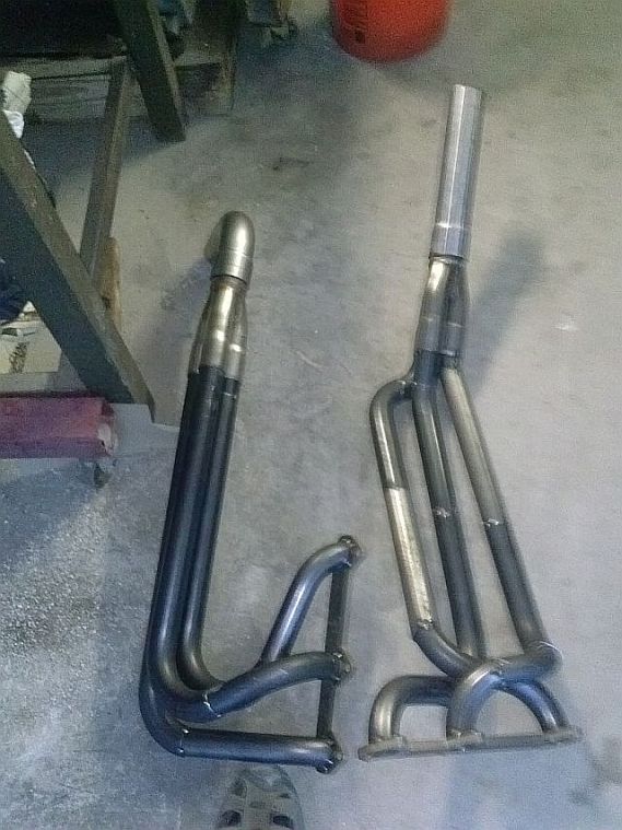

https://i.postimg.cc/PrpnqxbC/CAM00579.jpg

Mark, do you think those primaries are long enough?
Mark Yacavone 03-09-2022 05:50 PM
Re: Some "Dime Rockets" for the 4TH!
Yup.. The length was dictated by the need to get it out the front header well.
The rear was just a match, dimensionally.
I guess it didn't hurt it .It run 1.05 under on the first full pass ;-)
