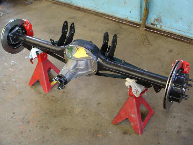

Originally Posted by Jack McCarthy (Post 36879)
questions aubrey...
what did you do with the 2 piece driveshaft ??... Designed and built my own modified version.
two upper links mounted at what position and hieght??... 2 1/2" higher than the stock mount on top of housing.
