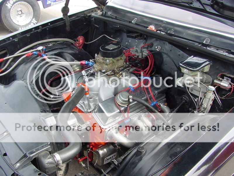

Paul Merolla 11-02-2008 09:22 AM
Re: quadrajet plumbing question
1 Attachment(s)
Originally Posted by Danny Ashley (Post 90083)
If you want to see how the quickest Quadrajet equipped Super Stocker on the planet plumbs his, check out Don Kennedy's thread----Let it all hang out in Vegas GT/AA page 6. Definitely works for them! Congratulations to Frank and Phil on your Shoot-Out win! Danny
You lost me, Danny. That looks nothing like what you're describing.....:confused:
Danny Ashley 11-02-2008 10:27 AM
Paul- One thing I've learned in the Q-Jet business is that everyone's car is different and some things are not set in stone. I still believe the system I described is ideal because the y-block set-up acts as a reservior for more available fuel to the carb., and mounting the regulator in front of the carburetor allows inertia to work for you pushing the fuel into the carb. I know that Phil is really high on the brand of fuel system they run and that may have something to do why their system works as well as it does. Maybe someone else's pump and regulator wouldn't work with this plumbing arrangement. You must understand that needle & seat size, bowl volume, line size, and fuel pressure all contribute to an effecient fuel system. Obviously, Phil and Frank have everything working together to perfection. Hope this helps. Danny
Mike Voth 11-02-2008 11:10 AM
Originally Posted by Danny Ashley (Post 90029)
The regulator location and plumbing that Mr. Roth has on his car is, in my opinion, the best way to feed a side outlet Quadrajet (assuming that is what he uses).
That's what we use. We haven't been able to get the front inlet q-jet to run as good as the side inlet q-jet, for what ever reason.
http://i382.photobucket.com/albums/o...neyNeb_008.jpg
