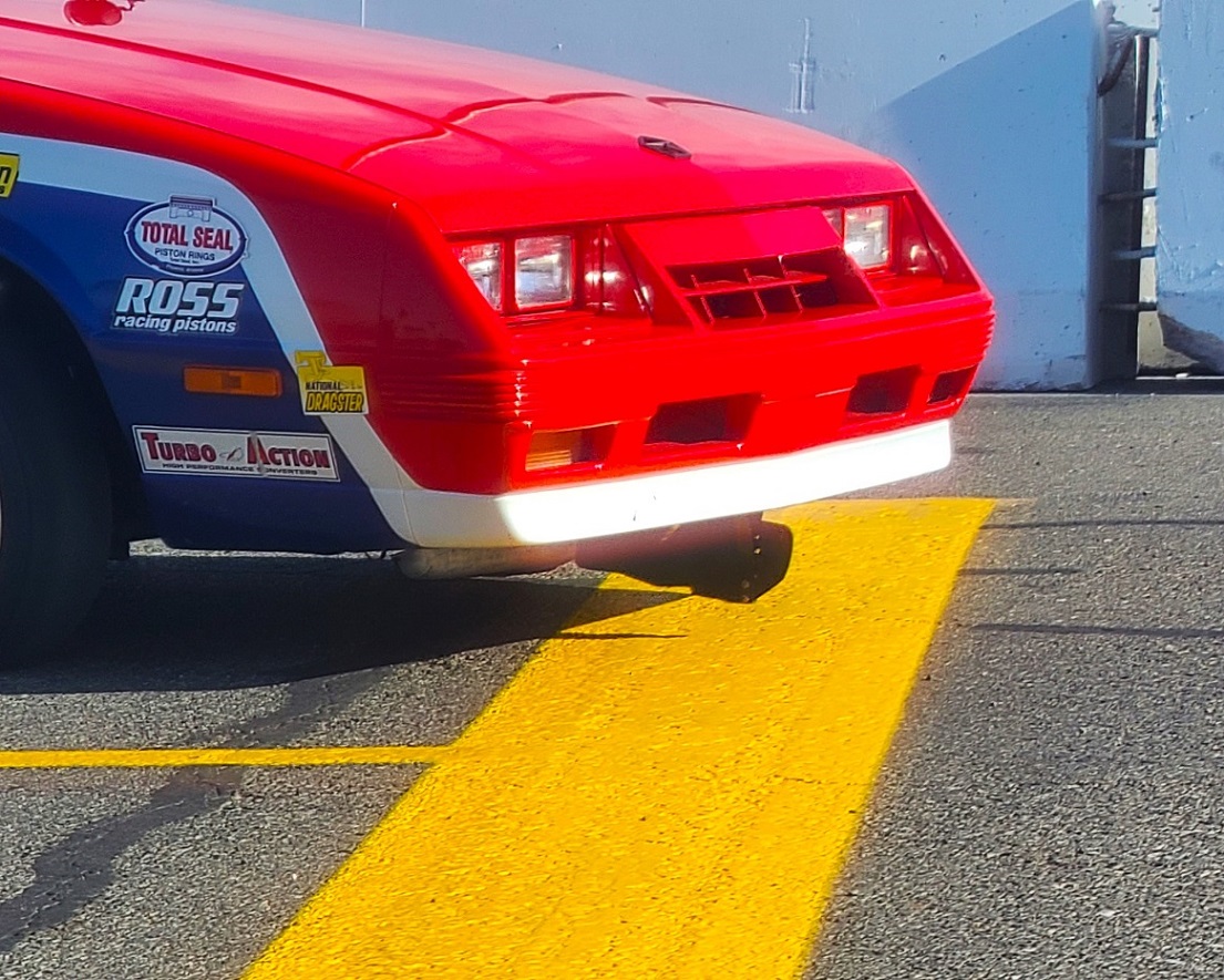

This is a request for rules clarification regarding "Beam Breakers" in Stock & Super Stock.
  1. Are non-original beam breaking equipment/devices allowed?
  2. Are there any restrictions regarding mounting of original, custom, or aftermarket devices in the frontal area beneath the body or framework forward of the front wheels?
Here is a picture of a part that has been a subject of recent discussion on this topic
https://classracer.com/classforum/at...1&d=1745861659
Thank you,
Jim Grossi SS7856

Looks legal to me according to the rules. The Finnish line I believe is 12 inches above the racing surface. The stripe taker needs to be at that height at speed.

Don't like it, not one bit!!!

I believe the rule book does state this clearly, I was told once that the rule book states only what yo can do and all else is not permitted. The bold text in the general reg identifies the ruling. Under general reg 4:5 GROUND CLEARANCE A-Arm Upright 4:4 Minimum 3 inches from front of car to 12 inches behind centerline of front axle; 2 inches for remainder of car, except oil pan and exhaust headers where permitted. When permitted under Class Requirements, devices used for anti-rotation purposes (i.e., wheelie bars) are exempt from the 2-inch clearance rule. Unless otherwise permitted by Class Requirements, the installation of a ?beam breaker? in front of the body is restricted to extending no farther forward than the body or bumper and must also satisfy the 3-inch ground-clearance requirement.
In the stock section of the rule book:
BODY Alterations or customizing prohibited; extent of customizing is limited to paint only. Convertible-top cars must run with top up. Sedan delivery, Ranchero, El Camino, etc. (if found properly classified in the Classification Guide) are eligible only if all class requirements are met. Raising and/or lowering front or rear of cars prohibited. Cars must retain level attitude at standstill, except those that have a forward rake (a permitted modification). Bottom of rocker panel cannot be higher than centerline of rear axle. Body mount insulators may be replaced with solid mounts of same size. Aluminum or other lightweight material may not be used to replace heavier items on car. In front-wheel-drive vehicles, air dams and spoilers that were available through the manufacturer are permitted front and rear. This is pretty clear that it is not legal.

Respectfully, this shows the inconsistencies of tech nowadays. Years ago Danny Gracia made me remove my OEM duck bill from the front bumper on my Daytona stating it was too low. Mind you, Wes Leopold had been wheeling the car like that for 20+ years.
Per the Stock Eliminator section of the rulebook "BODY: Alterations or customizing prohibited; extent of customizing is limited to paint only."

...The Finnish line I believe is 12 inches above the racing surface...
For what it's worth.
Standard timing equipment beam placement
  • Height of staging beams approximately 1 9/16"
  • Height of 60" beam - 10"
  • Height of interval time beams, speed trap beams, and ET stop beam - all 5"

Because Lonnie and Pat were approached about it while in Vegas and it was deemed LEGAL according to them....

This is not legal. It is altered body work. It also appears to have less than three inches of ground clearance which the the rule book clearly states

The general rules specifically allow a beam breaker in any class. It even spells out the size, positioning and heights. The rule in Super stock does not have any mention of a beam breaker in that section of the rule book. So that is open to interpretation. We need a clarification from NHRA tech for stock and super stock.

It?s always fun to race y?all. As the rules are written I think the stripe taker is legal. If we race and y?all have one I have no complaints on the within the rules part. In my opinion the Candies teams play by the rules.

Worst part of this whole deal is I can't even make a useful one for my combo. To get a stripe catcher to work on my car would be almost impossible. The difference in the front of my car from ride height to full extension is so large, that I'd never be able to get one that always caught the beam whether I'm in the gas or not. To get it low enough to trip the 5 inch tall finish line beam, it would have to be on the ground all the rest of the time. I'll get in the shop and see what I can fab up just for the sake of a new project, but looks like I won't be running one legal or not.

This is legal WtF.
This ain?t bracket racing or street outlaws
If you want this, you need to buy a third generation or fourth generation, Camaro or Firebird
And hit the brakes real hard
I mean, the poor guys only got four cylinders. Go get four more spark plugs.
IF MY COMPITION HAS THIS IM TRASHING IT IN THE STAGING LANES
TRY ME PLEASE

They are ILLEGAL!

https://i.imgur.com/wExeJt1.png

JeremyDuncan 05-12-2025 07:23 PM
Re: ATTN SRAC members- Beam Breakers in STK & SS - Legal or
https://www.nhraracer.com/content/ge...206&zoneid=132
Beam breakers now officially illegal in Stock and SS.

Wow , Common Sense prevails again …..D-7 tech could have handled this at the Vegas double BUT chose not to …..

I agree. I grow weary of the comment used to justify this stuff. You know the one, we are bracket racers.
There is nothing wrong with a dedicated bracket car.
However, there is a difference between stock and Superstock cars that are racing in a modified bracket program and cars that have no baseline rules other than safety regulations.
I am thankful that the NHRA officials did listen and act here.

Why would they do that, they were prohibited after the Vegas double. ;)

. Actually, I have raced stock since 1977 AND I firmly believe they have always been illegal in Stock/Superstock . The fact that there is no Pre Race tech AND the fact that many racers like to PUSH the envelope DOES NOT mean Beam Breakers were Legal in Stock/Superstock …..I reiterate that this is MY OPINION …..

I hate to age myself, but when we had a group of dedicated tech people
they would have given you 5 minutes to get that crap off your car, or option
B) take all your stuff back to the house. We don't have room for illegal
stuff here. Today, nobody has any horsepower to make a decision, they
don't want to not let the person race for fear of repercussion, so they
go to the poor division director, who was recently hired because he ran
a good no-prep program for ABC sanctioning group, was given no training
on S/SS, doesn't have an empowered Tech person, Wesley won't answer
the phone, LOL, so they have to have meetings, get opinions, get options,
talk to legal, and then it filters down to us. Its called progress. ???
