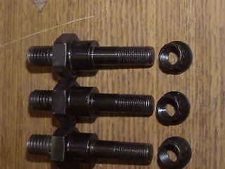

without a girdle and spring pressure I run they flex to much...this is what I want to use
the 42/46 lifter angle matches the heads better than inline lifters...the valvetrain geo isn't even close to where it needs to be, its the only way to get these canted valve motors to run up top....I don't see where it says I can't do it
